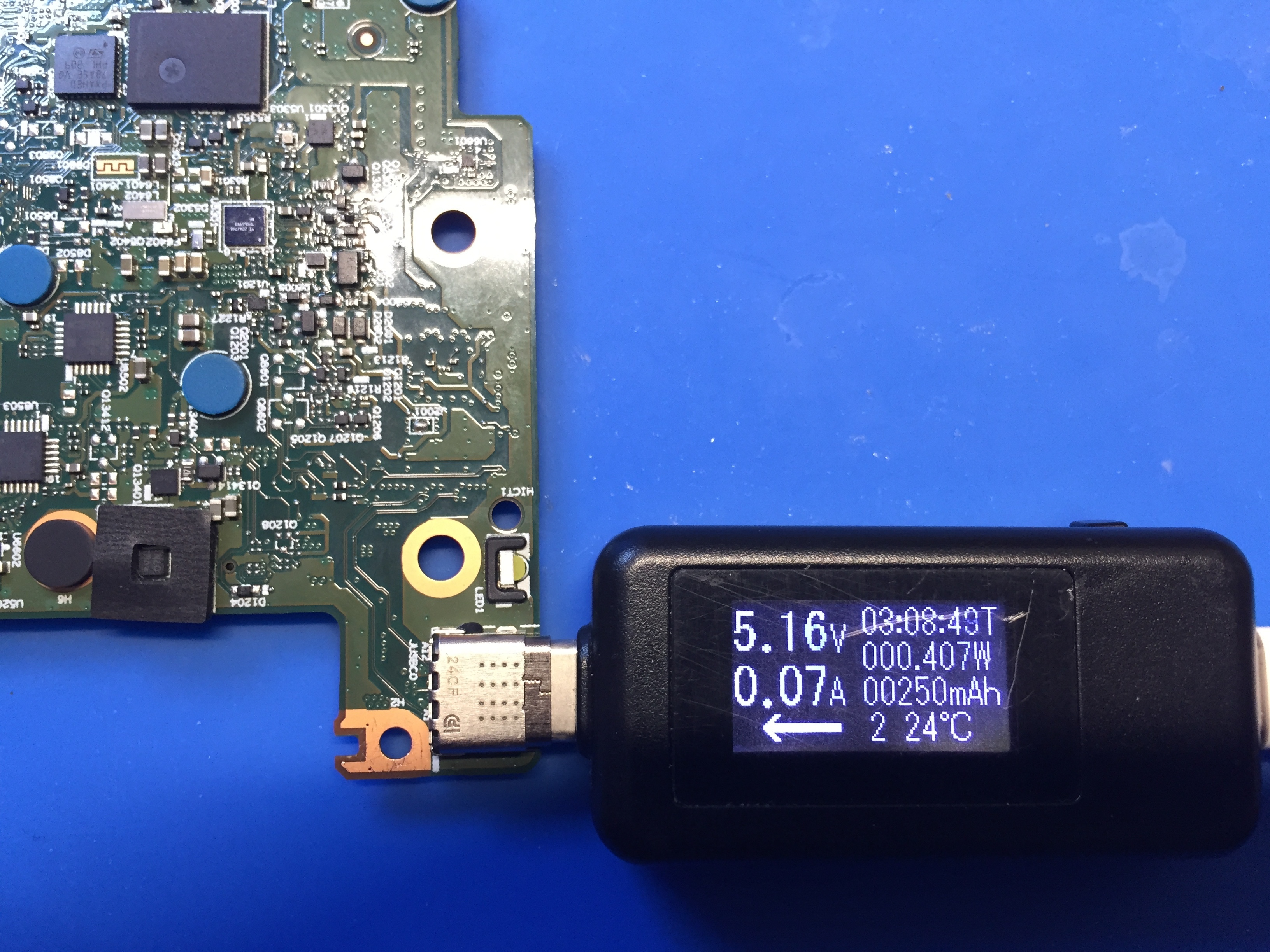

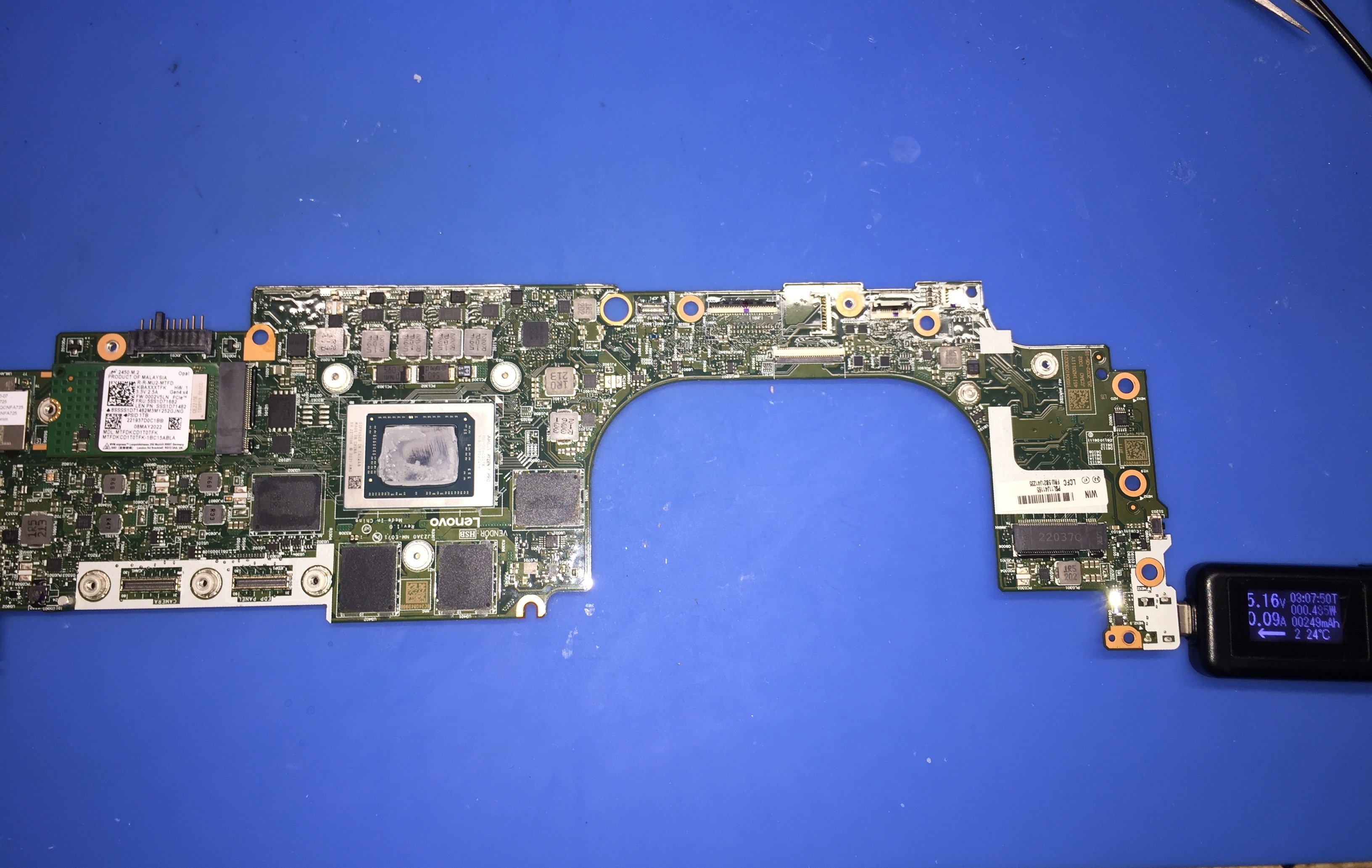

    Lenovo ThinkPad Z13 JZ3A0 NM-E071 Rev.1 no power, usb-c stuck at 5 volts
    Looking for help.
    I have a Lenovo ThinkPad Z13 JZ3A0 NM-E071 Rev.1, charging stuck at 5 volts / 0.09A.
    According to the customer, he tried to replace the battery himself, and this is what happened.
    I suspect that one of the two USB-C controllers (U5401 OR 5301) has failed.
    Can anyone confirm that?
    Presented voltages on a board:
    (measured on coils)
    PL1901 - 3.3v,
    PL0501 - 3.3v
    PL0202 - 5.14v
    PL1601 - 1.8v
    PL1401 - 0.75v
    Any help appreciated.
