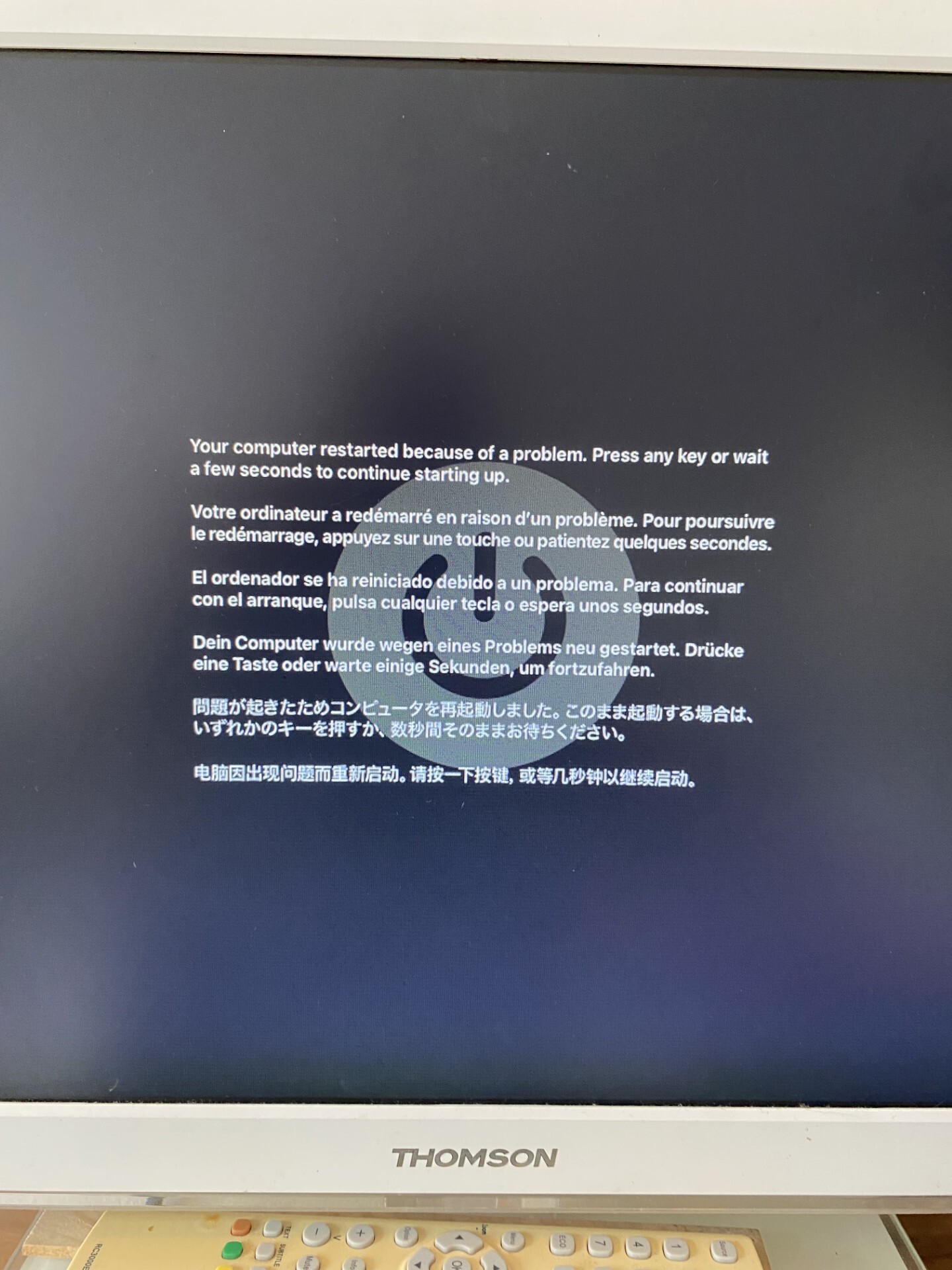

    Measure the same on the working board.
    • No Lan
      • Apr 2025
      • 15
      • FRANCE
      Yes I have approximatively thé same (210) on thé working One
      • No Lan
        • Apr 2025
        • 15
        • FRANCE
        I add antother things that i just discovered.
        I tried a test using an external screen connected via HDMI.
        • If everything is connected (trackpad, display, and SSD) + HDMI plugged in → crash + boot loop (sometimes I reach the login screen, sometimes not)
        • If only the trackpad is disconnected + HDMI plugged in → crash + boot loop (sometimes I reach the login screen, sometimes not) + see image
        • If only the internal display is disconnected + HDMI plugged in → no problem, fast and stable boot
        If i disconnect the HDMI
        If everything is connected (trackpad, display, and SSD) --> BOOT LOOP
        If only the trackpad is disconnected --> BOOT OK (if i plug HDMI direct crash)
        • No Lan
          • Apr 2025
          • 15
          • FRANCE
          Nobody ?
          Can it be U7650 (buck converter) or U8210 (Fets) that convert PP5V_S4 to PP5V_S0.
          i say that because, i measured on time 8-9v on PP5V_S0 line that is not normal.
          Thaaaaanks
