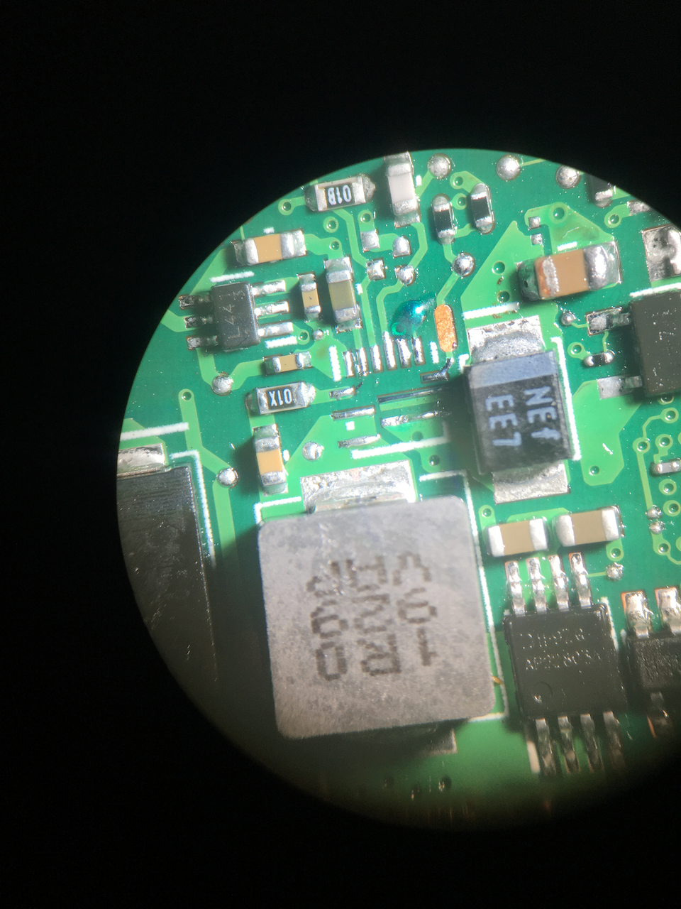

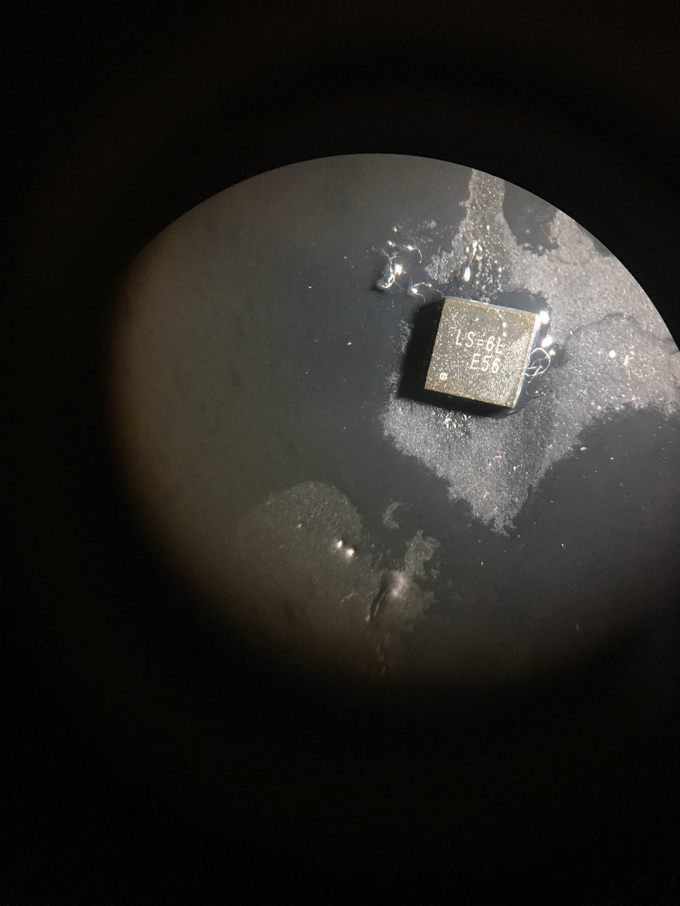

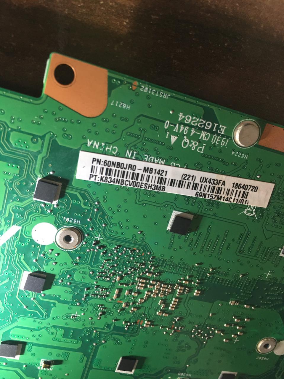

                                  Re: Richtek marking code
                                  hello, i need help. can't find the following chip anywhere... richtek LS=xx. it's a regulator for the CPU/PCH. thanks in advance
                                    • 21510
                                    Post a clear picture of it if you can .
                                    • rediii
                                      h???, spurrrn
                                      • Mar 2018
                                      • 497
                                      • somewhere in europe
                                      no problem, i hope this helps
                                        • 21510
                                        I think the package type is UQFN3x3-12H(FC) .LS isn`t on any of the richtek lists,and i checked every UQFN3x3-12H datasheet listed in the Richtek product selection guide Oct 2020 and its not there either. I did find a part that has an L8 marking code - RT6256BGQUF .My best guess is LS is a custom part,or the marking isn`t complete,it does seem to curl back under a bit at the top of the S. Not sure .
