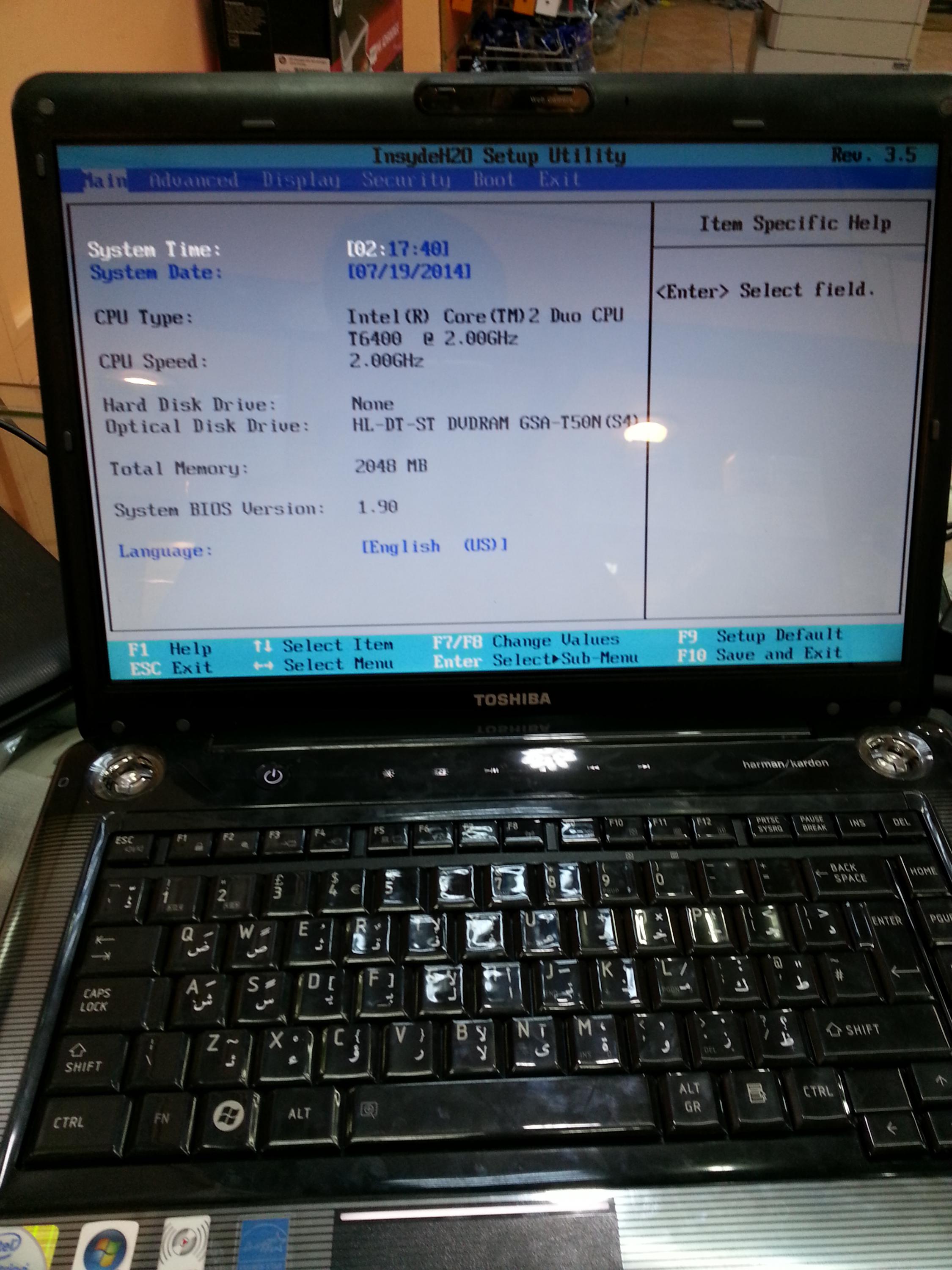

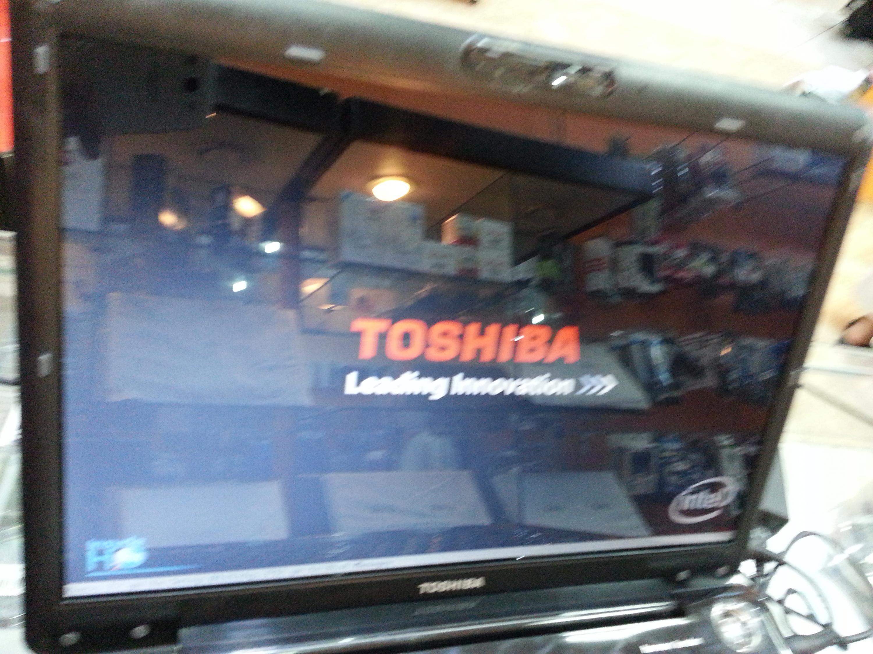

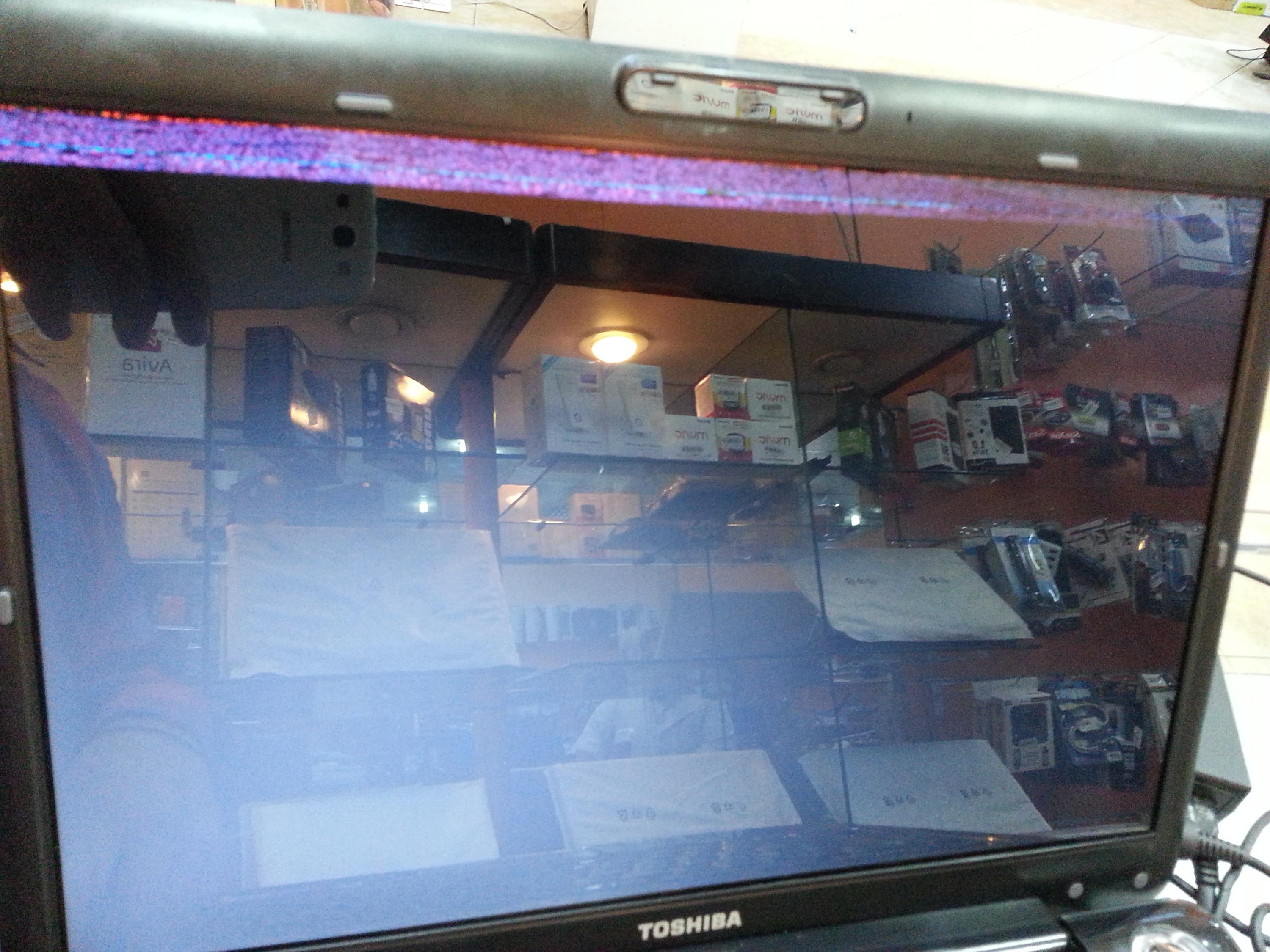

    hi friends
    i need some help yesterday i got a laptop Toshiba satellite a300 with display problem
    Toshiba logo coming and also display working fine in bios setup .
    but when exit from bios setup display still with some different colors
    you can see in pictures
    should i flash bios ?

    If its freezing, Its likely to be the common nec/tokin capacitor cause.

      very known issue of IGP, reflow it or reball it, but it can be even bad lcd cable

          Tokin fault, this is what a CPU with not enough power looks like.

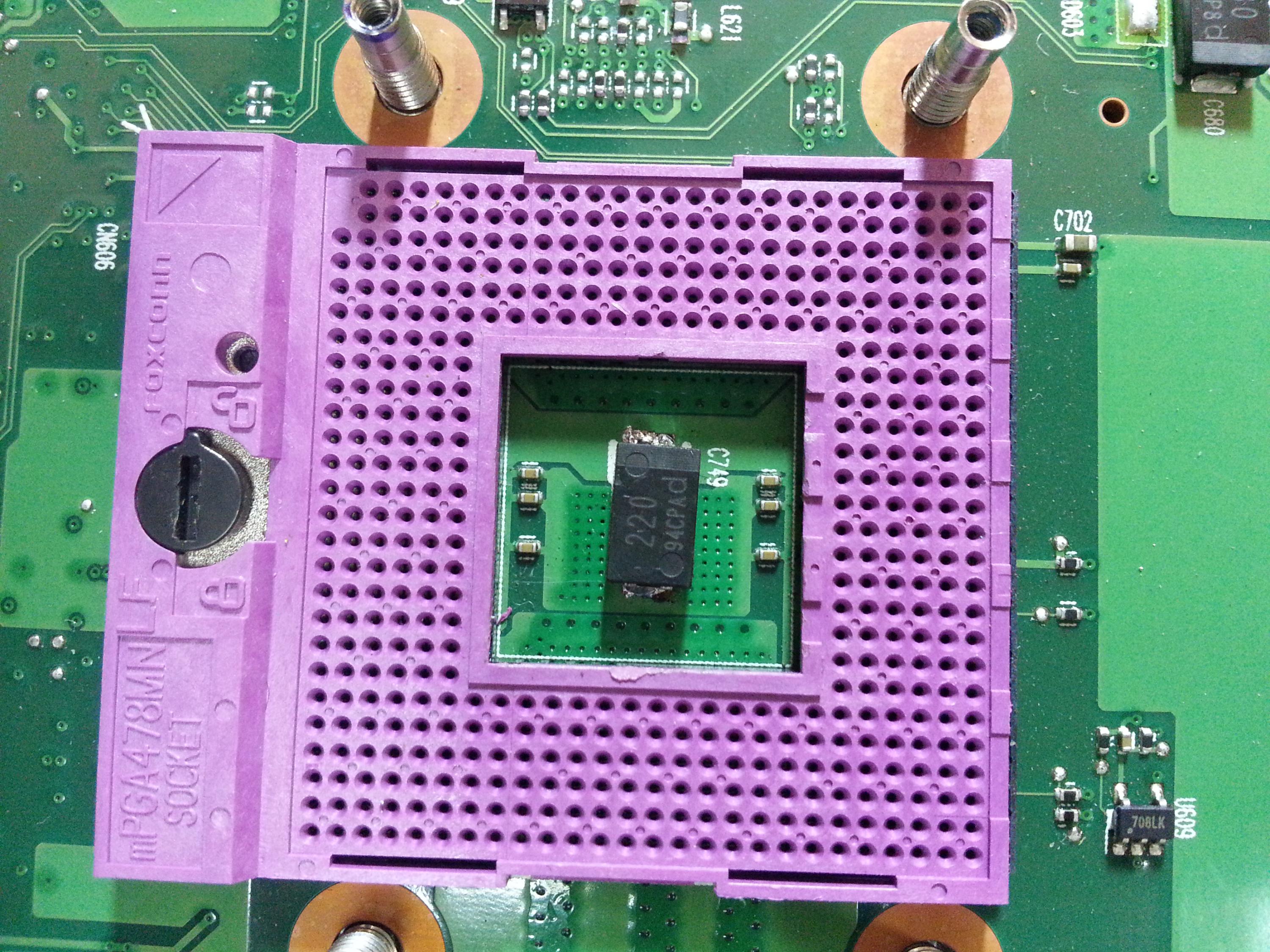

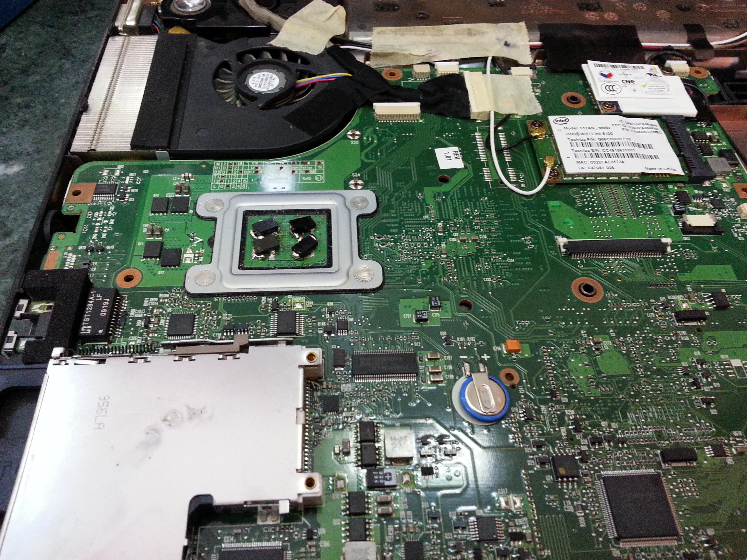

            Re: Toshiba Satellite A300 display
            thanks all of you for help
            vga cable and lcd are ok i am sure 100%
            i replace the Nec tokin capacitor with 4x 330uf
            but problem still same

              Are you sure that all capacitors are soldered good?
              The laptop stucks or has just that line? On external monitor?
                thanks for reply
                i am sure that all capacitors are soldered good and also add 2 capacitors of 220uf
                laptop stuck after Toshiba logo . same conduction on external display i also reflow the IGP but nothing change . i am also sure its freezing problem .

                                    add more caps and check cpu vcore voltage.
                                        finally solve it .
                                        add 6x 330uf and 2x 470uf capacitors also change one capacitor inside CPU socket . now, if i press power button laptop start after 15 second and working good .delay 15 second in startup can create any problem in future
                                        or its ok ?
                                        i am so thank full all of you for help special sir Spidey,
