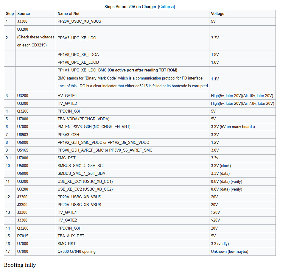

    Can you confirm that the LDO rails on each and every CD3215 is correct? If not, these power delivery controllers will never reach the 20v power delivery contract.
    See here and confirm for each CD3215:
    https://logi.wiki/index.php/CD3215_Bootup_Sequence

                    #29
                    From the suggestions in post #21 - what is the voltage to ground of:
                    PP1V1_UPC_XA_LDO_BMC
                    PP1V1_UPC_XB_LDO_BMC
                    This voltage should be present for only the active port. This voltage will be used to power the TBT ROM and then the contents of the TBT ROM must be OK to allow for the PD controllers to switch to the 20V.
                    Where in the flow chart of the article linked in post #21 is your failure?

                        #31
                        Keep going through the full list. Your case will have a similar logic flow.

                          #32
                          So I took some time to check the following:
                          PP20V_USBC_XB_VBUS = 5v present
                          PP3V3_UPC_XB_LDO = 3.3V present
                          PP1V8_UPC_XB_LDOA = 1.8v present
                          PP1V1_UPC_XB_LDO_BMC = 1.1v present for both CD3215
                          HV_GATE1 (unable to locate on the schematics)
                          HV_GATE2 (unable to locate on the schematics)
                          PPDCIN_G3H = 2.8v
                          TBA_VDDA = 4.4v
                          PM_EN_P3V3_G3H = 4.5v
                          PP3V3_G3H = 3.3v
                          PP1V2_S5_SMC_VDDC = 1.2v
                          PP3V0_S5_AVREF_SMC = 3v
                          SMC_RST = 0v
                          According to the boardview I have
                          SMBUS_SMC_4_G3H_SCL does not exist
                          SMBUS_SMC_4_G3H_SDA does not exist
                          SMBUS_SMC_4_G3_SCL = 3.3v
                          SMBUS_SMC_5_G3H_SCL = 3.3v
                          SMBUS_SMC_4_G3_SDA = 3.3v
                          SMBUS_SMC_5_G3H_SDA = 3.22v
                          USBC_XB_CC1 = Cycles between 0.5v up to 2v
                          USBC_XB_CC2 = Cycles between 0.5v up to 2v
                          PP20V_USBC_XB_VBUS = 0v
                          PPDCIN_G3H = 4.6v
                          TBA_AUX_DET = 1.1v
                          SMC_RST_L = Does not exist on my boardview
                          • mon2

                            #33
                            PPDCIN_G3H = 2.8v
                            PPDCIN_G3H = 4.6v
                            ?? Which is correct? Be sure the power adapter is the OEM original or suggest that it be at least 100W with a 100W rated USB cable to power this unit. Cannot use a mobile phone style low power USB-C adapter.
                            SMC_RST = 0v
                            SMC is stuck in the RESET parked state.

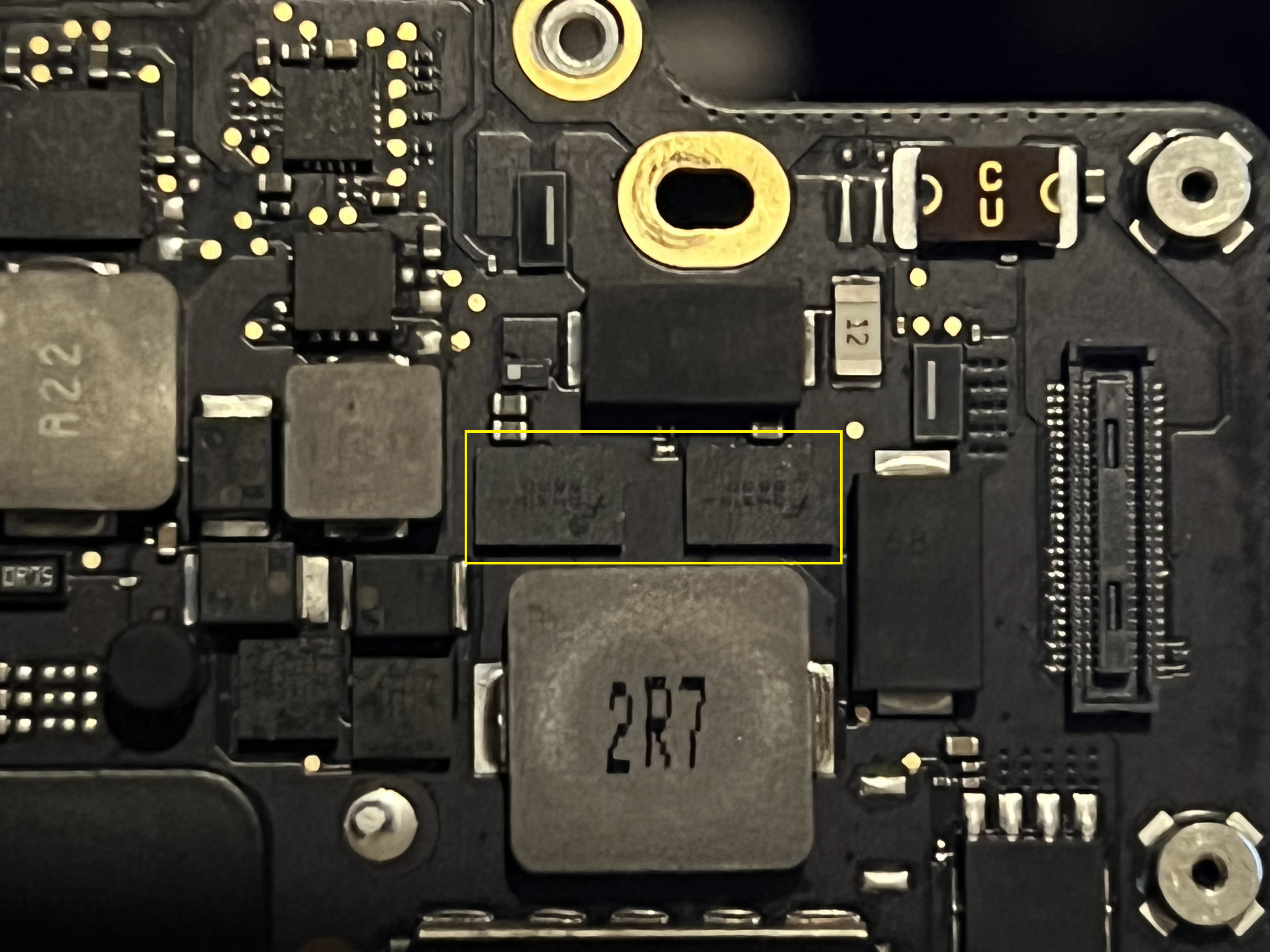

                                    Q7030 is a suspect. Note that there are 2 mosfets inside of this single package.
                                    Remove all power. Measure the resistance of the internal mosfets.
                                    source / drain
                                    source / gate
                                    gate / drain
                                    for each of the 2 mosfets inside this device. Repeat for Q7040. You may have leaky / defective mosfets here. Post each measurement.

                                      #38
                                      How do I do this? By removing from the board?
                                      • mon2
                                        • Dec 2019
                                        • 14724
                                        #39
                                        Review the boardview diagram and locate these 2 x mosfets. They may or may not be visible once you remove the backside lid. With no power to the board, perform the measurements on these mosfets. Some signals may be available on either side of the board - not sure. No power to the board during the resistance checks. If you do remove the logic board, follow a good YT video to keep track of each and every screw and cable. Take clear pics before starting the procedure. We use masking tape to place the screws near the hole from which it was removed. Makes it a lot easier to rebuild the unit. Just wrap the screw inside of the masking to tape so that it will not short circuit any part.
                                        • EpicFix
                                          • Aug 2024
                                          • 43
                                          • Trinidad & Tobago
                                          #40
                                          I've had the board out the entire time...... The have been located but they do not have any exposed pins to probe that's why I asked if they are to be removed for testing
