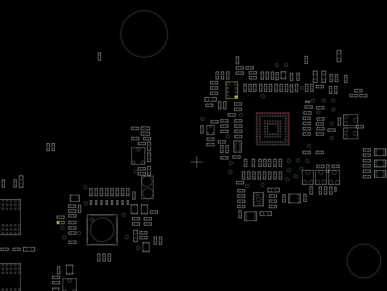

    If nobody has an idea why EC is not responding when try to program it, i order a new EC chip
    I have managed to read the EC and its firmware is good.
    I cannot see where is the communication lines between the two IT chips, can someone point me to the right direction, maybe its just a bad resistor.

      I have noticed that even when the laptop is turned off the PCH is getting warm (33 Celsius) and Board Power draw is 80 MilliAmps that is s lot for a laptop that is in OFF state.
      Any idea what should i check on PCH lines that could take such power?

        Communication between the to ITE is via smbdat/clk0.
        I understand that you programmed the 8171 with 56k dump, all that went fine? Read back also fine?
          I have read it and it was exactly the same as the 128k I wanted to write so no need.
          As for the 56k keyboard controller... I have tryed 6 different firmware and none of them worked.
          One of the firmwares is a universal gl50x that allready used on different modells before with success.

            Check the smb clk and data lines for communication when keys pressed, inspect visually. Liquid damage is not always easy to find.

              Never mind. I wanted to check if windows sees the keyboard contoller at all so i have started to install win 10.
              Durring the installation Laptop suddenly smelled funny and turned off.
              1VSUS now shorted to ground and PCH taking 600 MilliAmps. At least I was right that PCH is taking to much power even in off state.
              Lets see what happens after PCH replacement.
