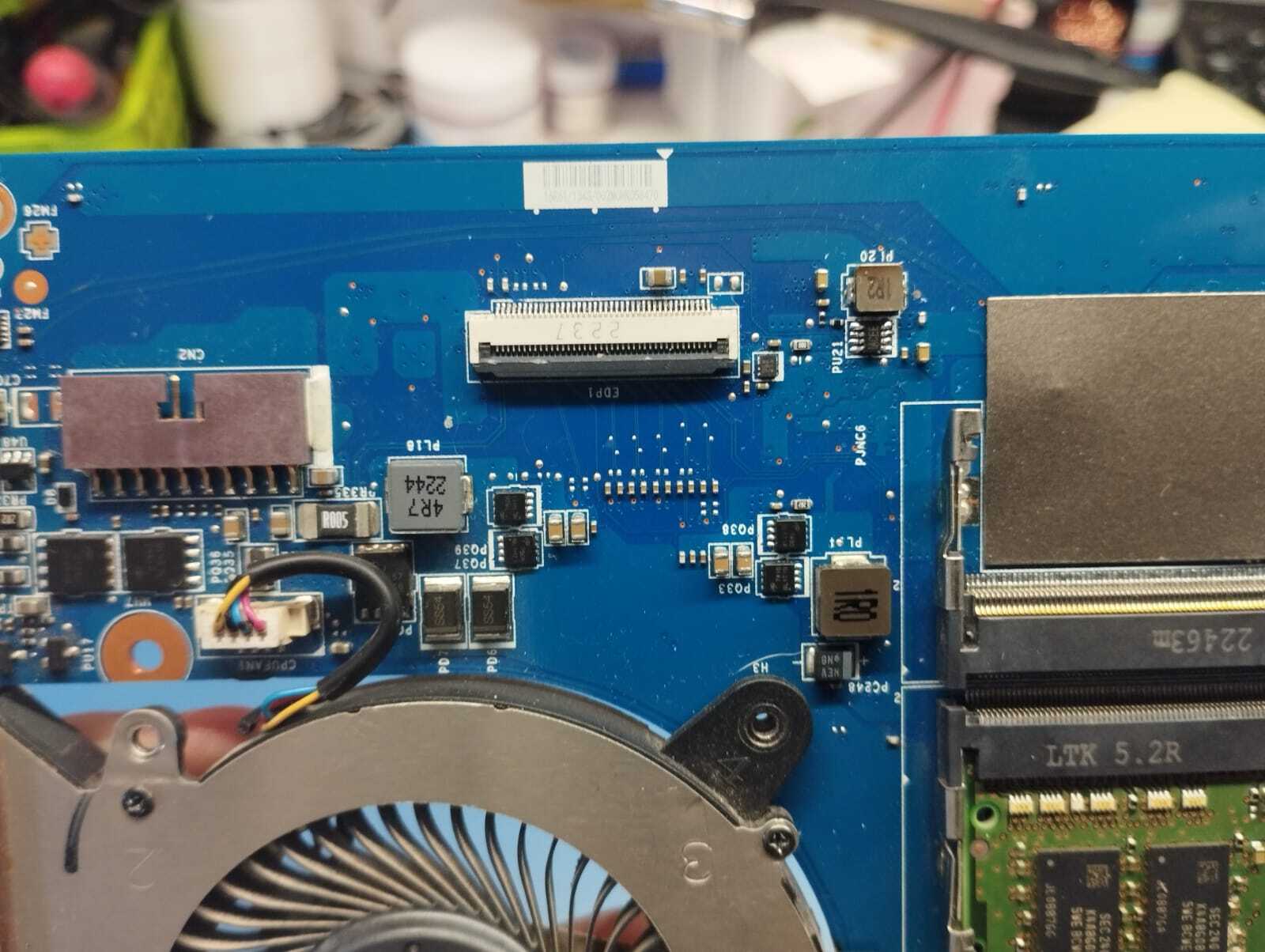

I have an MSI GF63 laptop with a MS-16W21 motherboard on my table, and there is no image on the LCD screen. However, when connected via HDMI, the image displays correctly.
Voltages on the EDP 40-pin connector pins:
3pin = 012V,
5pin = 1.75V,
6 pin = 5V,
7 PIN = 3.3V
32 PIN = 2.2V
33 - 36 PIN = 3.3V
38-40PIN - 19V
PU21 - MP2143
1 - 5V
2 - 5V
3 - 3.3V
4 - 0V
5 - 3.3V
6 - 0V
7 - 0.6V
8 - 3.3
Help me please
