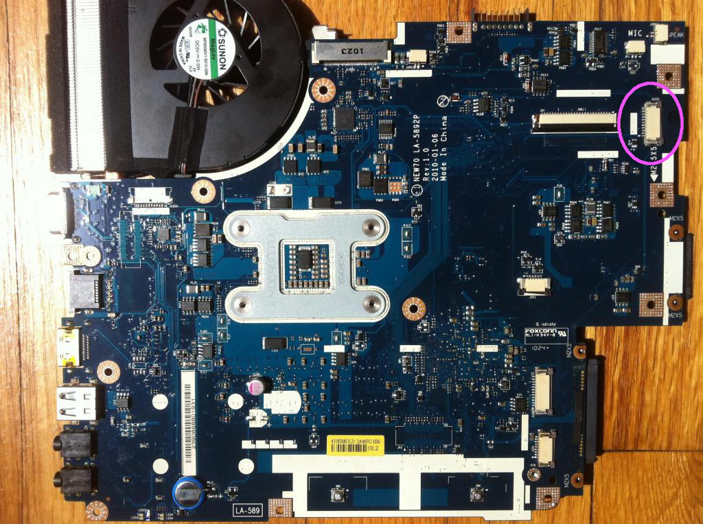

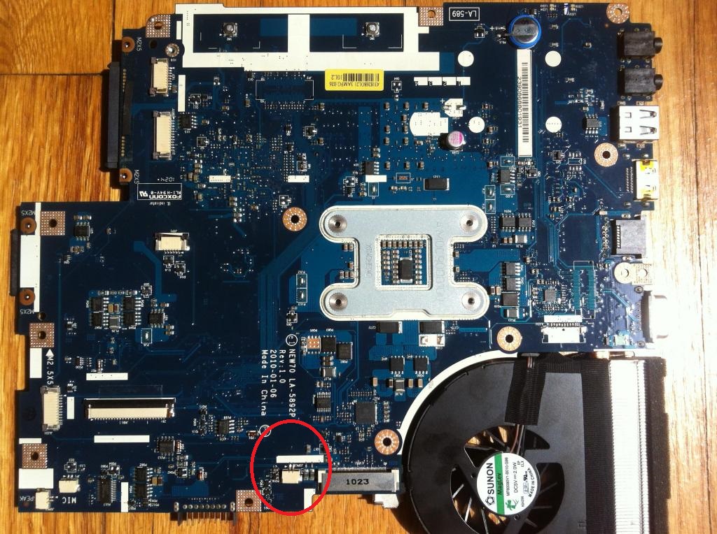

        can post pictures of both sides?
        • withalligators
          • Jun 2013
          • 267
          Re: Gateway (shudder) NV59C63u charges battery, blue LED when powered, then shuts dow
          Top
          Bottom
                  start the board without CPU.
                  in the circle I thing that's the power cable?
                  if its say Jpower or something like that? just short those pins to power.
                    No, that's one of the speaker connections. The power switch module is ten pins here.
                            This is a better pic than I can give you. See the big ten pin ribbon leaving the picture. That is going to the motherboard.
