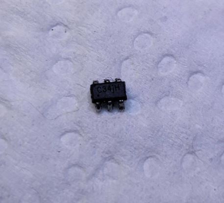

Help identify component of a asus laptop motherboard
  • rascao
    • Jul 2020
    • 51
    • EspaƱa
    Hello i have a asus motherboard with a component sot23-6 case with markings C34JH is shorting my 3.3v line i dont have schematics or boardview and i cant find any, the motherboard is a asus x415JA r2.0, searching on Google i found a Texas Instruments LMR14203 and the pin out is at least similar because the Vin and GROUND pins are the same position but it says is a 4.5v to 45v and is on the 3.3v line so i think is not the same, any help i will appreciate

    Re: Help identify component of a asus laptop motherboard
    SY8893L
    https://www.silergy.com/download/dow...type=datasheet
