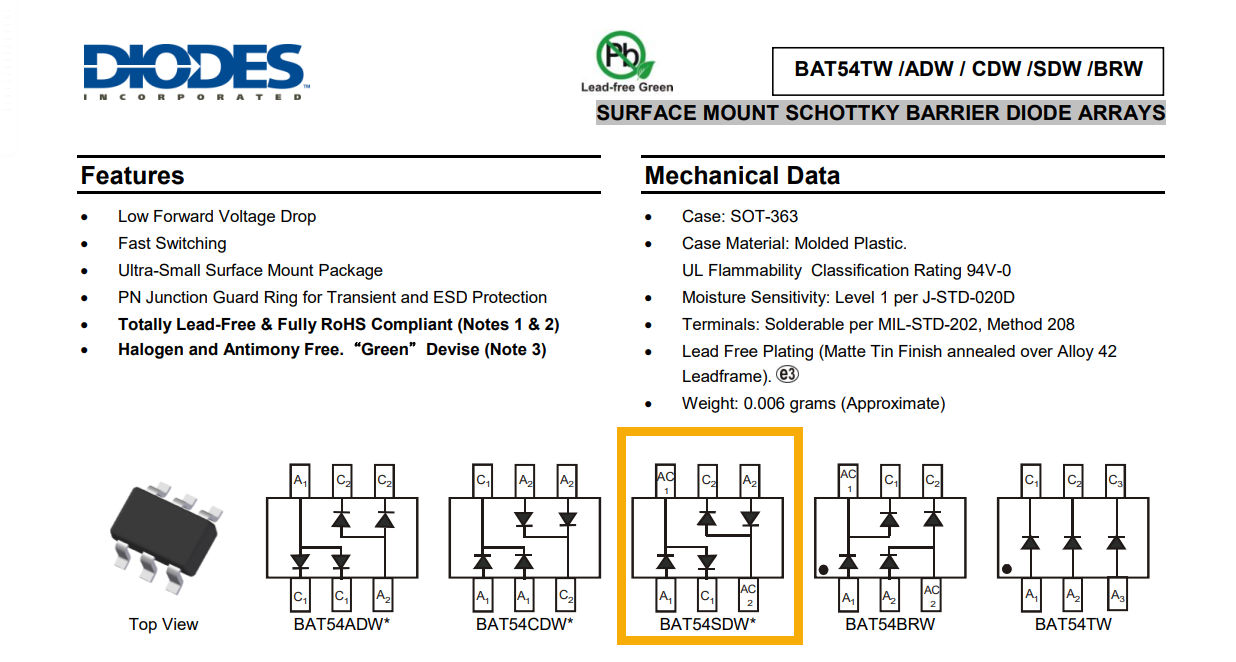

X455LJ REV 3.1 please identify this ic name
  • iamttnien
    • Aug 2023
    • 4
    • Vietnam
    It is missing from the board.

    Attached.

    • iamttnien
      • Aug 2023
      • 4
      • Vietnam
      Originally posted by mon2
      Attached.
      Thank you very much!
