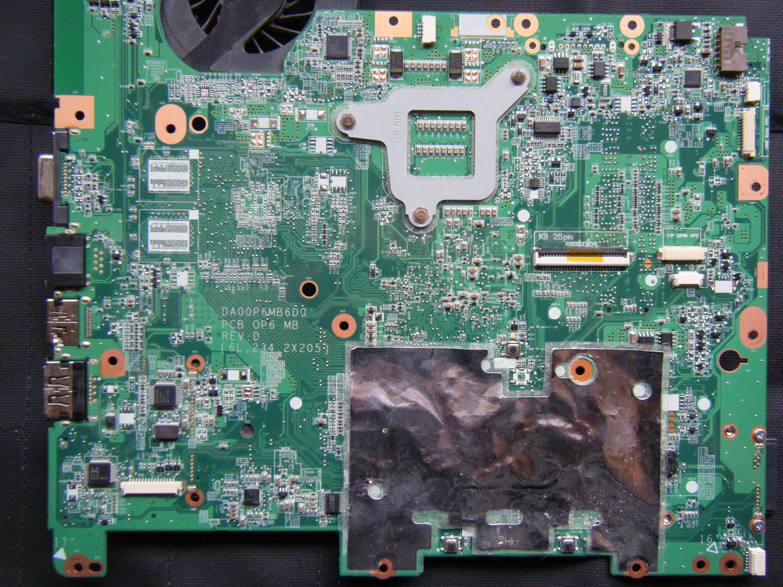

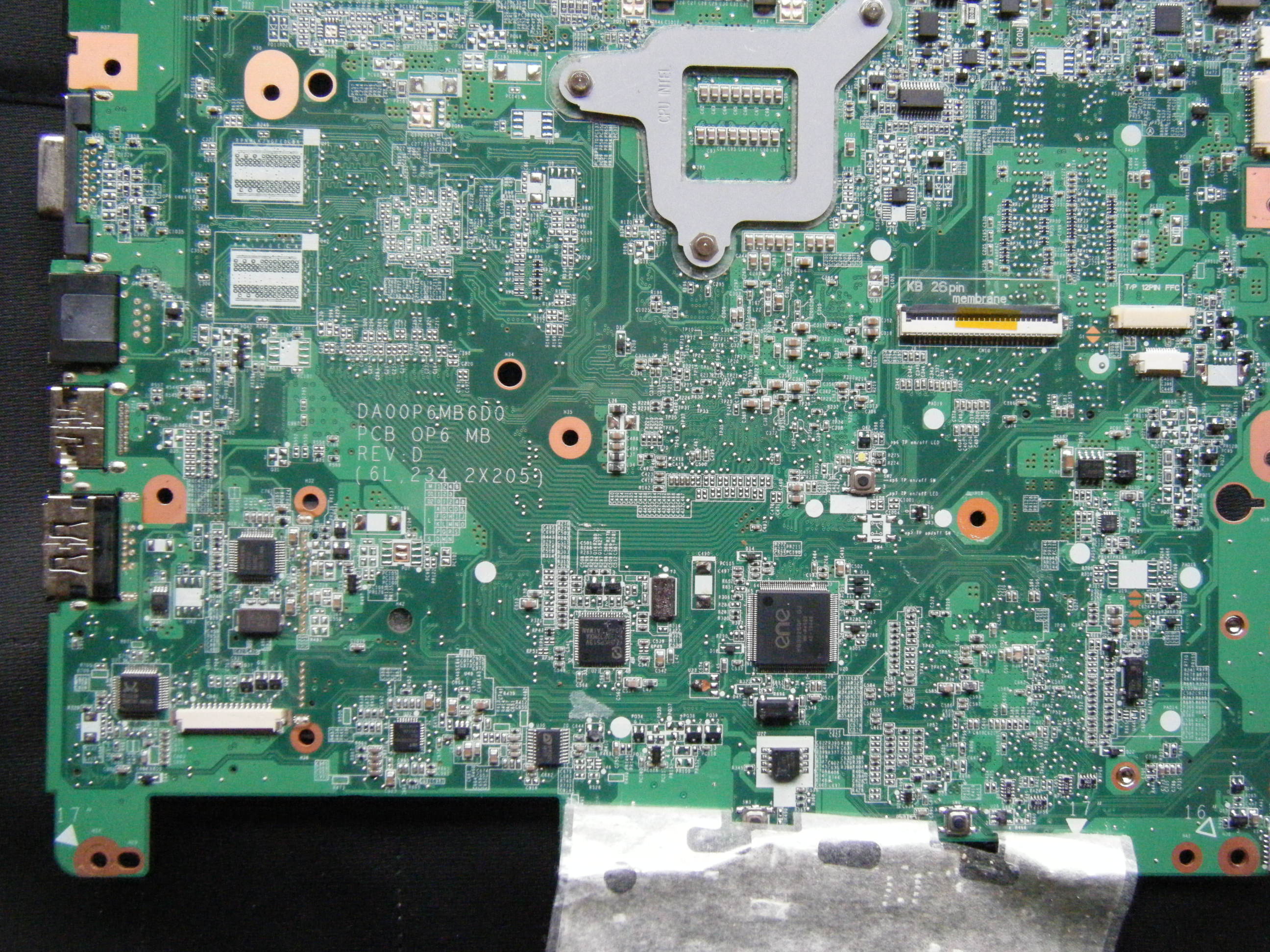

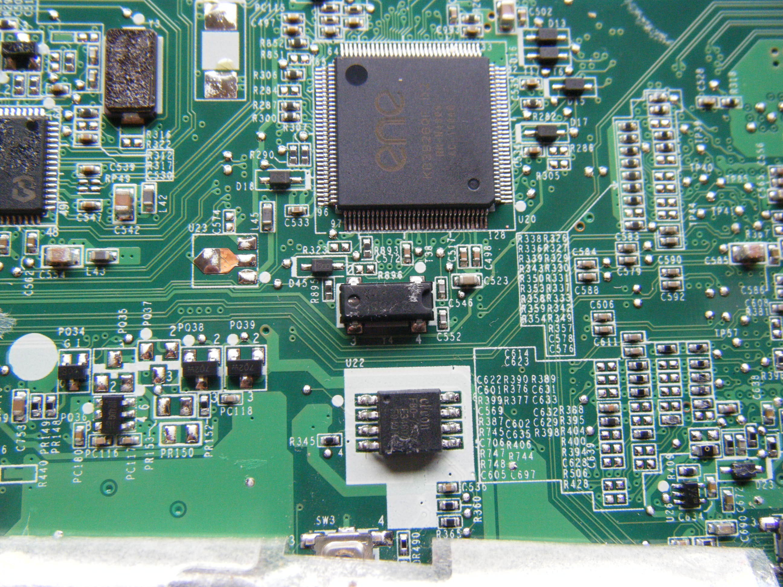

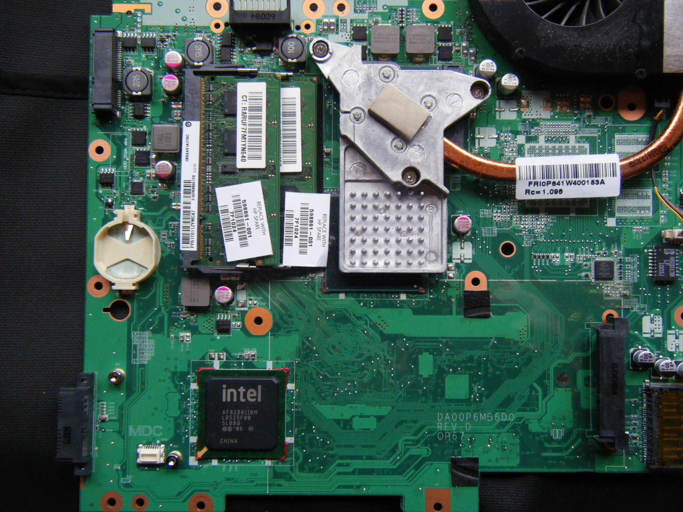

        Ok, at the risk of appearing to be a right nugget which one is the BIOS chip ?
        In the good old days they used to have a sticker on them but having just spent 20 minutes going over this m/board & the circuit there's several 8 pin SOIC chips which could be the BIOS. The drawings not a great help either imho
        but i have found a device marked ICH9 Boot BIOS on the drawing (but not located it on the motherboard yet.
        • dj_ricoh
          • Jan 2013
          • 2073
          • uk
          Re: Presario CQ61 Dead- Not Booting
          picture of the mobo will help
          usually the bios on cq its covered with white paint around
          near the mouse pad connecter(under mouse pad)
          or near memory slot
          • nogger
            • Aug 2010
            • 190
            dj_ricoh thanks again.
            I have posted some pics (best i can get with current cam) & i guess then we are talking about the U22 on pic 4 . What a sneaky place to put it. Thanks to that self adhesive aluminium coloure'd shield that was on top of it the type numbers have been erased but as long as i can remove.program & replace the same chip i should be ok.
            Out of interest someone mentioned an EC chip, what is that ? To me EC means Error Checking ?
            Regards
            Graham

                Not yet, not been able to read/program it.
                It seems the chip is a cFEON F80-75HCP SPI chip & the eeprom programmer i use (which was a DIY one) only programs the ATMEL 24C series (i2c) chips.
                Looking at he datasheets for the 2 chips they are slightly different in pinout/operation if i read correctly. I think i need something like a Willem programmer. I need to buy a decent programmer anyway so have to see whats available. In the meantime i can't go much further :-(

                  Just found a nice little circuit for programming these chips via an LPT printer port so will have a crack at that tomorrow & report back then.

                        Well good -ish news. Managed to reprogram the BIOS chip & re-soldered it (after making a copy first of course). The laptop now fires up with lights everywhere etc & video on the display but now it says 'No serial number entered' so if i have read correctly i now have to reprogram the bios with the serial number ? . I will search on here to see if anyone has covered this before but if anyone wants to advise then that would be appreciated.
                        Many thanks to those who responded before , especially dj_ricoh who helped with the BIOS file etc.
