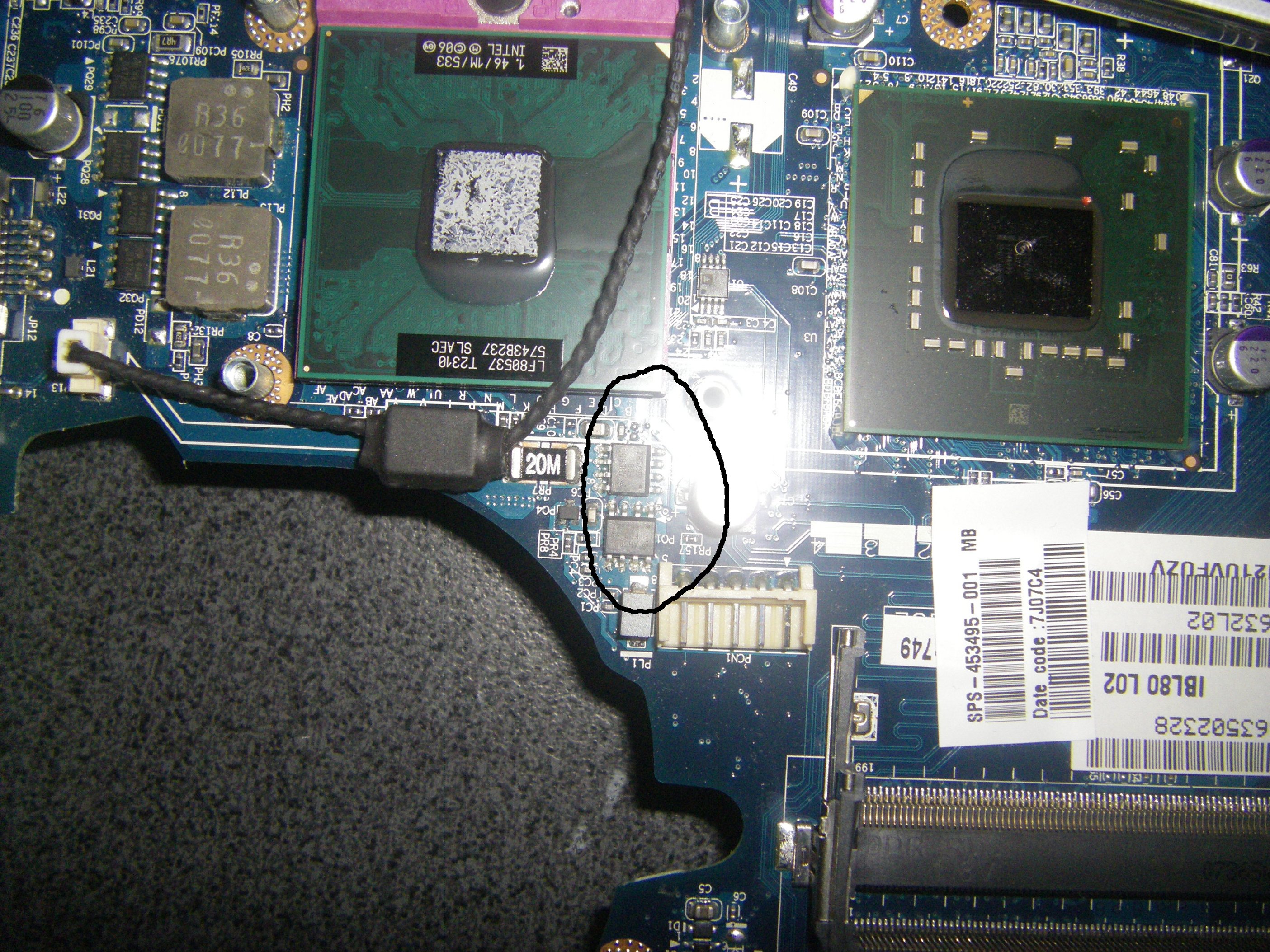

    HP Compaq C700 says charging but isn't
    I am trying to fix the charging circuit on this laptop. Windows says it is charging but the charging icon stays at 0%. There is plenty on google about this and one user replaced PQ1 and fixed it. I am looking at doing the same but I can't tell if PQ1 or PQ2 is bad. They are N channel mosfets Fairchild FDS6675BZ. They look very hard to remove without damaging the plastic fittings nearby. Here are the readings I got with my DMM set to continuity/diode mode (I've highlighted the difference from PQ2 and PQ1 in red):
    PQ1 Results:
    All the source pins to the drains are open circuit.
    Source to gate is open circuit
    All the drains to source pins give around 0.513.
    Gate to source pins show 1.827.
    There is continuity between all source pins and the same with all drain pins.
    Drains to gate show open circuit
    Gate pin to drains is open circuit
    PQ2 Results:
    All the source pins to the drains give around 1.665
    All the drains to source pins give around 0.511.
    I would appreciate it if someone with more knowledge would have a look at this information and let me know what they think. Does PQ1 look bad or not?

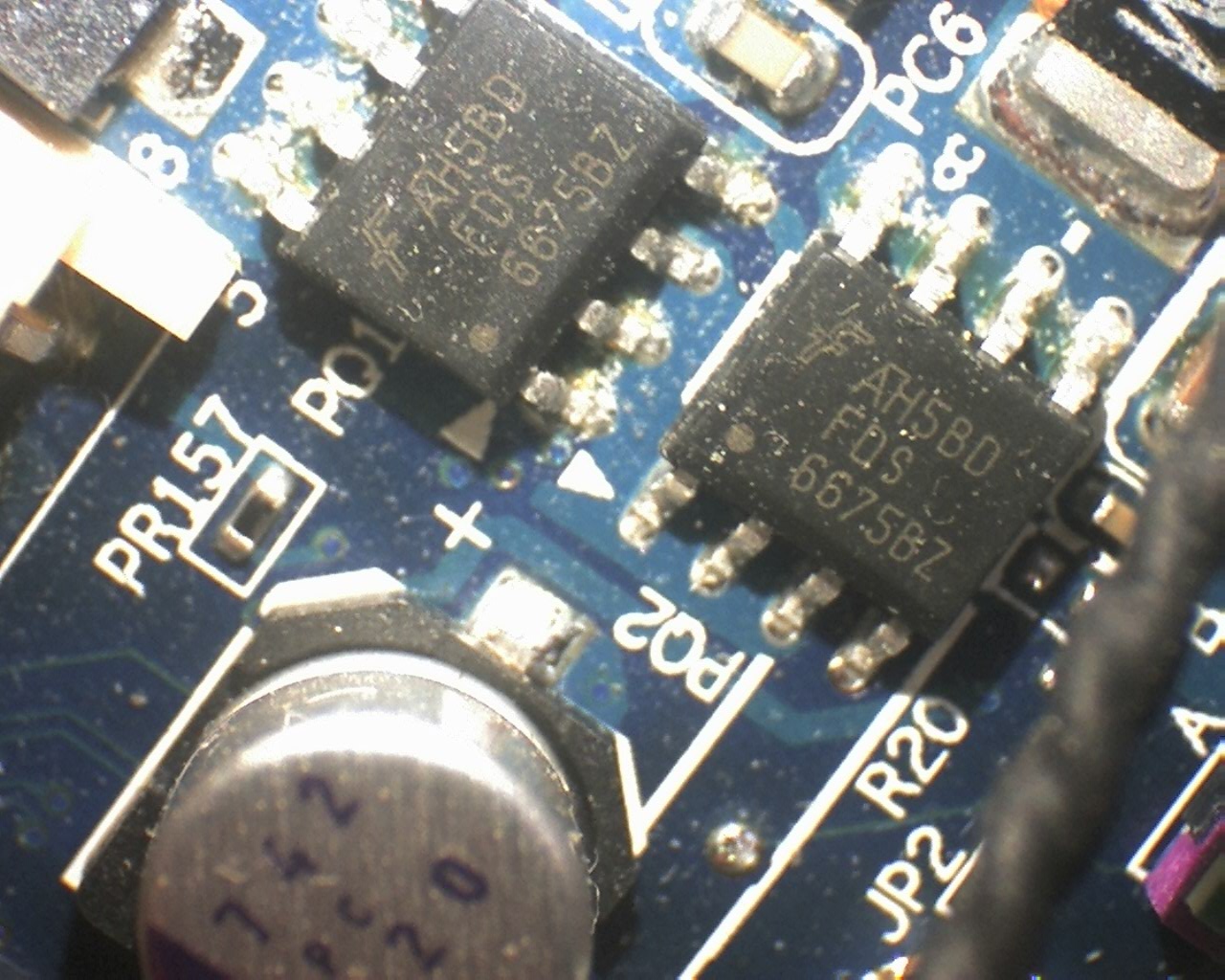

    The above measurements are in volts, according to the handbook on the continuity scale, I think. I have done more measurements using the resistance scale:
    PQ1 Results:
    Source to Drain – all open circuit
    Gate to drains – all open circuit
    Gate to source – all about 200 ohms
    Drains to gate about 1280 ohms
    Drain to Source:
    Pins 5, 6 and 8 to 1, 2, 3 are 980 ohms
    Pin 7 to pin 1 is 980 ohms but open circuit for pins 2 and 3
    PQ2 Results:
    Drain to Source:
    All drain pins show about 980 ohms to all source pins
    Does the red reading show PQ1 is bad?
    All measurements were done in circuit.

                          when you tested pq1 and 2 did you took them out?
                          if not test them of the board to
