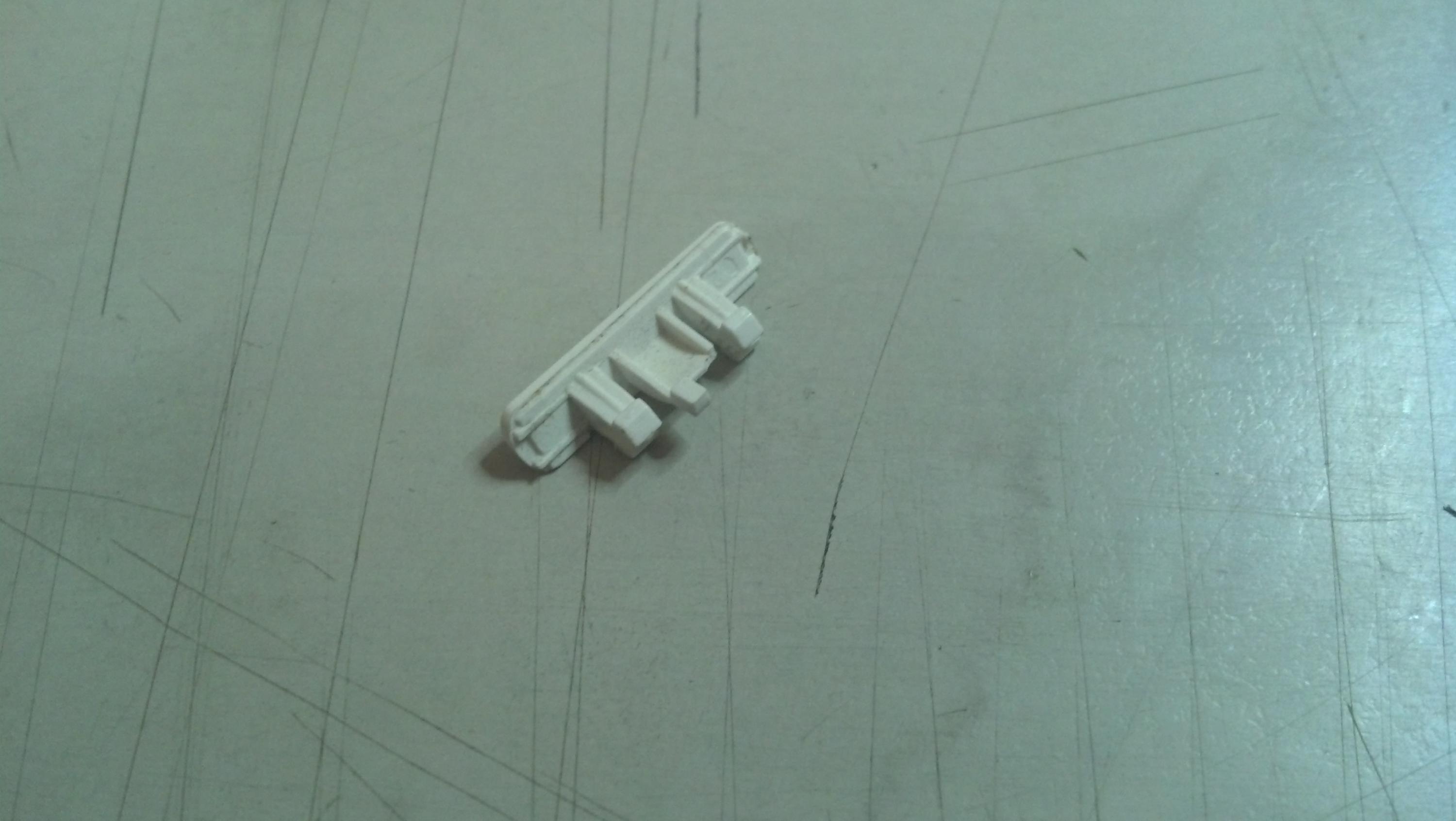

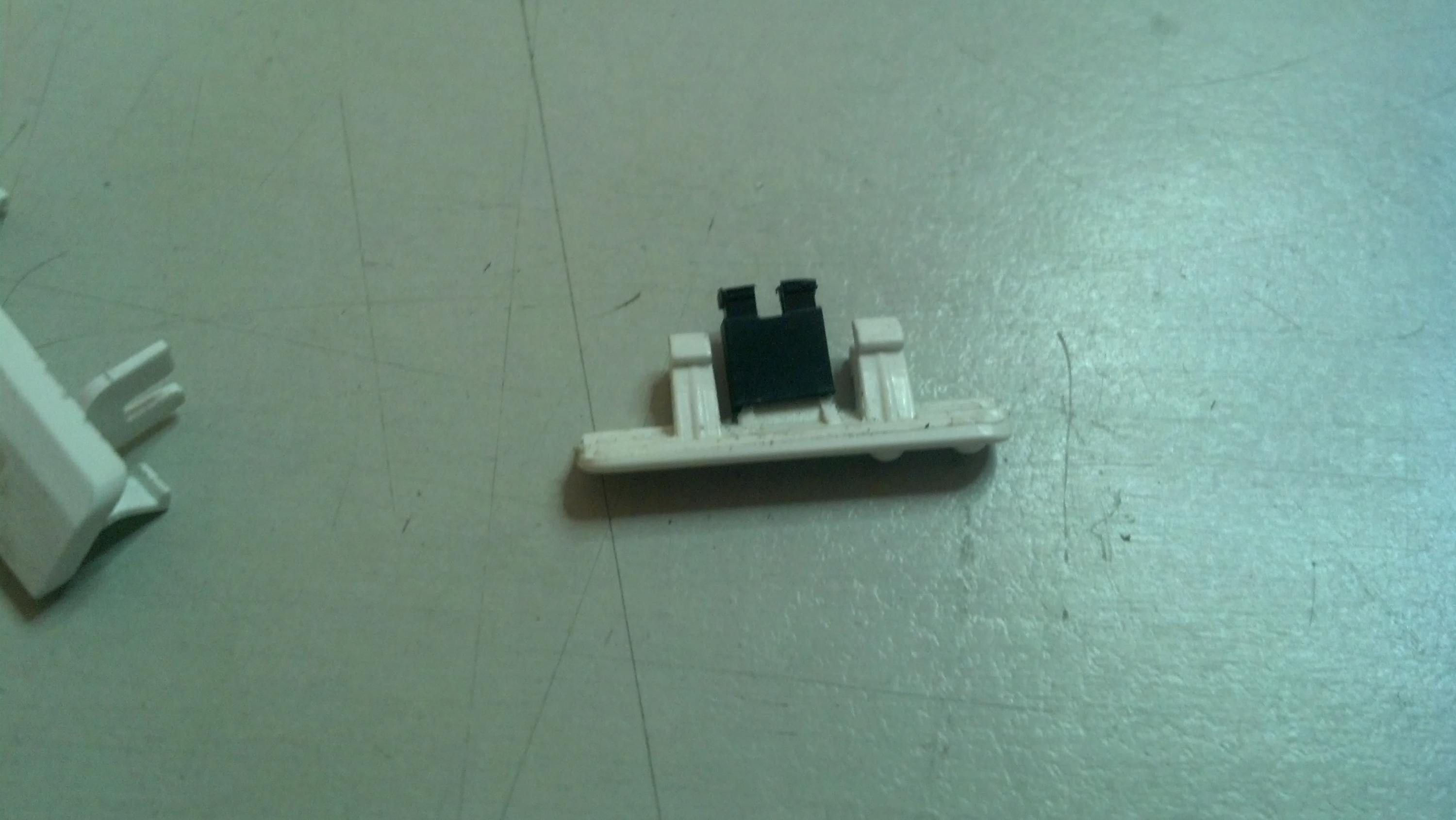

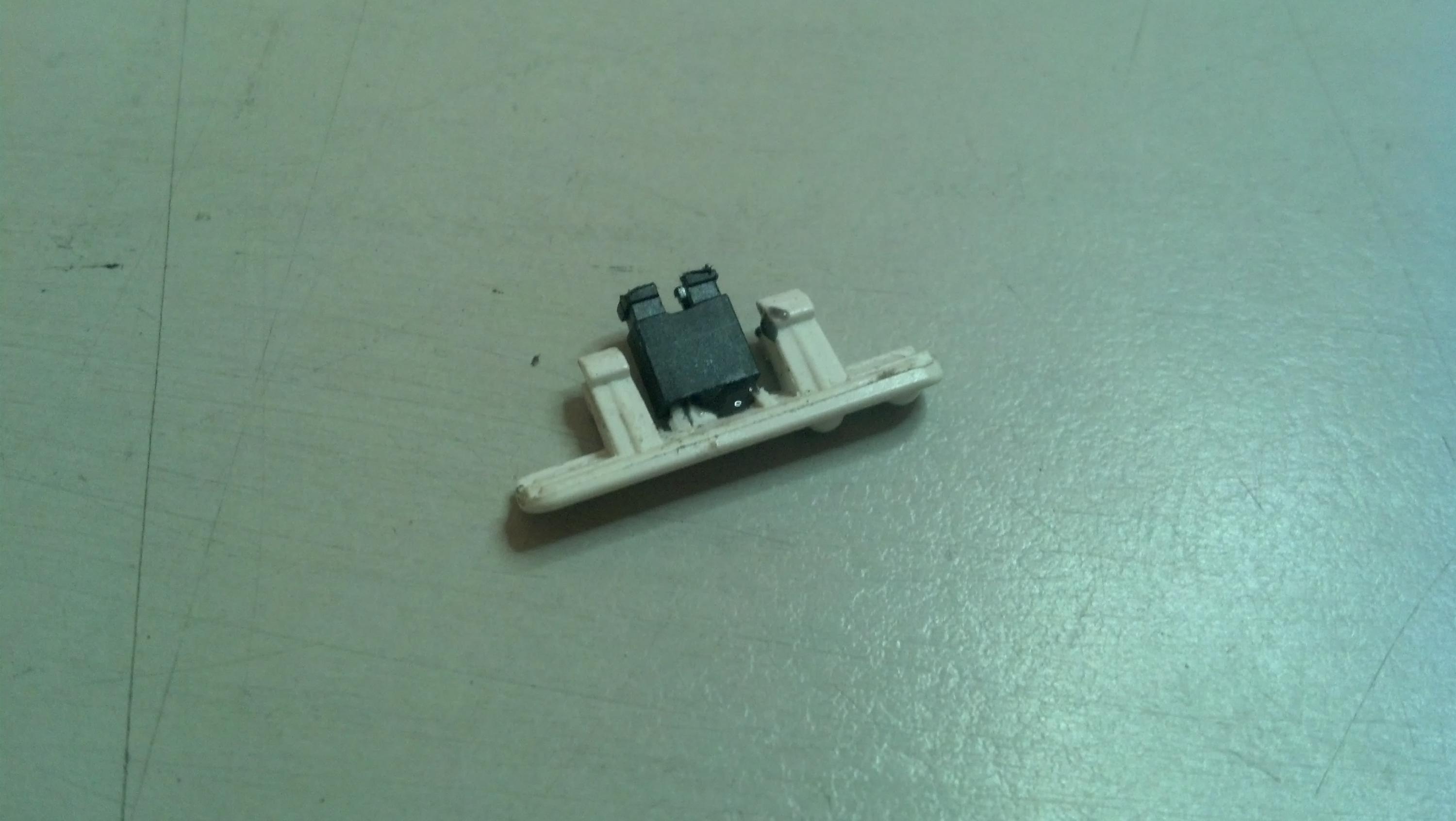

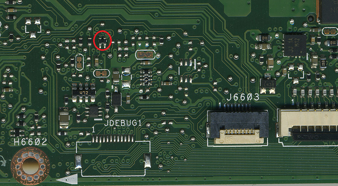

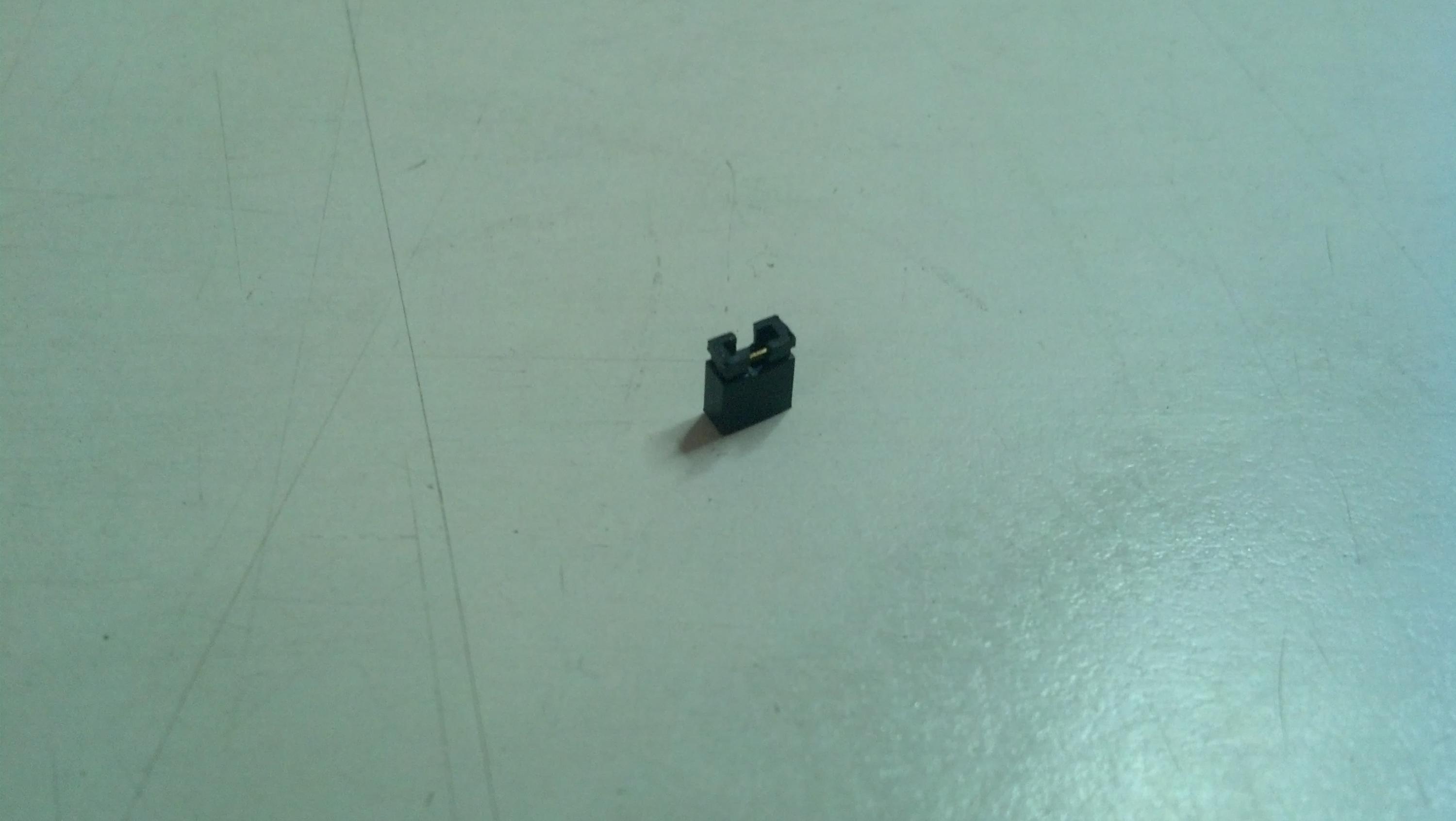

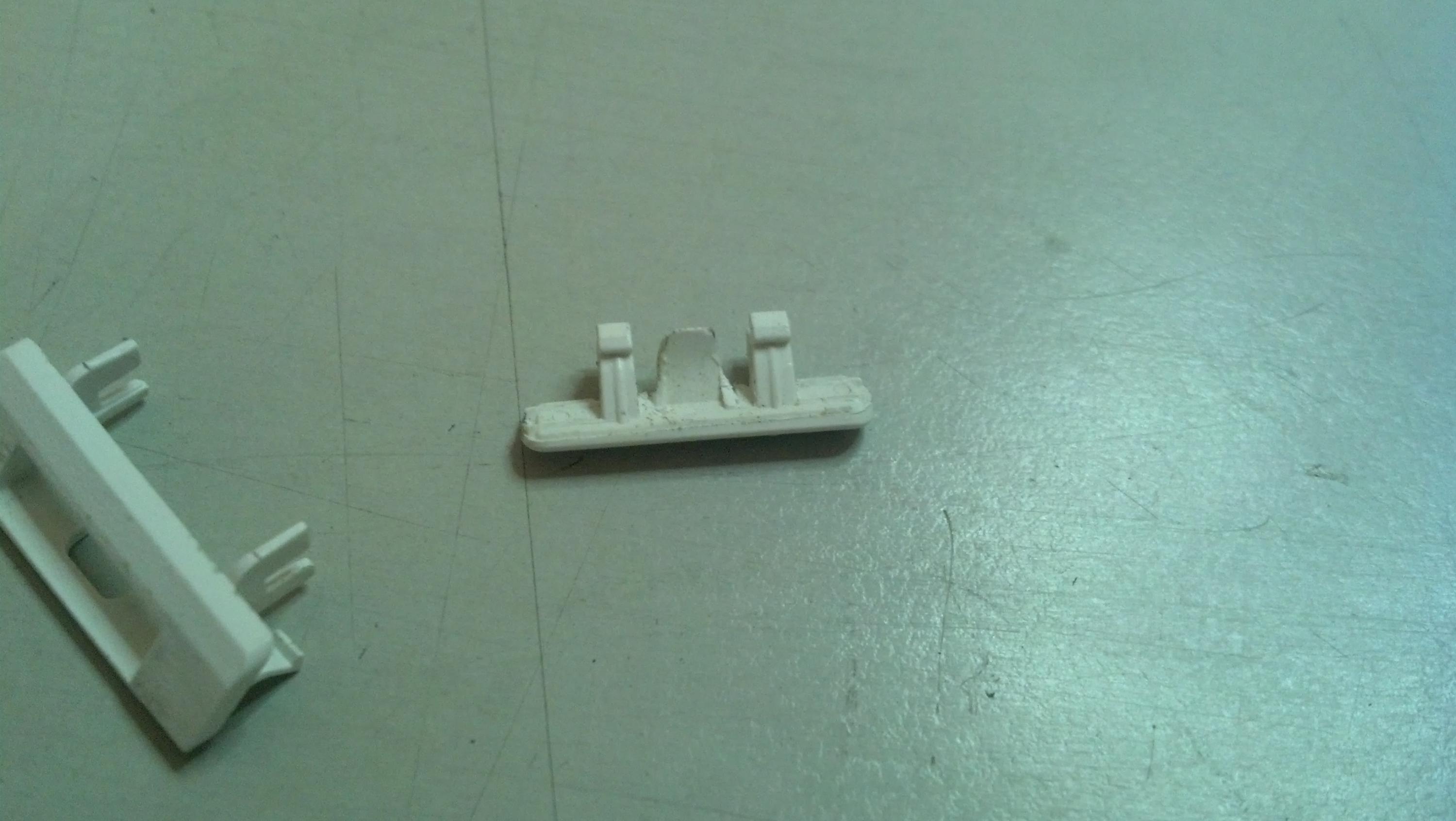

              Re: Laptop repair solutions, with pictures.

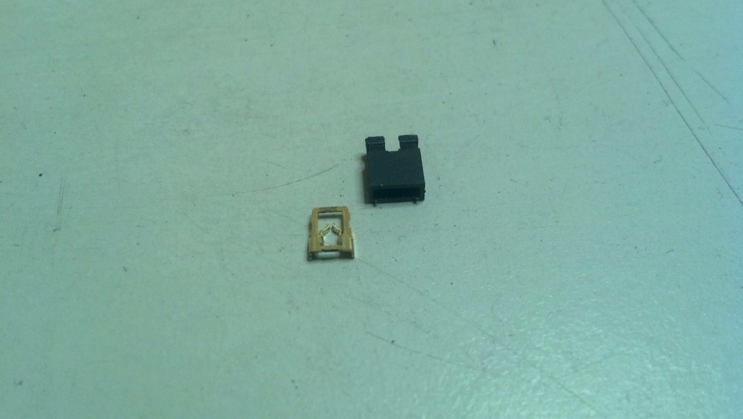

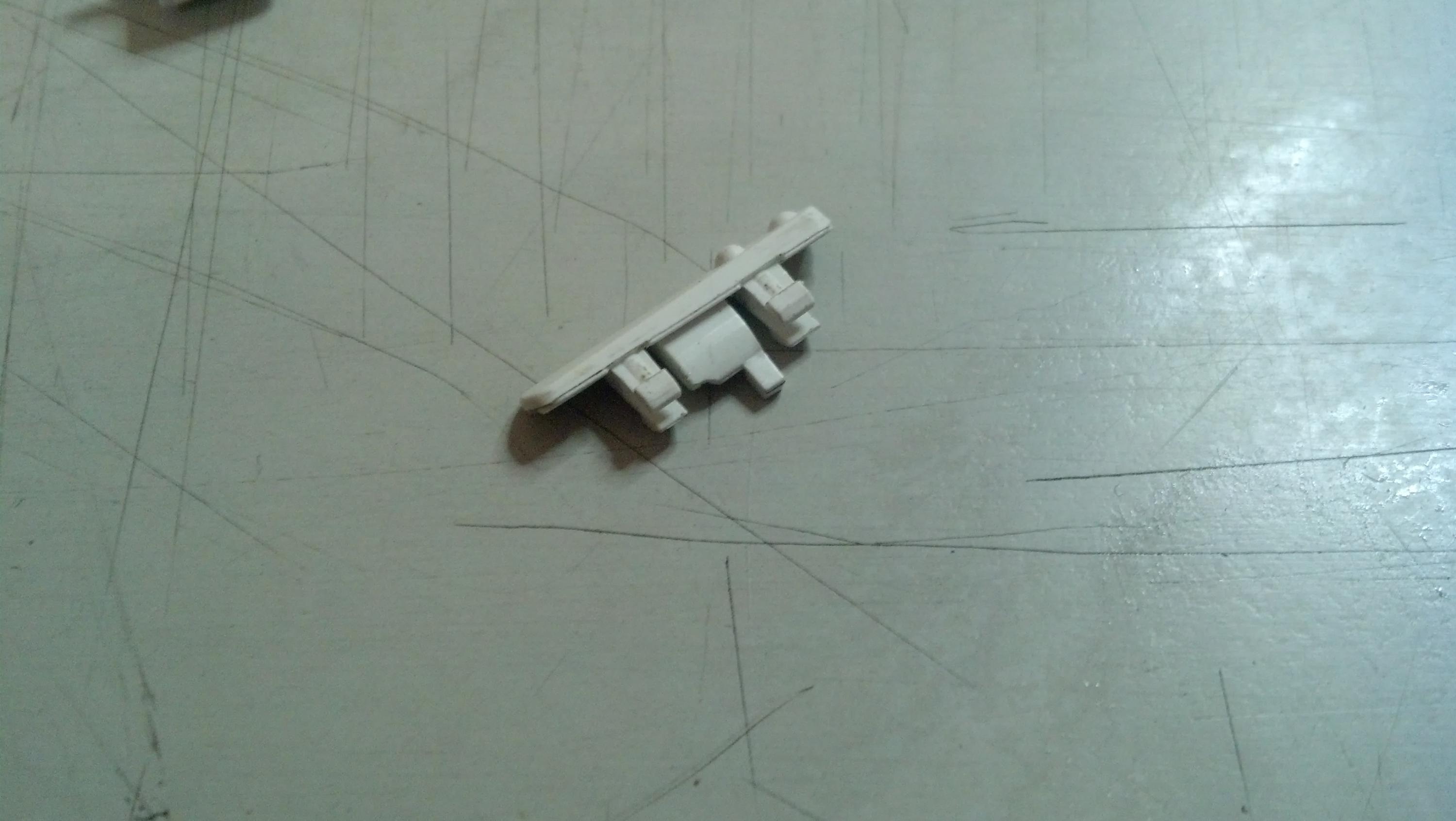

              Just want to share this simple fix on a Samsung netbook regarding power switch. Its applicable on models np-n145, np-n150 and np-n102s etc.
              I used jumpers found on motherboards or hard drive. Cut the the plastic for the jumper to fit. Inserted the jumper and glued it to make it stable. That's it, hope it helps
              check images:
                check images:
                brilliant!!! (gawang pinoy)

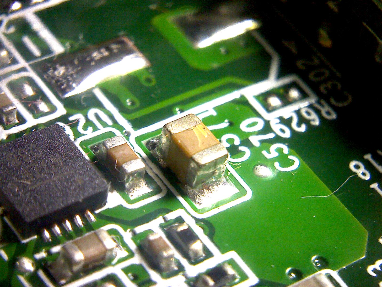

                            Laptop: Acer One 14 Z1402 series (NDBU1401_4L)
                            Problem/Symthom : Shorted 19V
                            Likely as common problem for this series, have been receipt 4 mobos which shorted on same point (on december)
                            Culprit: C571 ceramic caps rated 10uF 25V

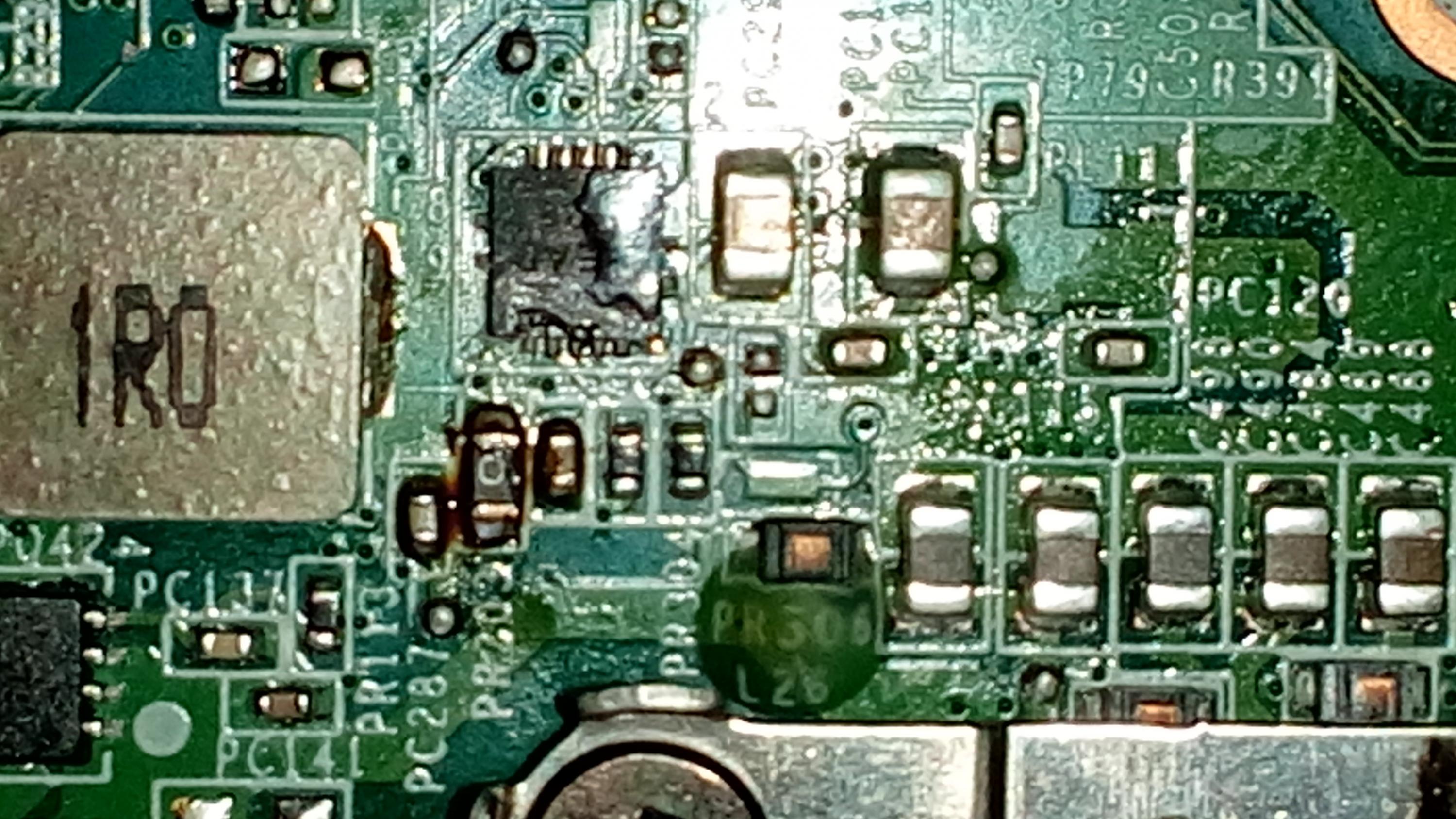

                            • mcplslg123
                              • Jun 2015
                              • 7262
                              • india
                              Hp15-u83
                              M/b switches on and instantly gets off.fan spins for 5secs and shuts down.
                              No display
                              found pr303 bad.
                              Replaced. Now mb boots fine

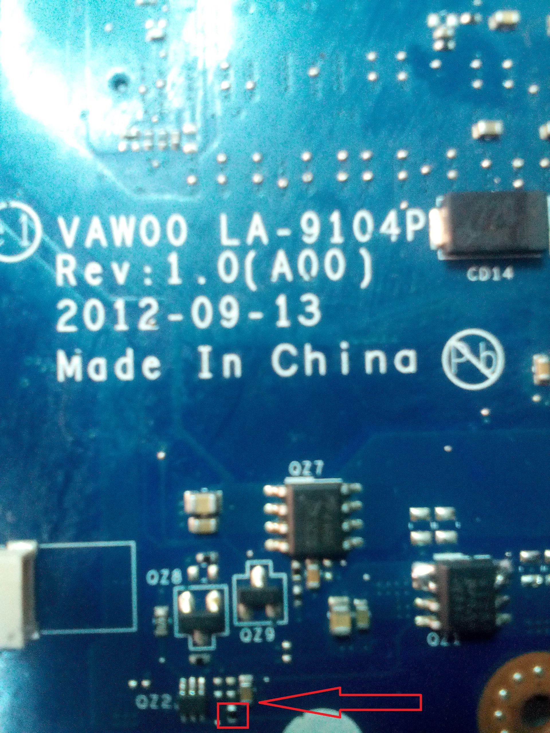

                              • meritosari
                                • Oct 2010
                                • 774
                                • Indonesia

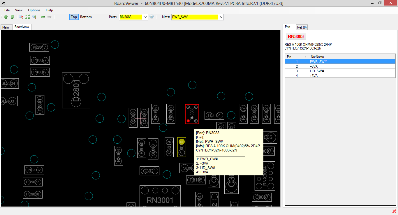

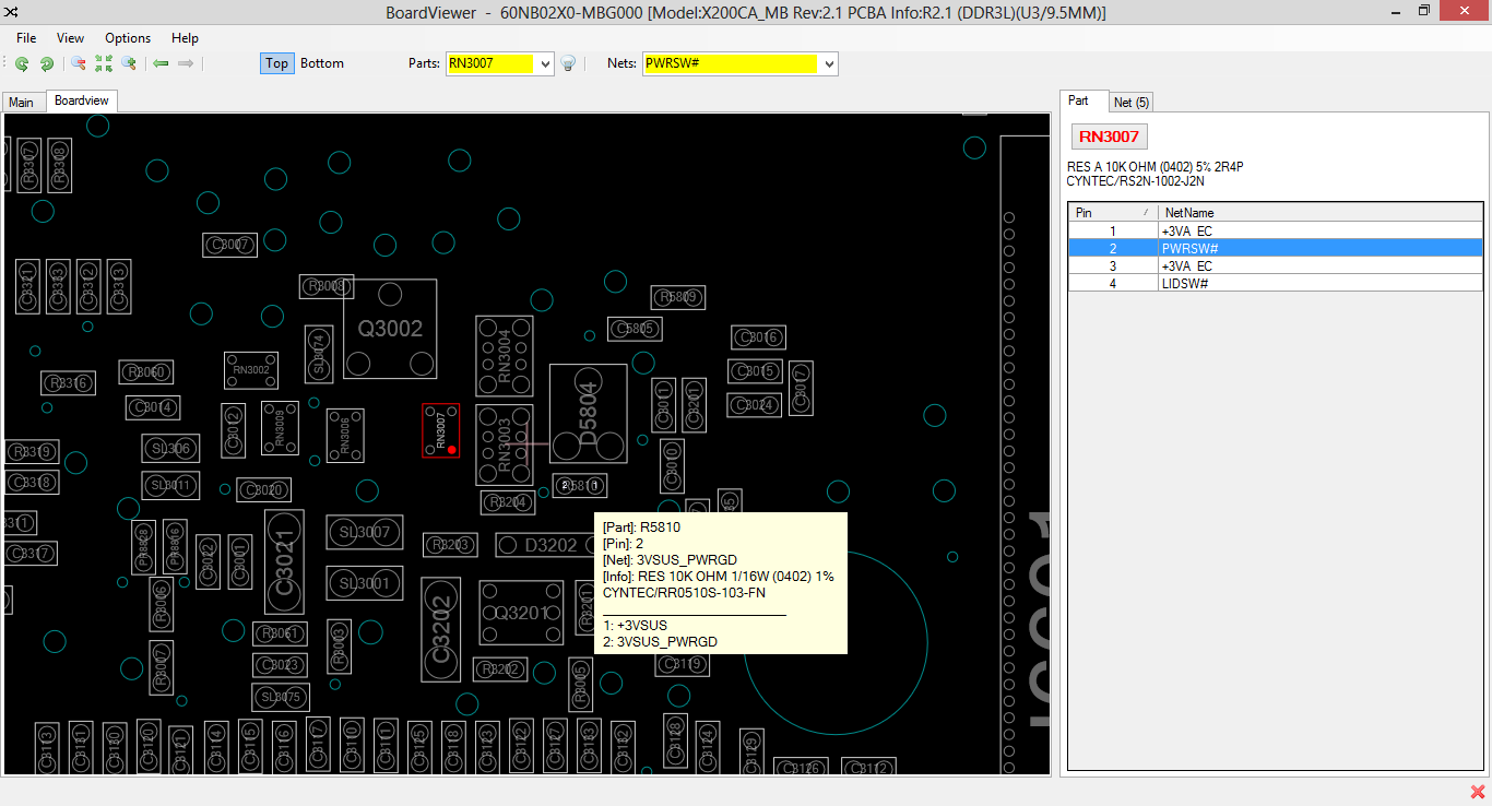

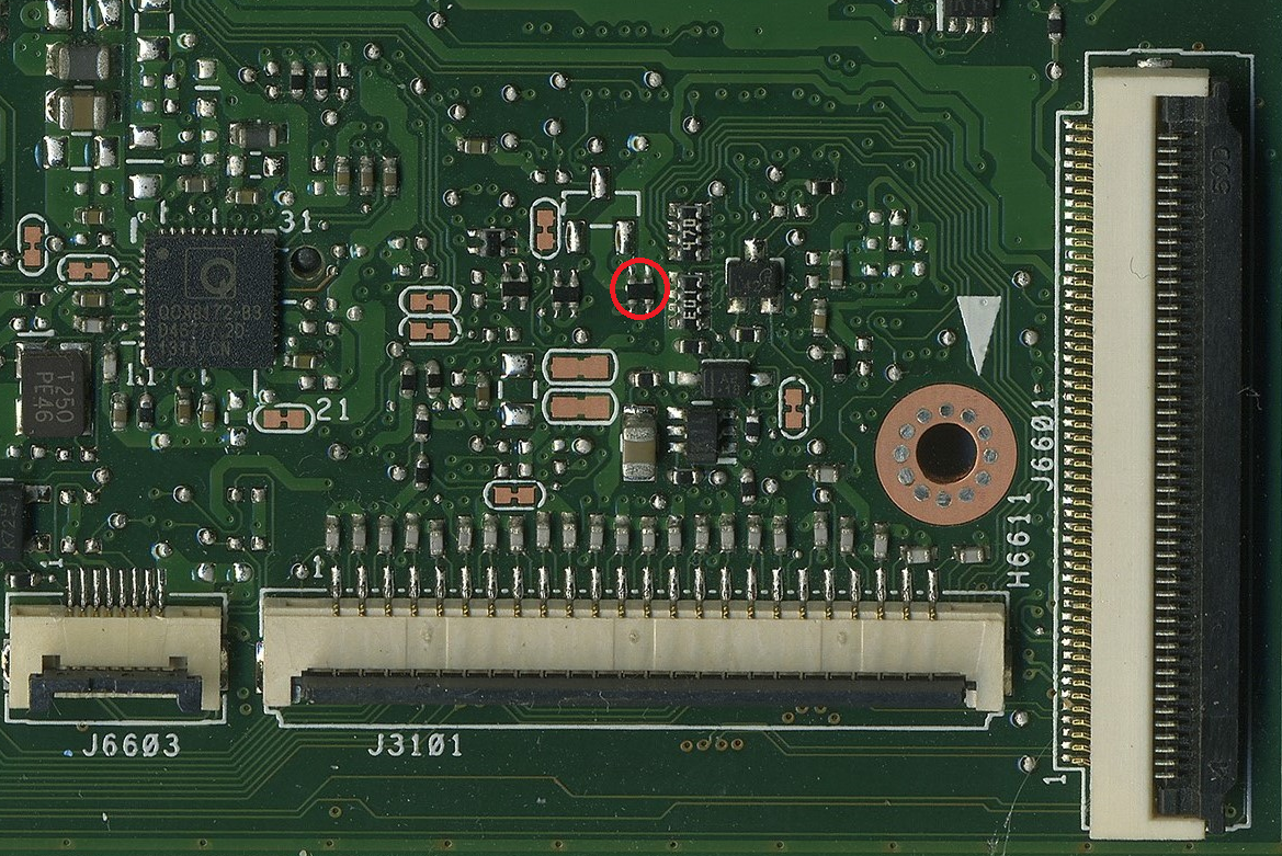

                                Re: Asus X200CA & X200MA.
                                Problem/Sympthom: Intermitt
                                Sometime can power on, at another time it did'nt work.
                                1. Measure on power button, 3.3V have been present - OK
                                2. Already re-flash bios with no result
                                2. Replace ON/OFF button, problem still remain
                                4. Measure resistance on RN (resistor network) that have connected with ON/OFF. the value still good. Try disconnect IO board from main board, then try switch from EC/KBC/SIO pin PWRSW#. The Mobo can turn on without problem.
                                5. Replace RN then solve the problem,
                                6. Test it on some hour. Finally problem solved
                                Still curious...but the point was it works
                                • kiraro
                                  • Jan 2016
                                  • 177
                                  • North NY
                                  Very good work meritosari ,but excuse me how you disconnect io ?just remove RN to disconnect?thx
                                  • inflex
                                    • Aug 2012
                                    • 544
                                    This is about the most common fault I see in this workshop. 0805 10uF 25V ceramics shattering like that, multiple brands. I like it, easy to spot generally, easy to replace.

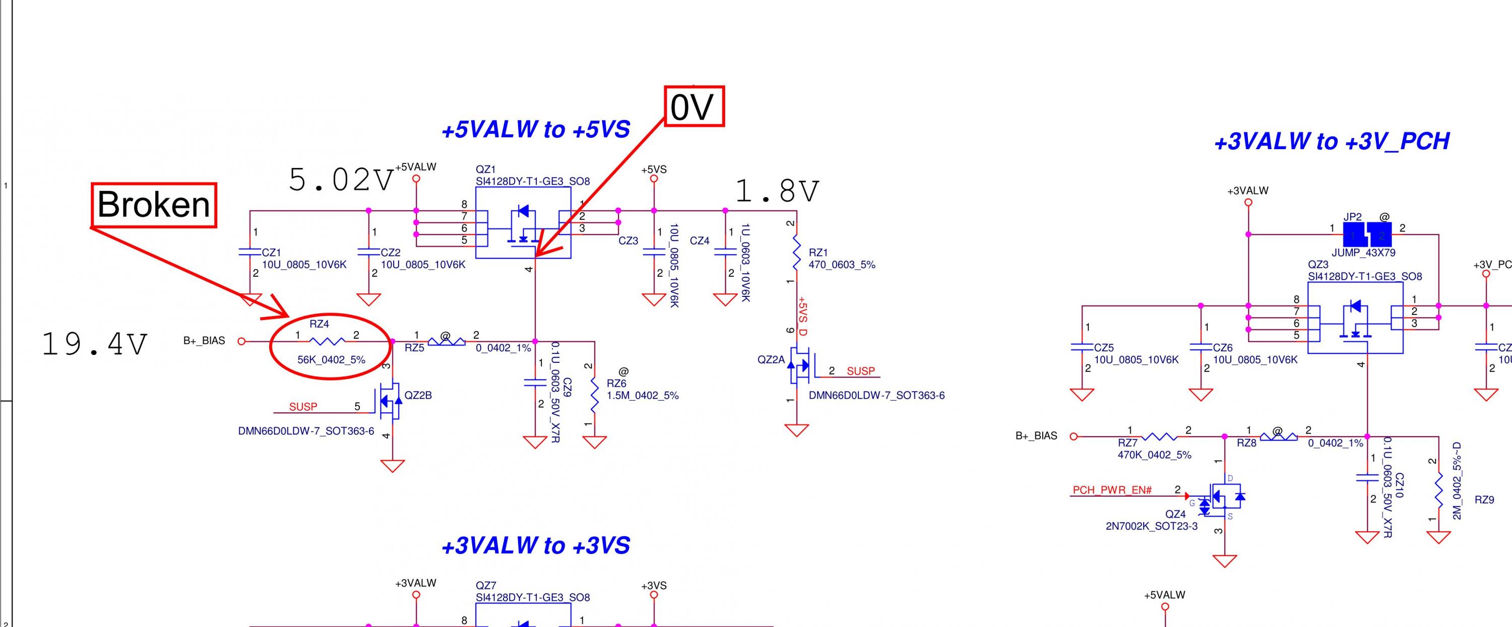

                                      Dell 3521
                                      Problem: no display
                                      1. Missing +VCC_CORE & +VCC_GFXCORE_AXG.
                                      2. Checking PU700 (ISL95833HRTZ) VCCP is missing =1.8v how is connected to +5VS, it should be 5V.
                                      3. Checking +5VS at QZ1 (+5VALW to +5VS), +5VALW present (Drain), Gate (0v), Source (1.8v).
                                      4. Checking B+_BIAS connection ok and present, checking RZ4 resistance broken (56kohm), replace it and finally problem solved.
