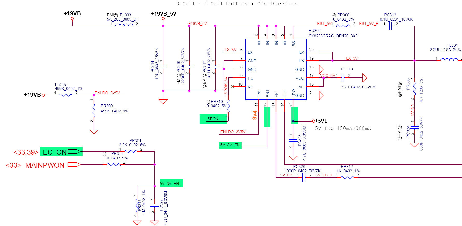

    Hi, sch is from LA-G07DP but looks similiar. Problem is that 3/5 v ALW comes when bring power short (1-2 sec)
    From image all marked GREEN is same, 1-2 sec has power
    SPOK colmes 3v3 for short time
    en2= 9v4, its normal and is stady voltage
    en1= 3v3/5v short same as SPOK
    LDO 3v/5V only present short as SPOK
    Pin 11 of IC has stady 9.4v but LDO output also goes iff after 1-2 sec
    EC_ON on pin112 comes also short time and goes low
    Small ic drivers for 3 and 5v alw are SY8286A
    Any help please?

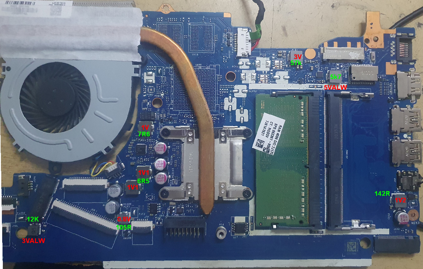

      Not seen suspicious resistance, I use to see current consumption bemch lab power but same probl with ori power adapter
      when 35v present than board without battery tajes 450mA and there us oresent cou voltage 1.1v 2 ohases,1.0v, 1 2 to ran, fan spinning but after 3 sec all stops, i noticed if I bend pcb (i connected wire to 5v alw coil) than voltsge comes, like some bad soldering or maybe vias on pcb

              Resistance ACP/ACN is 0.004R, on probe direct 0.001R and drops to 0.000R
              Here is image with coil resistance with GND
              BQ chip write on it BQ25A...

                  Will check voltages tommorow, also will put your bios even servicer before me tried ,but strange when I bent, press board on ram connectors missing voltage comes again and after 2 sec goes away again. Like some bad solder or pcb

                          I give up when bend pcb or press power button all voltages present and goes away after 2 sec
                          tnx for trying help
                          • mon2
                            • Dec 2019
                            • 13995
                            Sounds like a PCB break and/or solder joint dry solder that mates with the flexing. Either way, a tough one to hunt down.
