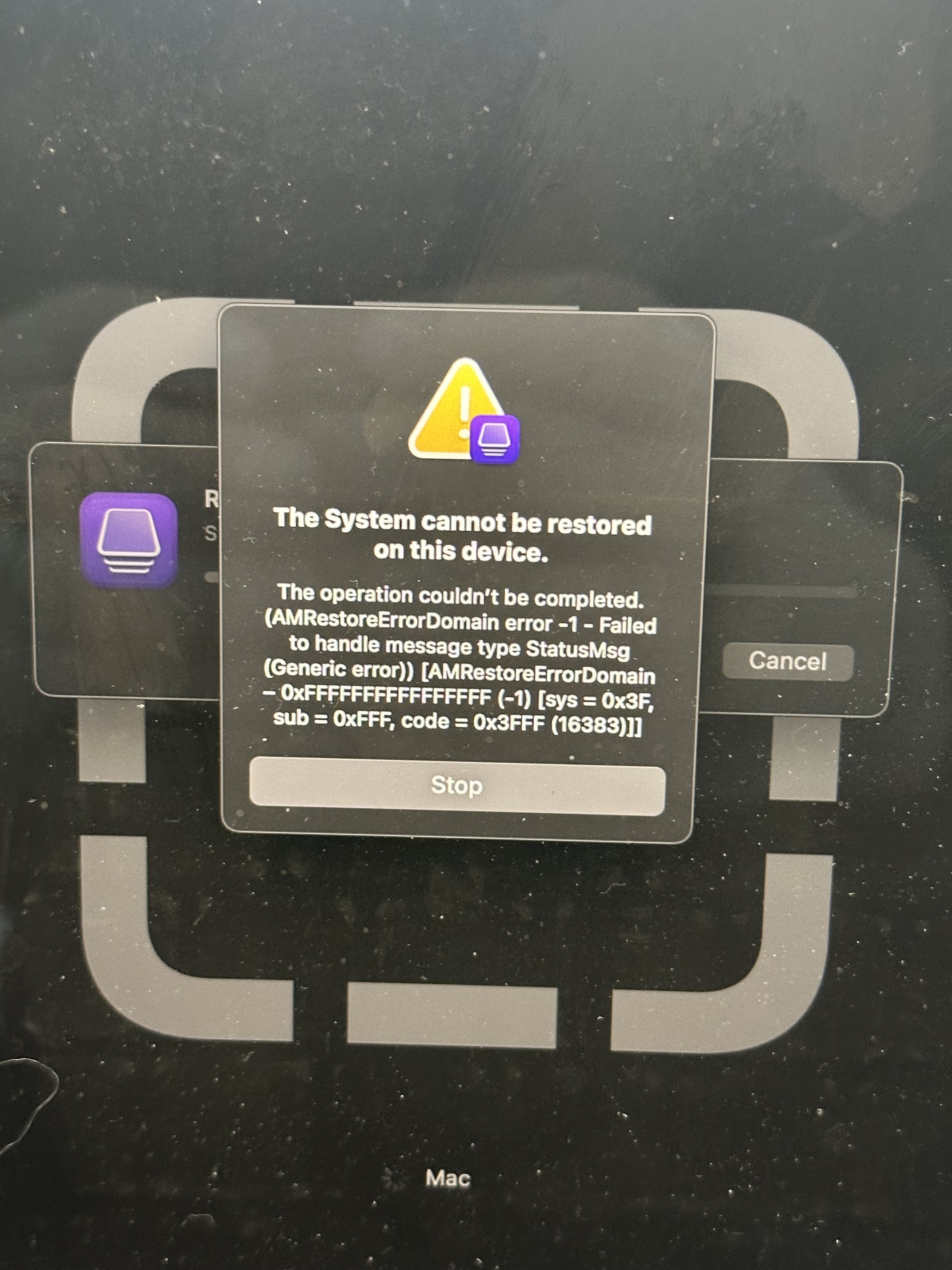

                              Click image for larger version  Name:	IMG_1735.jpg Views:	0 Size:	2.08 MB ID:	3544147
                              This is the error message I am getting when trying to revive the computer. The computer goes into DFU so keyboard commands respond. Track pad clicks constantly when it fails. Lid sensor is not liquid damaged and looks brand new.
                              I am going to order a new lid sensor out of curiosity. Calibrate it and see if that's the reason. But I did look up error 1 and it points to Battery, however the battery is charging and holding a charge when not connected to power and depletes normally.

                                #35
                                Hey mon2 any idea what it could be?

                                  #36
                                  Are you sure the keyboard is doing anything? Are you able to enter the DFU without touching the keyboard? Attempt it.

                                      #38
                                      If the keyboard is truly working, are you able to force this laptop to boot from an external known good OS and drive?

                                        #39
                                        The Laptop didn't revive so I have the exclamation point error until I fix this issue. So possibly won't be able to boot externally until I resolve this issue. Since I tried to do a DFU revive it couldn't complete and now it won't load the OS. So gotta fix that as well. I want to just chuck this computer in the trash (jokingly)
                                        I ordered a good top case with a good keyboard, battery and trackpad w/ cable, and good daughter IO board. I also ordered a new lid sensor even though this one is working. I will program the new lid sensor, swap out the top case and see if I persists. I will get back to you with my findings.
