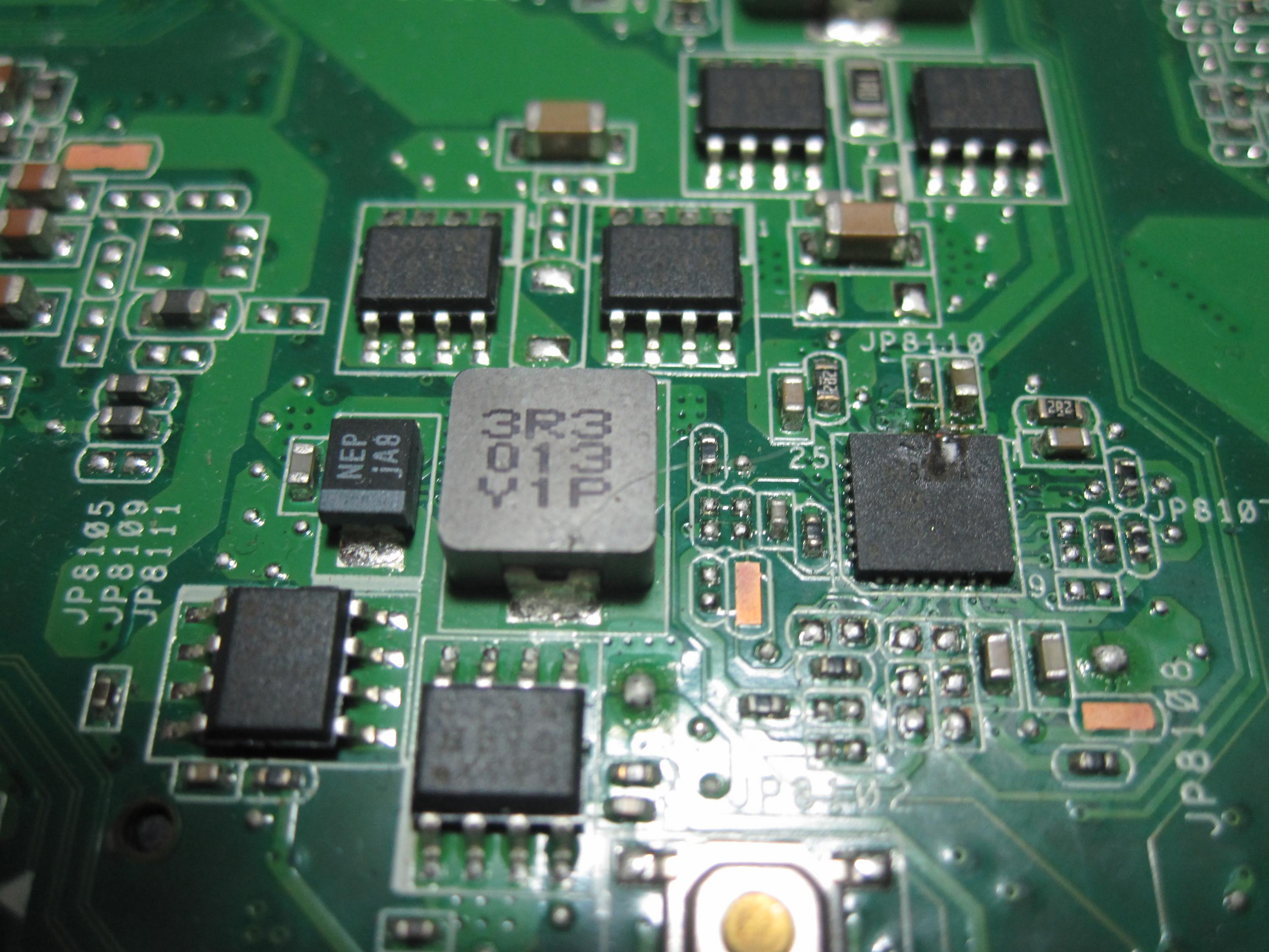

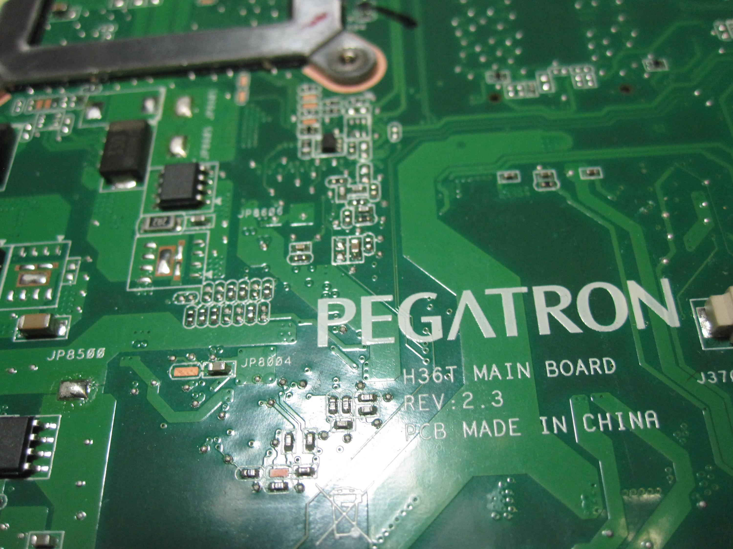

    does anyone know what is the burning IC or have a schematic for this pegatron H36T mainboard rev. 2.3? TIA

    clean it with ipa and you can read whats left

          After clean up i can read RT8...A, missing some numbers in the middle, middle row is GQM and last row is CDC2Y. This motherboard comes from leader notebook local brand and model H36

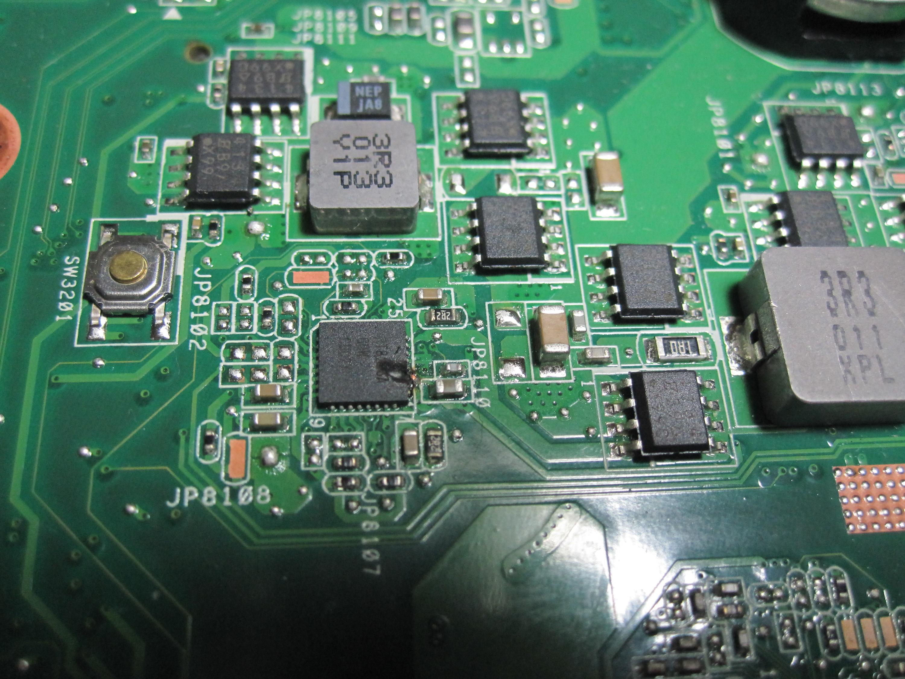

            Here is picture after clean up it seem as RT82..6A

              if its only one digit not seen
              maybe its this one
              http://kythuatphancung.vn/diendan/in...3%A1n-rt8206a/

                I can confirm it. I have an H36T on my bench and is an RT8206A.

                  Thanks for all replies, as you can see it seem this ic has a very big bang what is causing that? I 'd like some advises do I need to check any other components before I turn it on after replace this ic?

                    Remove it and check resistance relative to ground on all pins

                      seems like rt8206, 3.3V and 5V regulator IC.

                        Rt8206a
