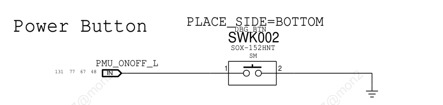

Macbook Pro A1990 PP5V_G3S missing
  • geiti94
    • Feb 2023
    • 16
    • switzerland
    PP3V3_G3H_RTC_X is 3.3V. PP1V8_SLPS2R​ have 1.81V. U6940 pin 10 are at 0V
    • mon2
      • Dec 2019
      • 13894
      Short / press the power button @ SWK002. Does this change anything.
      • geiti94
        • Feb 2023
        • 16
        • switzerland
        nothing changes. CHGR_RST_IN stays still at 0V. Faulty U6940? I Tryed it to reflow it too with flux and nothing changed. is there any mod for bypass U6940 for testing before i order then a new one?
        • mon2
          • Dec 2019
          • 13894
          What is the default voltage to ground on PMU_ONOFF_L? This should be a logic '1' since there is a pull-up to PP3V3_G3H_RTC_X @ R8015. When the power button is not pressed, the default voltage should be 3v3. There should also be a button or shorting pads @ SWK000 (opposite of the PCB) for the same purpose.
          • geiti94
            • Feb 2023
            • 16
            • switzerland
            i replaced now U6940 with one of a know working board but icloud locked. Pin 10 still 0V. Voltage at R8015 is 3.3V.
            • geiti94
              • Feb 2023
              • 16
              • switzerland
              that board is strange. all volltages are here. looks like a broken t2 firmware now but i cant enter dfu mode. when i check on the pad dfu_status stays at 0V instead of 1.8V
