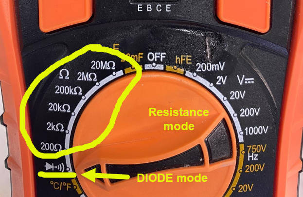

    yes pq12 is soldered on board. Measured using 2K ohm
    source to drain = .0L
    source to gate = .0L
    gate to drain = .0L
    • mon2
      • Dec 2019
      • 13955
      Keep increasing the resistance scale till you have a measurement that is no 'OL' = over limit.
      We need to know the resistance of the mosfets.

        moving counter clock each measurement.
        2M ohm selected
        source to gate = 1.001
        gate to drain = .0L
        I got the same measurement at 20M (1.00)

            Remove all power. Meter in resistance mode (not diode mode). Measure the resistance to ground of PUS801 (LDO output). What is the resistance in ohms? If the meter reports 'OL' = over limit, then switch to a higher meter scale till you have a measurement. We are checking if there is a shorted part on this power rail which will cause PUS801 to be a higher temp than normal.

              2M OHM Measurement.
              PUS801 PIN 1 +20_LDO_INPUT = 0.232

                do you think this could be pus05 ?
                removed PQ12 and in diode mode measured source to gate = 0.549
                resistance measurement at 2M ohm = 1.001
