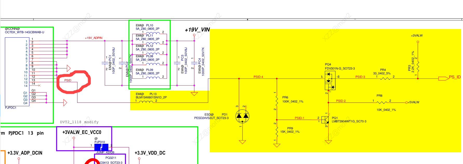

    Alienware m17 R3 which charges using USB-C however it does not charge using PJPDC1 (dc jack)
    • disconnected PJPDC1 and measured voltage on Pins 1-6 19V (19V_ADPIN)
    • once connected into PJPDC1 PIN 1-6 1.20V (19V_ADPIN)
    • Diagnostic tests does not detect charger.
    Has anyone have this issue before?

    What are the details of the dc jack power adapter? Alienware = Dell so most likely using the PSID 1-wire interface to identify the power adapter. Is the BIOS able to detect the power adapter? If not, the PSID is not working.
    Confirm that the DCin jack is not defective.
    Confirm (without power to the board) that the PSID pin of the DCin jack is mating with the PL13 ferrite bead on the logic board.
    Then, attach the power adapter to this logic board and measure the voltage to ground of either side of PL13. What is the voltage?
    There are many threads on this forum on this topic so do review them but often, PQ4 mosfet becomes defective or the DCin connector itself is at fault.
    Be sure that you are using a true Dell brand power adapter and not a DC power supply. Only the original adapter will offer the 1-wire device to identify the power adapter's specifications.
    Click image for larger version  Name:	PSID.png Views:	0 Size:	144.5 KB ID:	3500017

      • It is OEM 240W Dell Power adapter
      • I do not have a dc jack to check however i did measure pin1-6 and I am receiving when measure the dc jack connecter unplugged from the board.
      • PSID pin of the DCin jack is mating with the PL13 confirmed.
      • PIN 13 PSID 3.17v
      • 0V on PL13 with the power adapter plugged in and battery unplugged.
      thank you for all the help

          Missed that you lose the adapter voltage on insertion into the dcin jack. This implies a power path issue. Review the sticky above by piernov on battery charge circuits.
          Trace where this adapter voltage travels. Remove all power. Measure the resistance to ground of this output rail.
          With no power, test the resistance across the mosfets in the power path to the charger chip.
          Measure
          source & drain
          source & gate
          gate & drain
          The unit operates ok on the usb C power adapter or when using a charged battery?

              Attach the power adapter. Measure the voltage to ground on the mosfets @ PQ12, PQ15. Measure source (1-2-3); gate (4); drain (5-6-7-8) on each mosfet. After PQ15 -> the charger IC follows. This is for the barrel jack power adapter power path.
              When using the Type C adapter, it is PUS02 who passes on the VBUS voltage from this source onto the charger IC which we know works.
              So the suspects are the PQ12 & P15 mosfet cluster and their driving circuits.
              Post each measurement.

                thanks again for your help. i measured the following.
                PQ12 1-2-3= 0v 4=0v 5-6-7-8 = 0v
                PQ15 1-2-3=0.5v-0.8v 4=0v 5-6-7-8 =0v
                update: removed PQ12 and receiving 19v on 1-2-3 gate.

                  Source pins = 1-2-3
                  gate pin = pin 4
                  drain pins = 5-6-7-8
                  If you remove PQ12, you have 19v present on the removed PQ12 pcb pads - pins 1-2-3?
                  Confirm that you have 19v present on each side of the emi coils @ PL8-PL12.

                      yes when pq12 removed, pins1-2-3 receive 19v
                      PL8-PL12 = 19.9V on each side of the coils.

                        The other P-channel mosfet you have should be ok as a replacement for PQ12. If you solder back PQ12, the voltage on pins 1-2-3 (source) are no longer 19v? If correct, remove all power, meter in resistance mode. Measure the resistance to ground of the drain pins (5-6-7-8) on PQ12.
                        What are the voltage measurements to ground on the comparator @ PUS06A? The issue may be the gate driving logic that is south of the mosfet @ PQ12 in the schematics. Going cross-eyed following this spaghetti schematic.
                        We know that PQ12 is a P-channel. For this mosfet to enable, the gate voltage must be lower than 19v. For this to occur, the 2N7002 @ PQ8 must enable. The gate pin on PQ8 is driven by the comparator @ PUS06A pin # 1.

                          - soldered back the "sus" mosfet removed and resistance to ground for pins 5-6-7-8 = 1.479v, i am now getting 19V on 5-6-7-8 Pin 1-2-3 = 19V PIN 4 = 9.4V
                          - PUS06A PIN 4 (GND) = 0V
                          - PUS06A PIN 1 = 3.2
                          - PQ8 PIN 1 D4_DCIN = 0V
