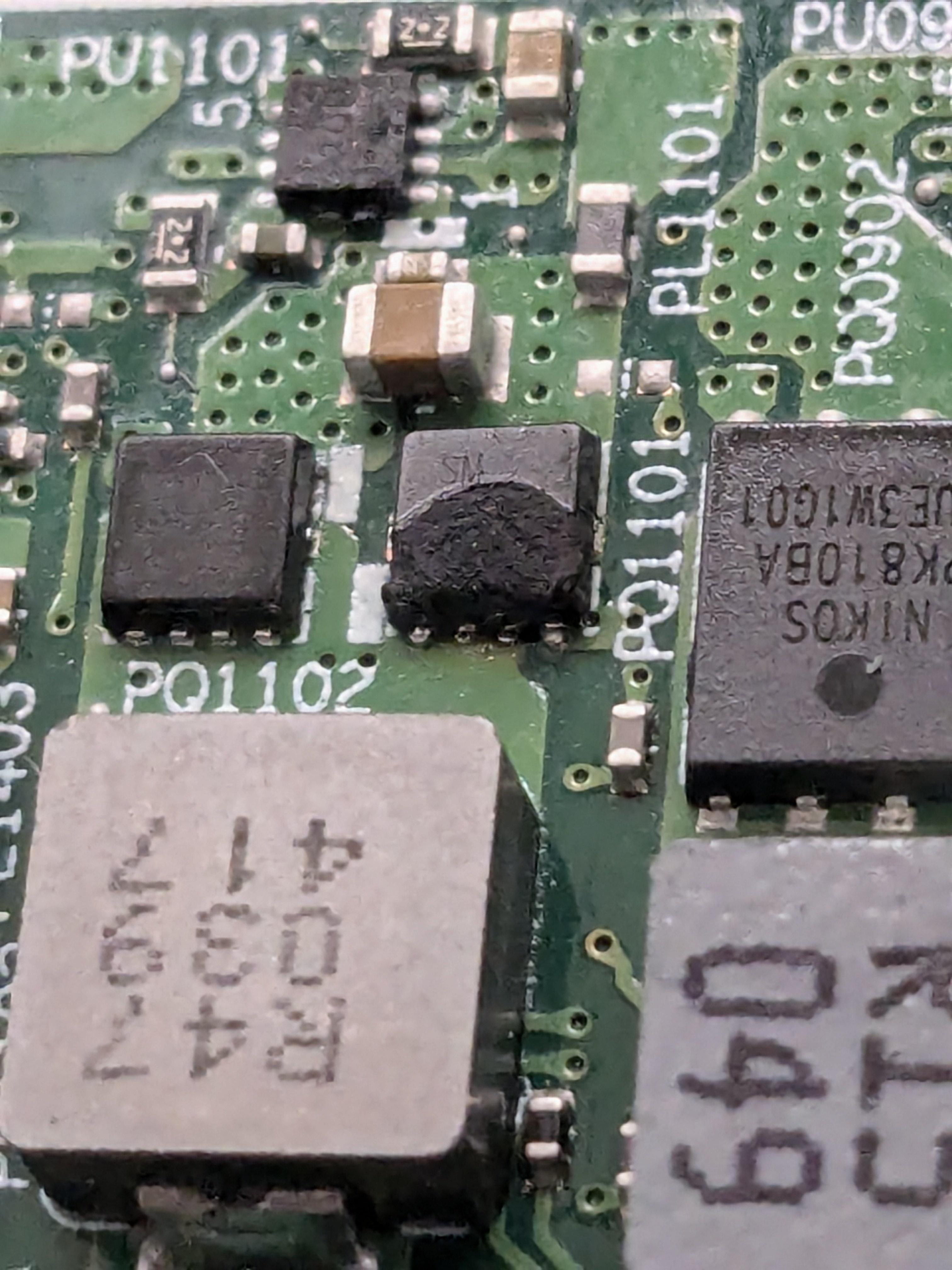

    Hello folks,
    I have an L15 Gen1 (NM-C631). It has all voltages so far, but not VCCSA.
    While searching I discovered the PQ1101 which burned down.
    I then soldered out the PQ1101 & PL1102 and the capacitors that come afterwards. Unfortunately there is a short circuit to GND (0.2ohms) on the pink marked line.
    Do you think the processor is broken? Or is it worth replacing the PQ1101?
    Schematic: Here!
  • danny34
    • Jul 2024
    • 49
    The picture is gone. I have uploaded it again in the attachment
    Does anyone have an idea?
    • reformatt
      • Feb 2020
      • 1410
      If the high side FET shorted, then you got 15V directly into the CPU. Pretty much game over at that point.
