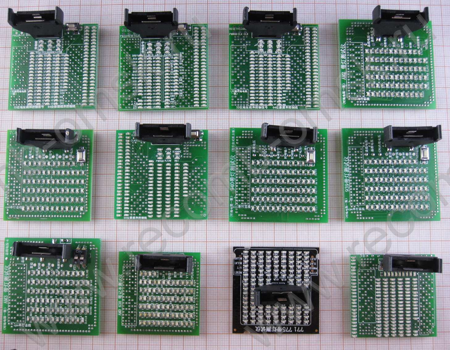

                                • dj_ricoh
                                  • Jan 2013
                                  • 2073
                                  • uk
                                  Re: Toshiba A205-S5825 regular shut down at start up
                                  Originally posted by loser18
                                  I didn't mean voltages of cpu regulator...I was talking about signals such a cpu reset or power good etc...I don't know about any other way than check socket pins themselfs...pretty sure there's no other way,lol...
                                  there is something like this
                                  i dont know if there is for notebook
                                  • loser18
                                    Yeah...I've seen those...You got tons of gadgets in China...
                                    They even selling kits for nearly all CPU's and mem's (also for laptops)
                                    Anyway...I think we hijacked this thread & the guy needs to fix his laptop,lol...
