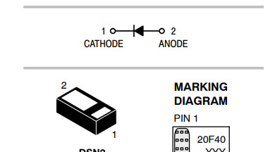

            Does anyone have a spare D3370 diode or point me in the right direction as to where i am able to purchase this one?
            Another thing which was strange was with the diode off the logic board i tried again to measure U3200 for signal PP20V_USBC_XB_VBUS at capacitor C3201 (PIN #1) but this time i was getting no voltage reading on the meter, i found that a bit of a odd one.

              NSR20F40NXT5G
              https://www.aliexpress.com/wholesale...psort=1&page=1
              https://www.mouser.com/ProductDetail...=NSR20F40NXT5G
              https://lcsc.com/product-detail/Scho..._medium=buyNow

                  I replaced Diode D3370 today onto the logic board and now I’m observing some different behaviors. CD3215 - U3200 is not taking any power at all, so, when i plug in the USB-C Charge Cable into the USB port associated with U3200 the USB tester shows me no voltage (so the USB tester will not turn on). I tested the signal at PP20V_USBC_XB_VBUS to clarify this by placing black probe to ground point and red probe at PIN #1 on C3201 (multi meter in voltage mode 200V) and i get 0V.
                  Now the other three CD3215's -U3100, UB300 & UB400 my USB tester is displaying fine and shows 5.21V - 0.25amps. I also measured the associated signals @ PP20V_USBC_XA_VBUS, PP20V_USBC_TA_VBUS, PP20V_USBC_TB_VBUS and all of them are measuring 5.1V so those ACE controllers are getting power.
                  To make sure the USB port was not bad i connected the USB-C Board over onto the other side of the logic board JB500 (FPC connector) and now when plugging in the USB-C Charge cable both ports are showing on the USB tester 5.21V - 0.25amps. So the ports on the USB-C Board are ok.
                  I am now thinking then this, might be on, now the U3200 actually being bad. What are your thoughts?

                  • mon2
                    • Dec 2019
                    • 14677
                    Re: Macbook Pro A1989 820-00850-a not powering on
                    Remove this diode and test again (without the diode).
                    Respectively, this diode has a polarity. Please be sure it is being soldered in properly onto the board.

                      I checked the diode polarity and also followed the position of the solder pads, one pad being larger than the other. So thats the orientation i'd used. Also to confirm when I had put the Diode onto the board, the Anode was attached to ground pad, (bigger pad) and the Cathode, attached to the PP20V_USBC_XB_VBUS side pad (smaller pad). Although do correct me if i am wrong on this?
                      I have removed the D3370 Diode as suggested and now the USB port connected to U3200 is working again, when plugging in the USB-C Charge cable the USB tester is turning on and showing 5.21V - 0.25amps., even better still i tested again PP20V_USBC_XB_VBUS at PIN #1 on C3201 and it is showing now 5.1V! However it does fail to negotiate 20V, stranger even more still was the first 2-3 times i plugged in the USB-C Charge cable after removing the Diode it did get to 20V but did take a while time wise to negotiate to this from 5V.
                      And after checking now again for PP1V1_UPC_XB_LDO_BMC that has also come alive, so measuring it getting now 1.1V at Capacitor C3204 at PIN #1.
