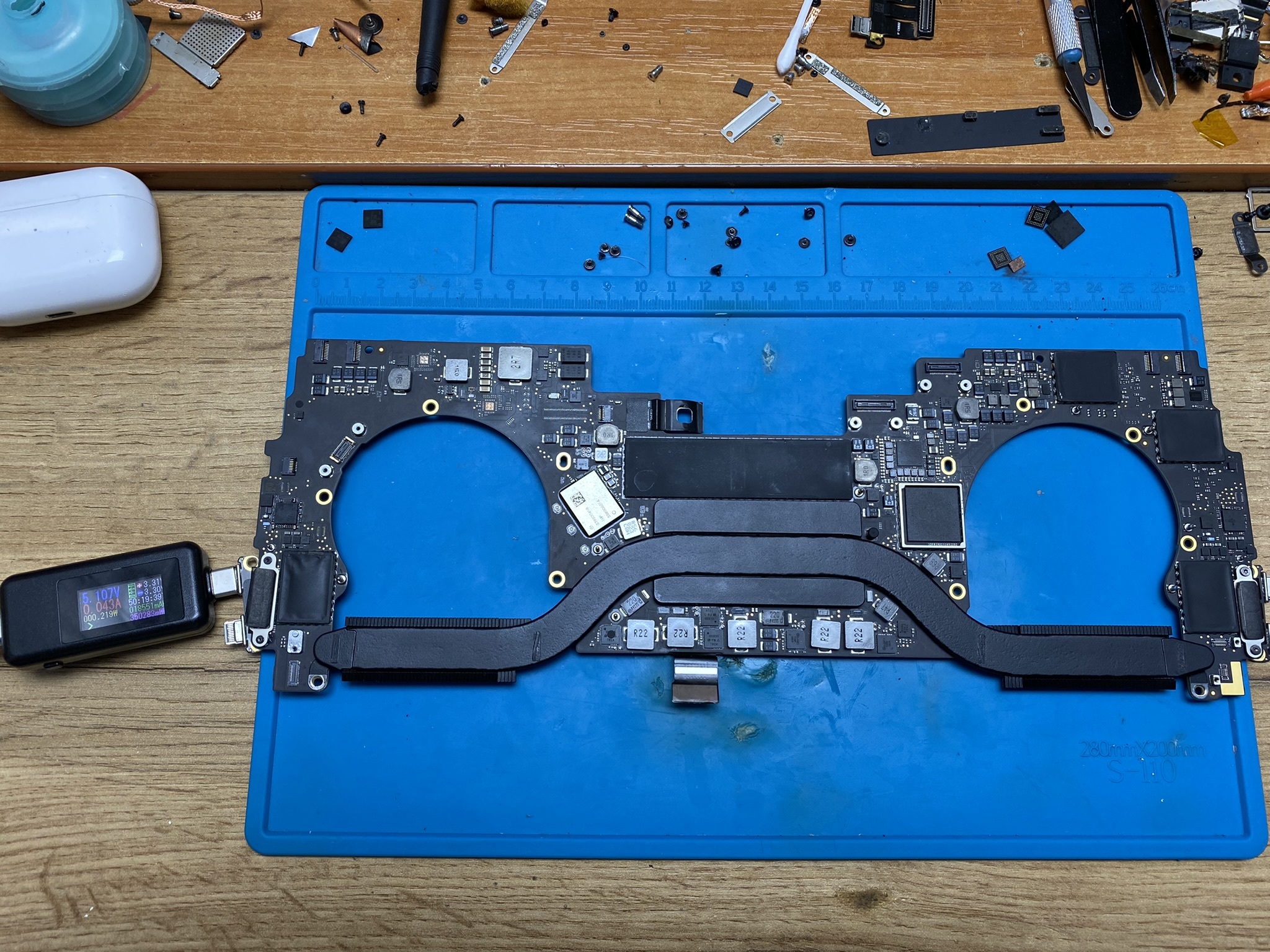

Macbook A1989, 820-00850, won't boot. 20V, 0A.
  • PITERPENY
    • Jul 2023
    • 455
    • Ukraine
    Today I have a MacBook A1989 at work 820-00850. When assembled, the laptop switches to 20 volts but the consumption is 0.00 ampere. if the motherboard is on the table then the consumption of all ports is 5 volts and0.35 amperes and does not go to 20 volts only if you assemble a MacBook.
    Here are some measurements, maybe someone can tell what the problem is.
    The initial problem was a burnt out induction coil L8504 (replaced).

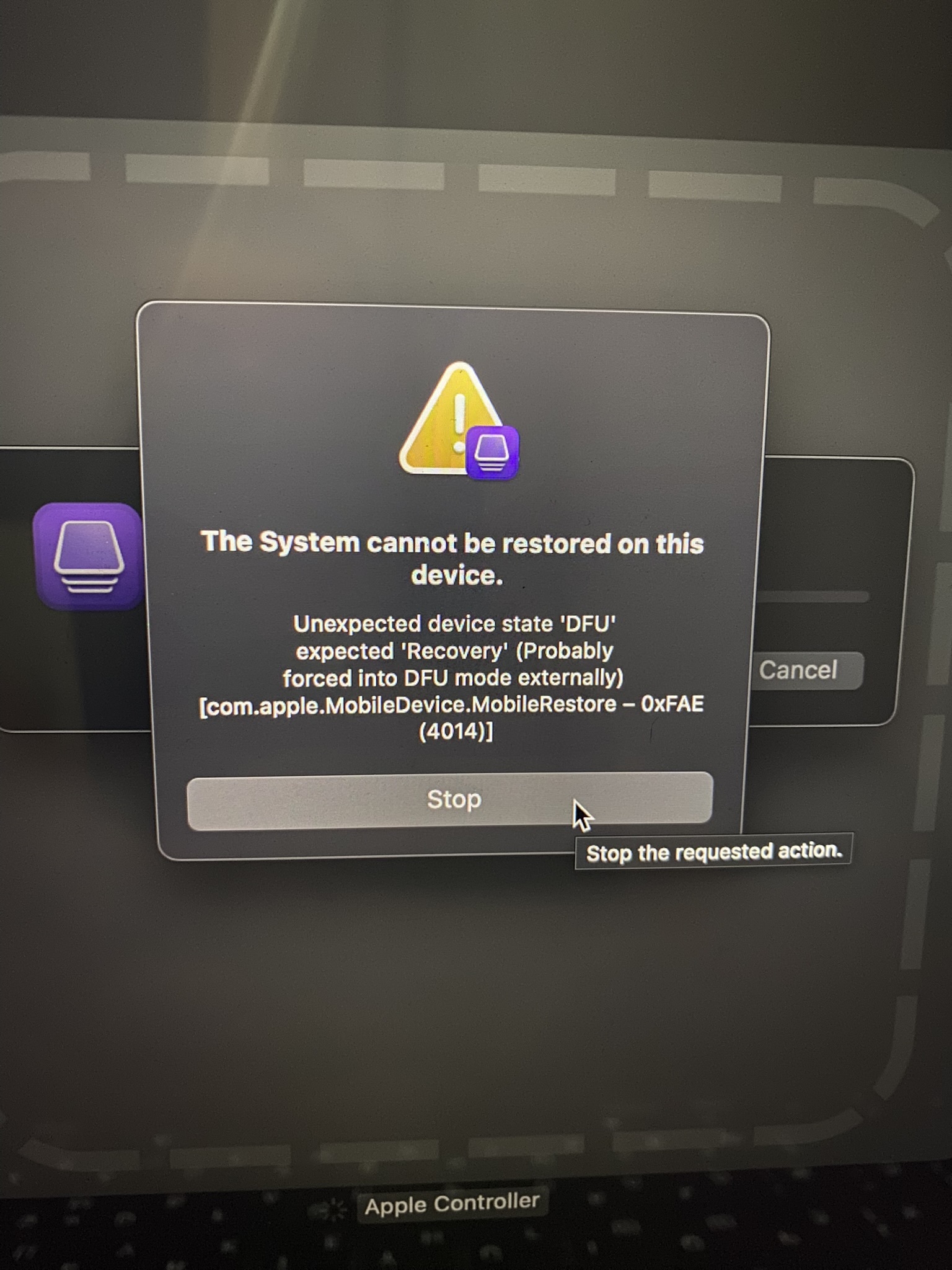

    When connected to another MacBook, it constantly hangs in dfu and cannot install updates, something is wrong.
    here are some measurementsmotherboard on the table).

    I bought another working but blocked board! and moved T2 and u4770 (juice rum, I think so) to the blocked board, and the blocked T2 and u4770 to the board that is being repaired, so I have 5 boards with the same 5V symptoms and fluctuating values from 0-0.450A! what's wrong ?
    • PITERPENY
      • Jul 2023
      • 455
      • Ukraine
      Did I transfer everything correctly or is something else needed? and do I need to transfer the u4770 or just the t2? both boards are not visible in dfu
