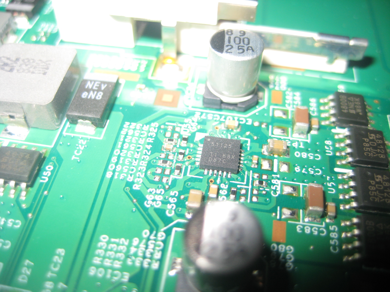

    I have on bench a Acer 5535 that doesn't power on and has the TPS51125 chip heating up. I don't think the problem is the chip itself.
    I have checked it and I get 19V Vin on pin 16, but I'm only getting 2.35V on VO1 (pin 24) instead of 5V, and get 0V in VO2 (pin 7) instead of 3.3V.
    Talked to a friend and he asked me to check if resistance is higher than 10ohm from VO1/2 coils to ground. Resistance is around 170ohm on both coils so I assume that's not the issue..
    What do you guys think? Should I remove the chip and check if voltages appear or should I check somewhere else before removing anything?
    Help appreciated.
    Thanks.

    NEVER start the notebook without the tps51125 or any other smps chip because you risk sending full 19V on the 5.5v and 3.3v rails ending in blown chips all over the board (same mistake i did) beacuse the gates from the controled mosfets will not be connected to anything.
    first thing check for shorts on respective mosfets : u24, u25, u48 and u49.
    if they are ok then change the tps51125.

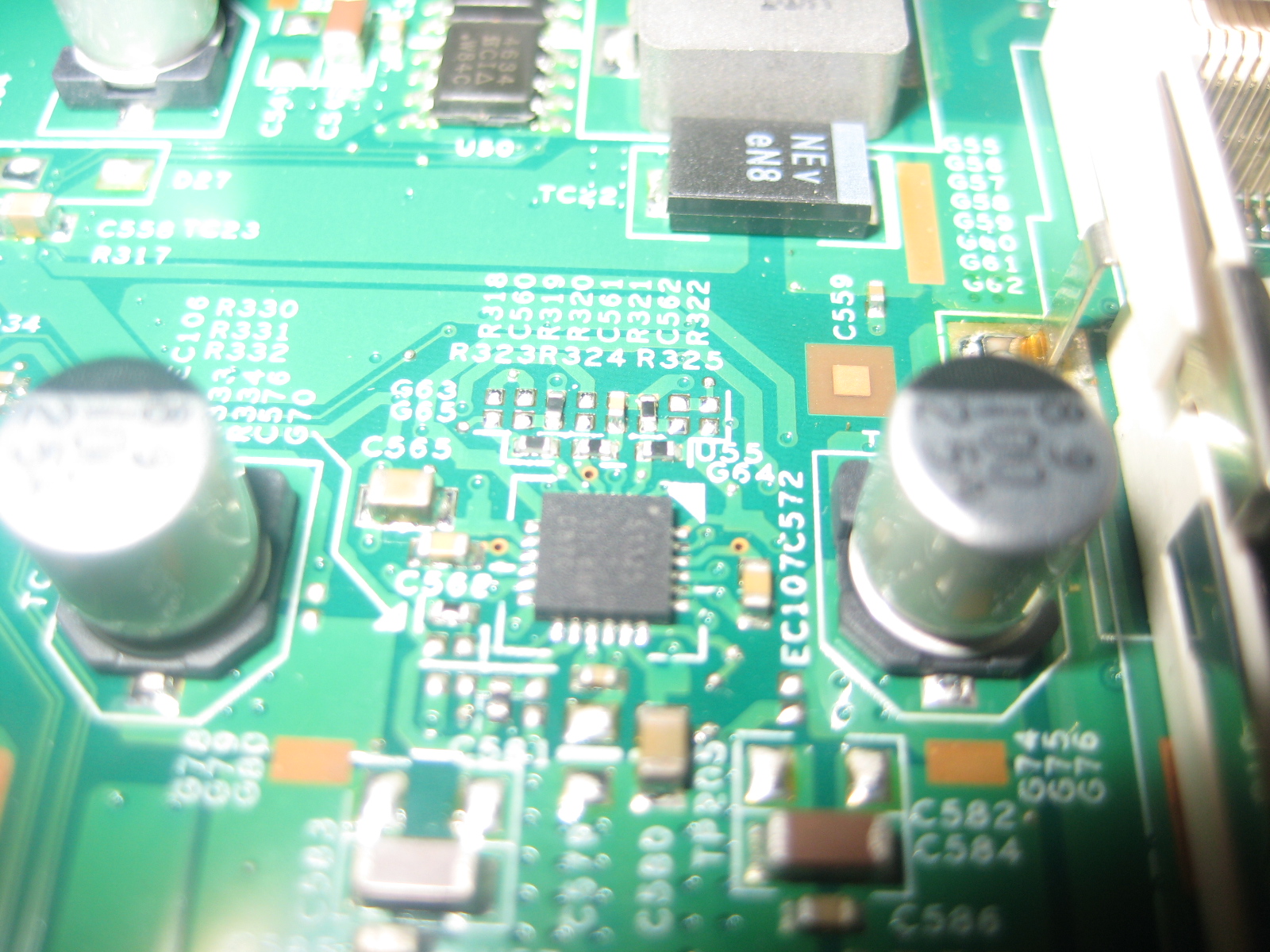

                      I'm having difficulty soldering the TPS chip. It would be great if you help out with some tips.
                      https://www.badcaps.net/forum/showpo...4&postcount=12
                      Thanks.
                      Galaxy S6 Edge x2 (Gold&White)
                      Asus GL552VW-i7 6700HQ|GTX 960M|15.6"FHD|16GB DDR4|512GB M.2 SSD+1TB SSD
                      Clevo W230SD - i7 4710MQ|GTX960M|13"QHD+|16GB DDR3L|500GB+256GB mSATA SSD+1TB HDD
                      Try Harder!
                      • bushie
                        • Dec 2013
                        • 57
                        • Romania
                        Re: Acer 5535 no power
                        it'snot that difficult.as i see you watched some tutorials.thats good.if you think you can't get it soldered with only the hot air gun try solder each pad one by one.it wont take that long.solder paste is good but as a tip(if you will use hot air gun),change the solder with some lead solder if you have ,watch the solder on the pads to be relatively even and most important do not put much solder paste(flux) underneath the chip,it will bounce it off the position when it will melt and starts boiling under the chip.put some solder paste on the pads than wipe out the excess with your finger so that will remain very very little paste on top of the pads.verify it after so you dont have a shortcircuit .hope you get it right.succes.sry for my english.
                        • lezsimply
                          The Wanderer
                          • Jan 2013
                          • 657
                          • Philippines
                          The first time i installed qfn like tps51125 it blew up, actually 2 times on 2 different laptops
                          I was using hotair station and I was having a hard time placing and realigning them.
                          After so many tries, I managed to be more confident about it. At first I make sure the pads are flat but with small amount of solder then a good solder flux. I use magnifying glass to solder 1 pin on both sides using soldering iron, once I confirmed that all pins are aligned that is when I use the hot air. make sure air flow will not blow the chip away
