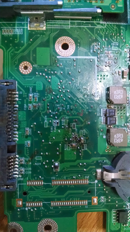

    DAUM3BMB6E0 Rev:E (Inspiron 1464) [It's able to power on but no more]
    I only have to change the hard drive and it was working before that, so after disassembling it, I noticed a part with some rust, I cleaned it out with IPA.
    Now, the power on LED lights on after pressing power button, but CPU fan does not move at all. I checked the BIOS pins 3,7,8 and they had 3.3V. Anyone care to lend me a hand?

    Re: DAUM3BMB6E0 Rev:E (Inspiron 1464) [It's able to power on but no more]
    Solved, cleaned it better this time around and desoldered the rusted capacitor and put in another one with unknown values and I think it's different sizing too.
