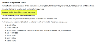

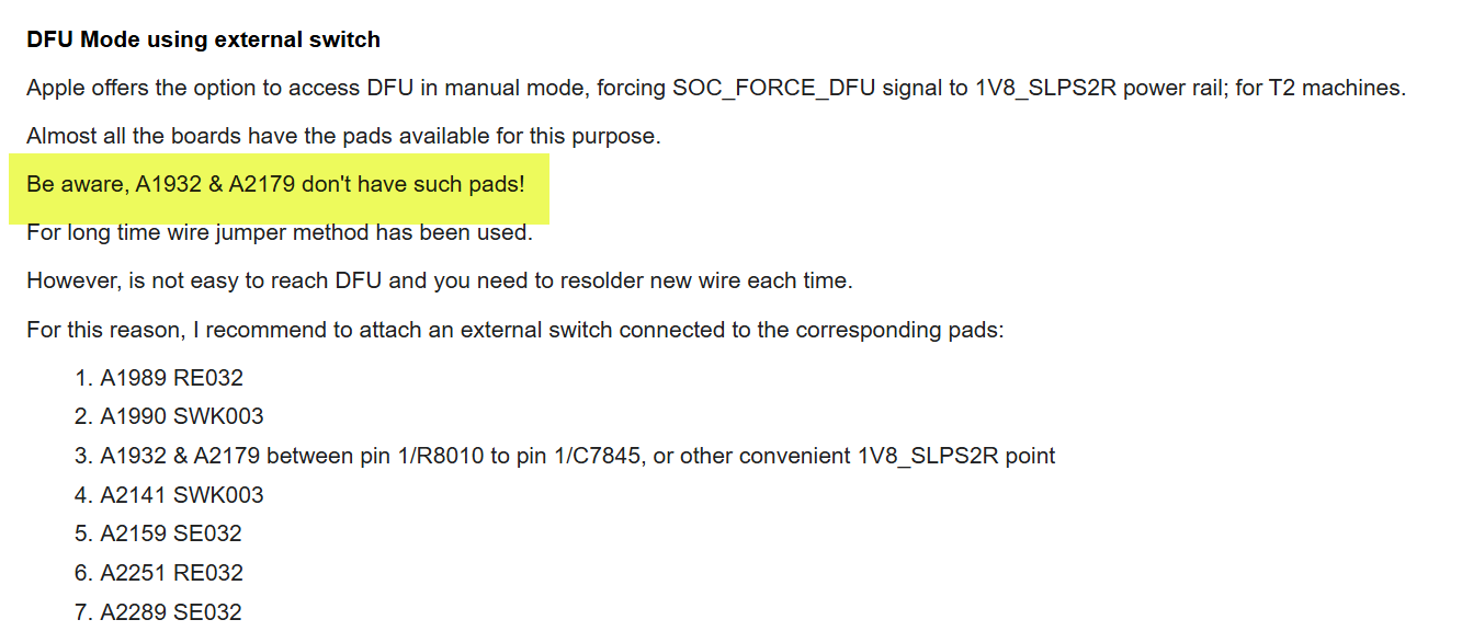

                • mon2
                  • Dec 2019
                  • 14677
                  The rails are not shorted but not on.
                  Try a DFU.
