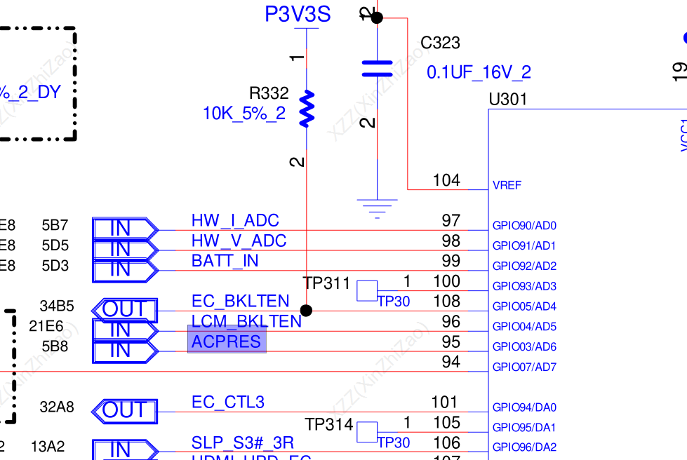

    Hi there,
    I have a DK10FG-6050A2491301-MB-A03 motherboard with missing ACOK voltage. Here are the basic voltages of BQ24725A. The motherboard is dead with no signs of life.
    ACN : 19.35V
    ACP : 19.36V
    ACDET : 2.7V
    REGN : 5.916V
    VCC : 19.36V
    Diode mode to ground reading on ACOK rail is 0.450V on pin 1 of R6013 and 0.230V at pin 2. Replaced BQ24725A a couple of times. Still no luck.
    The problem was that I was not having 3.3V/5V from the TPS51225 regulator. So I tracked down to the BQ24725A which was missing the ACOK voltage needed to turn on the EC. As per my knowledge, ACOK should be 3V. Am i missing something ?
    Any help would be appreciated. More details can be shared as we move along for diagnostics.

      You are likely on the wrong path here.
      First counterargument: ACOK is not even used (left floating) on some devices, so basically inconclusive then.
      Second counterargument: if ACOK is pulled up by a 3.3V rail instead of REGN, then it is inconclusive too, since without a working 3.3V, ACOK can't be HIGH.
      Sounds logical, doesn't it?
      If i have to bet, i'd say your embedded controller is either shorted or simply not powered with (the same) 3.3V.
      EDIT: Did not look into the schematics, but regarding what mon2 shared, it seems you have indeed to move to the 3.3V LDO and the corresponding Enable (EN0).

        1) it is late for you.
        2) yes, U6100 must be enabled to create the pull-up voltage needed by the resistor @ R6013 which is camped onto the open-drain circuit @ ACOK. If the ACOK line is floating when the charger IC believes the adapter voltage is OK, someone needs to pull-up this floating line to park it. This voltage is from U6100 (P3V3AL).
        PAD6100 shows that this same voltage is linked to VRP3V3A.
        3) With no power to the board / no battery - what is the RESISTANCE to ground of L6100? This rail must be enabled through EN_3V_5V.
        What is the voltage to ground of EN_3V_5V?
        U6100 IC datasheet:
        Dual-Synchronous, Step-Down Controller with Out-of-Audioā„¢ Operation and 100-mA datasheet (Rev. E)
        ACOK = ACPRES and used by U301 (EC)

          @ Sephir0th,
          Thank you for sharing your knowledge. I would like to point out something that i found about the ACOK in the datasheet for U6000.
          "ACOK : AC adapter detection open drain output. It is pulled HIGH to external pull-up supply rail by external pull-up resistor when voltage on ACDET pin is between 2.4V and 3.15V, and voltage on VCC is above UVLO and voltage on VCC pin is 275mV above voltage on SRN pin, indicating a valid adapter is present to start charge. If any one of the above conditions can not meet, it is pulled LOW to GND by internal MOSFET. Connect a 10kΩ pull up resistor from ACOK to the pull-up supply rail.."
          This led me to believe that the ACOK voltage is being generated by U6000 and send to enable the SIO.
