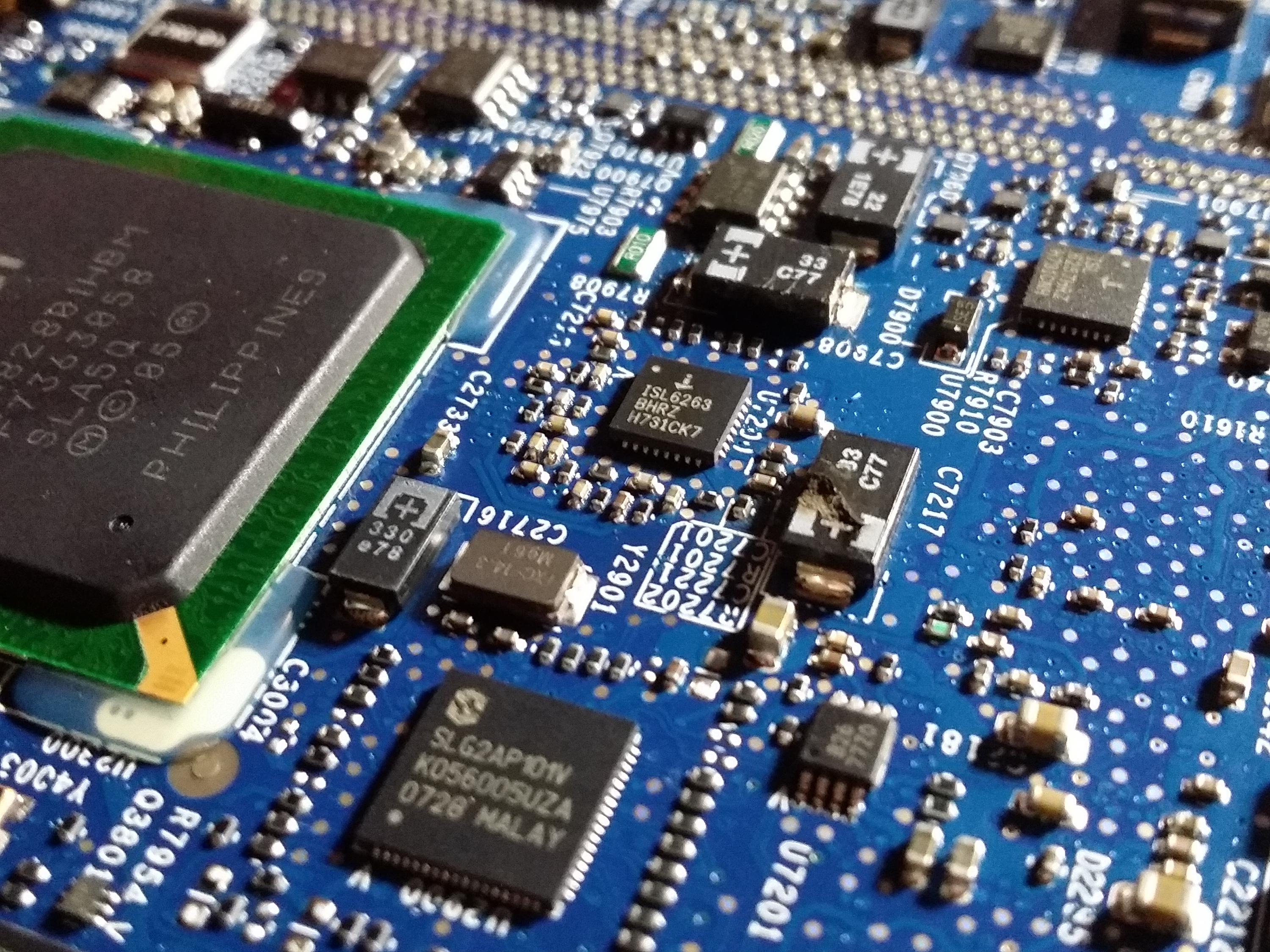

    Hey guys, I recently received a macbook that will not turn on, turns out the tantalum capacitor near isl6263 had spontaneously combusted, anyone have any idea how to fix this one? Seems like it does some kind of filtering for the isl chip, the board also emits a barely noticeable high pitched whine near the single SMT poly cap. Can anyone identify the rating of that capacitor? From what I read of some half complete specs it looks like a 0.033uF tantalum.

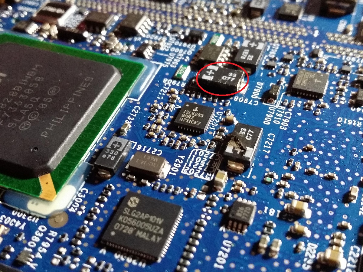

    it is the same as this one

      first mac that i see has component code near them, as all new model dont have any code near, but u have to tracer the line to see what component is that and see on the schematics.
      however:
      C7217
      CRITICAL
      33UF
      20%
      16 volt
      poly
      CASED2E-SM
      hope it helps

        Thanks, so im assuming it wont start without it haha, I was having a few problems finding the exact component. Thanks for all the help guys! Ill order a replacement and see how I go.

            Hey, replaced it with a 28uf, yeah i know its bad, but its all i had on hand, also had a blown ceramic fuse that i replaced, it boots now but the 3.3v rail fluxuates at around 3.4v, it boots to a white screen and the keyboard buttons do nothinf, any ideas?

              Crap, nevermind, folder icons came up, it looks good
