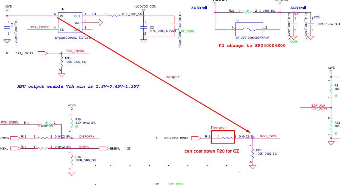

    On the s145-ast lenovo laptop with nm-c171 rev:1.0 motherboard, the image appears without illumination. When I look carefully, I can see the lenovo text. I downloaded the bordviewer and the schematic from the badcaps family, but which voltages should I measure? 20 volts come out from both ends of the fuse.

    Measure this pin voltage on JEDP1 :
    1) +LEDVDD ( 19v )
    2) DISPOFF# ( 0v = active low )
    3) INVT_PWM ( 3v )
    4) LCDVDD_CON ( 3v )
    but before doing that. if it's me, i'll try with another lcd

        INVT_PWM ( 3v ) There is no voltage on this pin. There is no 3v signal. There are other voltages you mentioned.

          If you brave enough, remove R19 and make jumper on invt_pwm side from 3vs. But make sure no short on invt_pwm pin

            its can be backlight lcddriver

              Does pin 4 (EN) of U7 have a voltage? U7 may be defective.

                There is no short circuit, but how should I do it? Can you give me some more information, where is r19?
