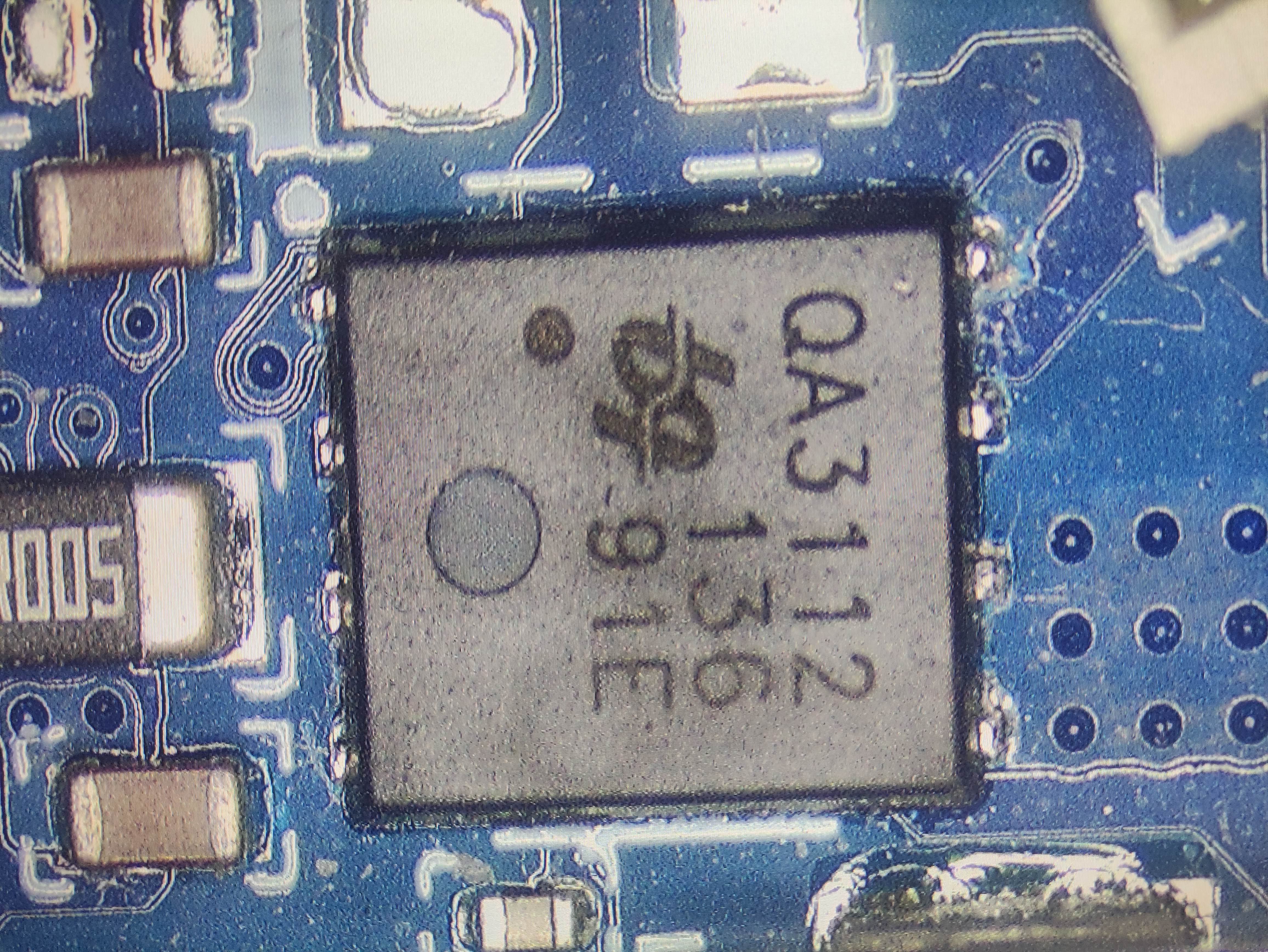

    Will do but can you show me where Source & Drain are on this chip as it has 2 gates and 3 pins one side and 3 on the other. Thanks.
    • mon2
      • Dec 2019
      • 14677
      #42

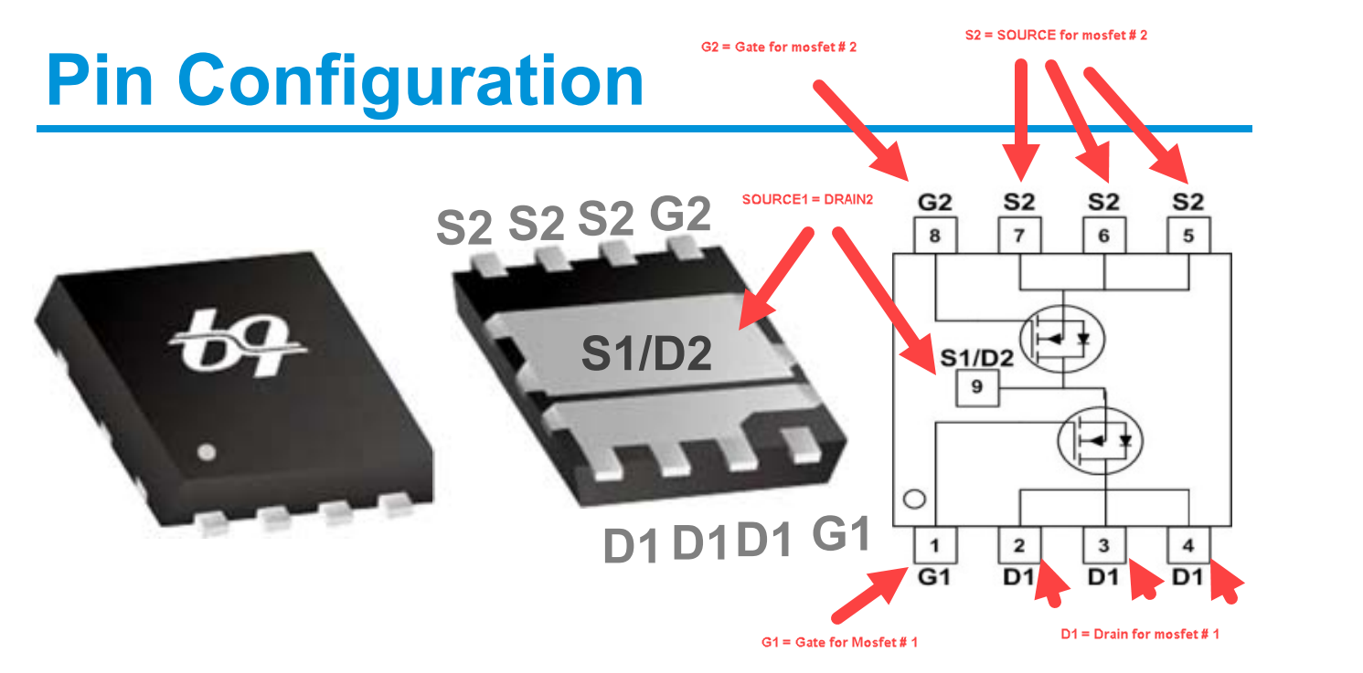

      Sure - see attached. Get a bearing of pin # 1 and locate the belly pads that will be visible on the North and South of the body as shown in the datasheet here:
      Pin # 1 = DOT / DIMPLE = Top Left of the mosfet and the first pin is the G1 pin. Then count in a 'U' counterclockwise direction for the rest of the pins.

        OK thanks for that. 😀
        Source to Drain - 43K ohms
        Source to Gate 1 - 78K ohms
        Source to Gate 2 - 2.4M ohms
        Gate 1 to Drain - 1.34M ohms
        Gate 2 to Drain - 4.7M ohms.
        • Darren Hibbert
          • 116
          #44
          Just found another MOSFET below the one I just measured (with a coil between it) and its exactly the same QA3112
          Source to Drain - 1.2M ohms
          Source to Gate 1 - 1.5M ohms
          Gate 1 to Drain - 180K ohms
          Gate 2 to Drain - 3.6M ohms.
          • mon2
            • Dec 2019
            • 14677
            #45
            The measurements with kohms are of concern. I would consider to source some spares and replace these parts. You can also flux each (make a note of their location #1 position first); remove off the board and then test each when the parts are on your work bench. Confirm is the measurements remain this low.

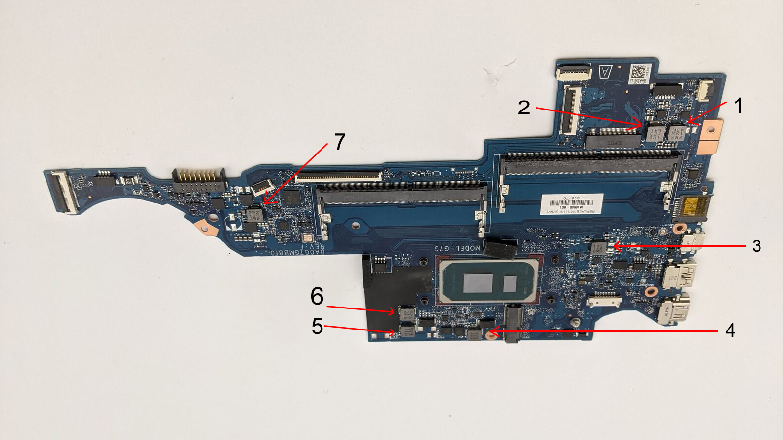

                            #53
                            No text and no backlight.
                            7 inductors on the board.
                            1 - 0.5K ohms
                            2- 1.10K ohms
                            3 - 37K ohms
                            4 - 0.8K ohms
                            5 - 0.7K ohms
                            6 - 0.7K ohms
                            7 - 36K ohms
                            • Darren Hibbert
                              • 116
                              #54
                              Board with the inductors numbered.
                              • Darren Hibbert
                                • 116
                                #55
                                Seems a bit low to me but then I don't really know anything about this.
                                • Darren Hibbert
                                  • 116
                                  #56
                                  Can anyone help?
