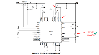

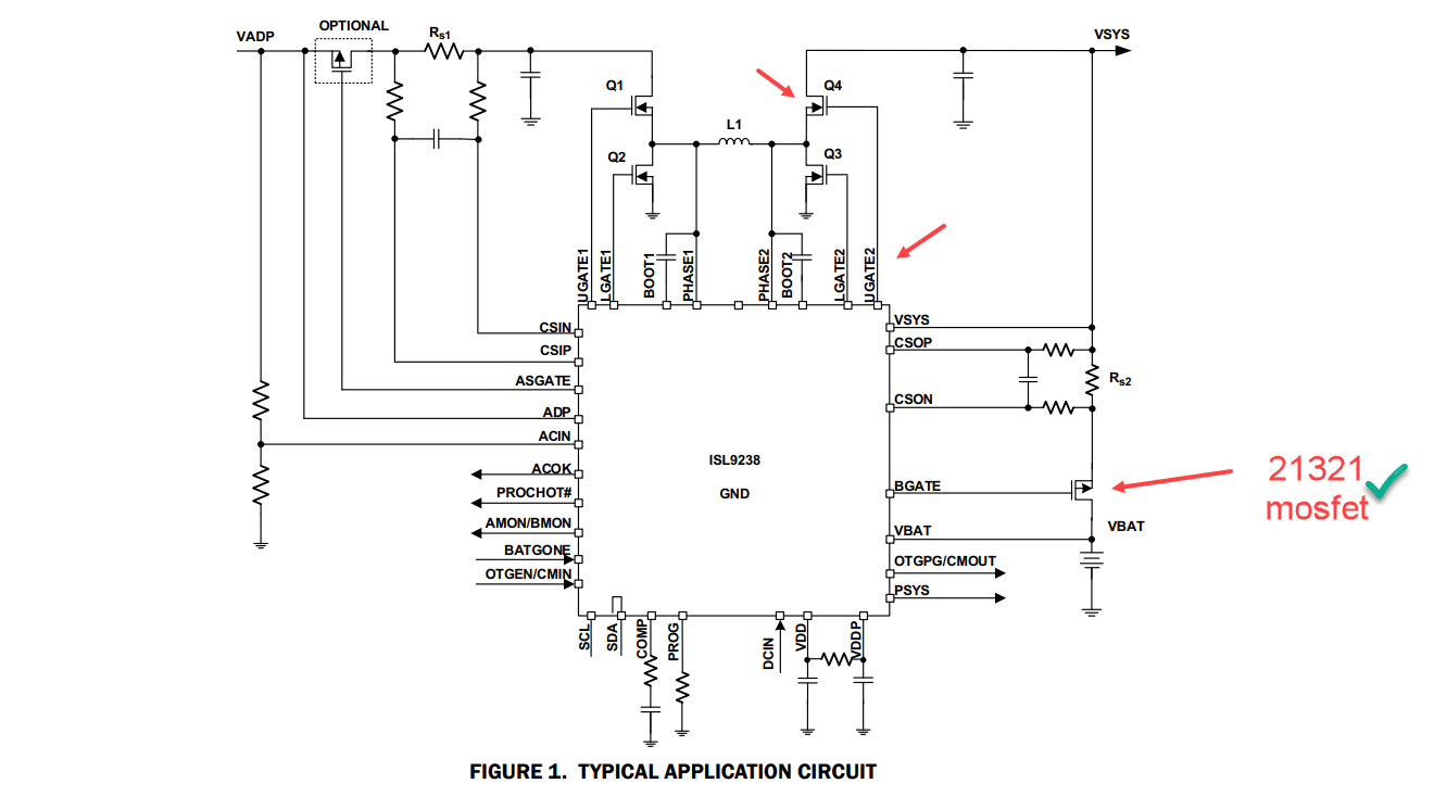

    Meter in resistance mode. Measure the resistance from pin #4 (gate) of each of these mosfets to pin #32 of the charger ic. We are trying to locate which one of these mosfets is being driven by the charger ic (BGATE).
    • Darren Hibbert
      • 116
      Ok so Pin 32 to Gate of the 21321 MOSFET is 0.3 ohms
      Looking at that other MOSFET I sent a picture of, I just noticed it has 2 gates so maybe I never measured that one properly. Hopefully the 21321 MOSFET is the one we are looking for.
      • mon2
        • Dec 2019
        • 14677
        Yes, 21321 is the battery mosfet and the resistance check looks to be ok.
        Here is the datasheet for this P-channel mosfet:
        AONR21321 Datasheet | DigiKey
        Locate the high side mosfet driven by the same charger IC. We are hunting for a mosfet that is possibly leaking. The other mosfet found in the earlier post looks to be low in resistance and is a suspect. Review where the pin # 4 of that mosfet travels to the charger IC. It is possible that there will be a current limit resistor between the charger IC pin and the mosfet's gate pin.

          Ok pin 4 of the top (there are two) QA3112 goes to pin 7 (LGATE2) of the charger IC.
          • Darren Hibbert
            • 116
            Pin 4 of the bottom MOSFET goes to pin 9 (LGATE1)

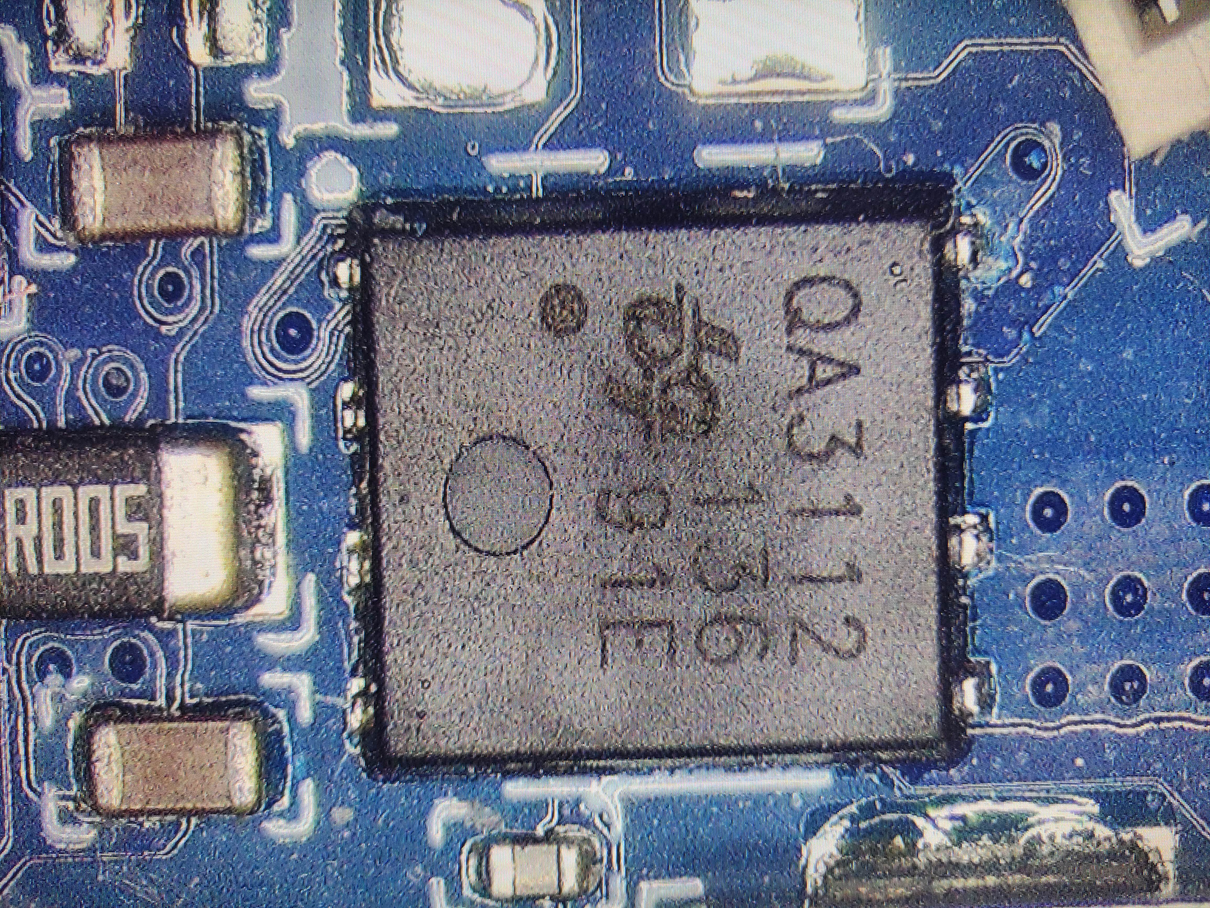

                Continue to hunt for the mosfet mated with the UGATE2 pin on the charger IC using the same method. One meter probe on UGATE2 pin on the charger IC; other meter pin on pin # 4 of the mosfet.
                Once that mosfet is located, proceed to test that mosfet using resistance mode (if manual mode meter, use a higher resistance scale). If you read 'OL' = over limit, switch to a higher resistance scale on the meter.
                Measure the mosfet as follows:
                source (1-2-3) & drain (5-6-7-8)
                source (1-2-3) & gate (4)
                gate (4) & drain (5-6-7-8)
                Post each measurement.
                • Darren Hibbert
                  • 116
                  Ok so UGATE2 of the charger IC goes to the MOSFET in the picture. I'm a little confused by it as it does not have a 1234 drain. Hopefully I've measured right but I'm unsure of the different layout of pins on this chip compared to your traditional MOSFET.
                  Here is what I got with my effort -
                  Source to drain - 0.9 M ohms
                  Source to gate - 3.6 M ohms
                  Gate to drain - 500 K ohms.
                  • mon2
                    • Dec 2019
                    • 14677
                    #29
                    Good point and bad assumption on my part. Consult the datasheet and measure again to hunt down the respective gate / drain / source pins for this dual mosfet.

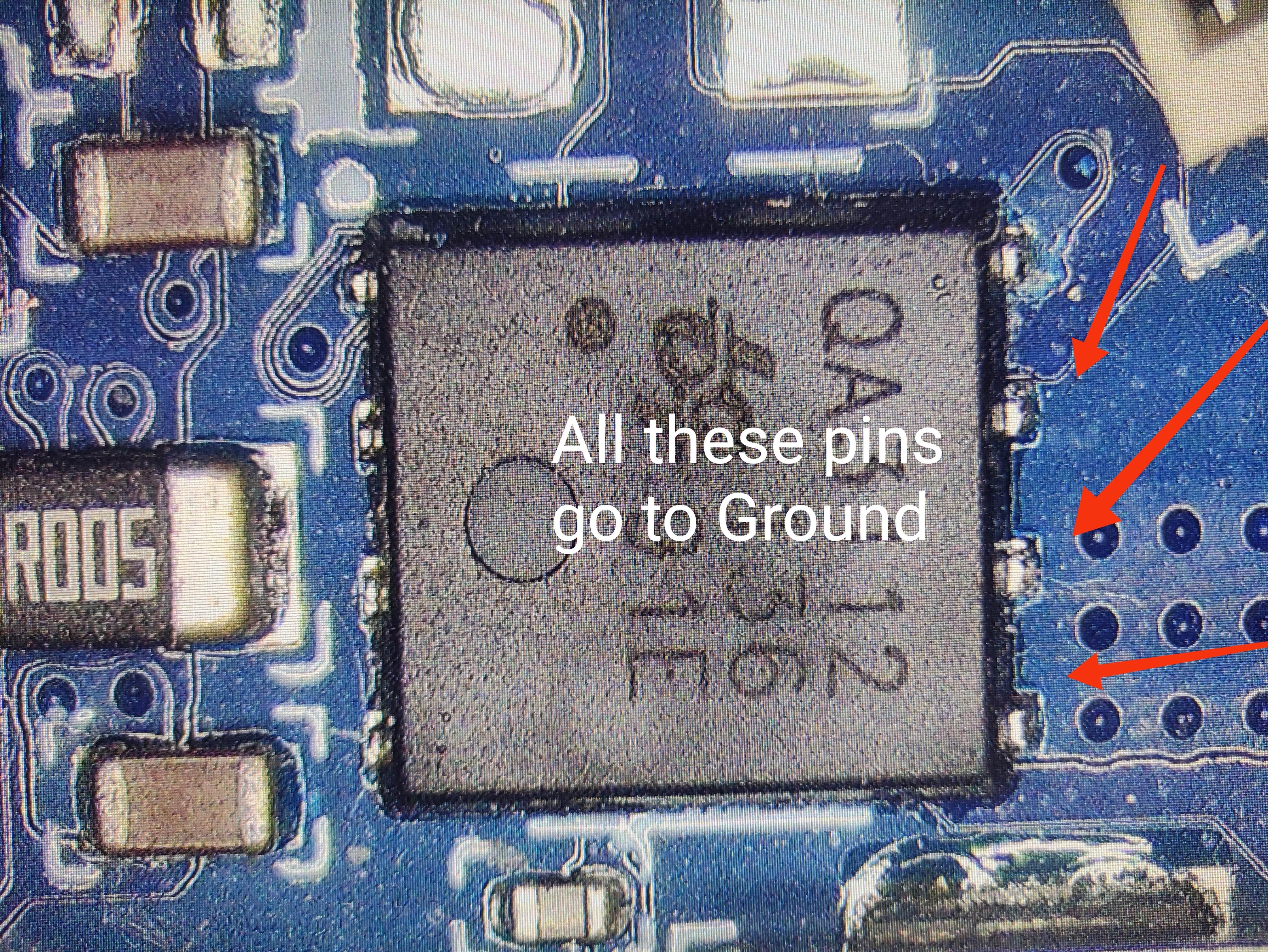

                      I checked the 3 pins on one side of the mosfet and they all go to Ground 🤷 (see pic)
                      The 3 on the other side obviously don't. The datasheet shows 3 Source pins and 3 Drain pins. 3 of these pins are grounded so I assume that MOSFET is shorted to ground?
