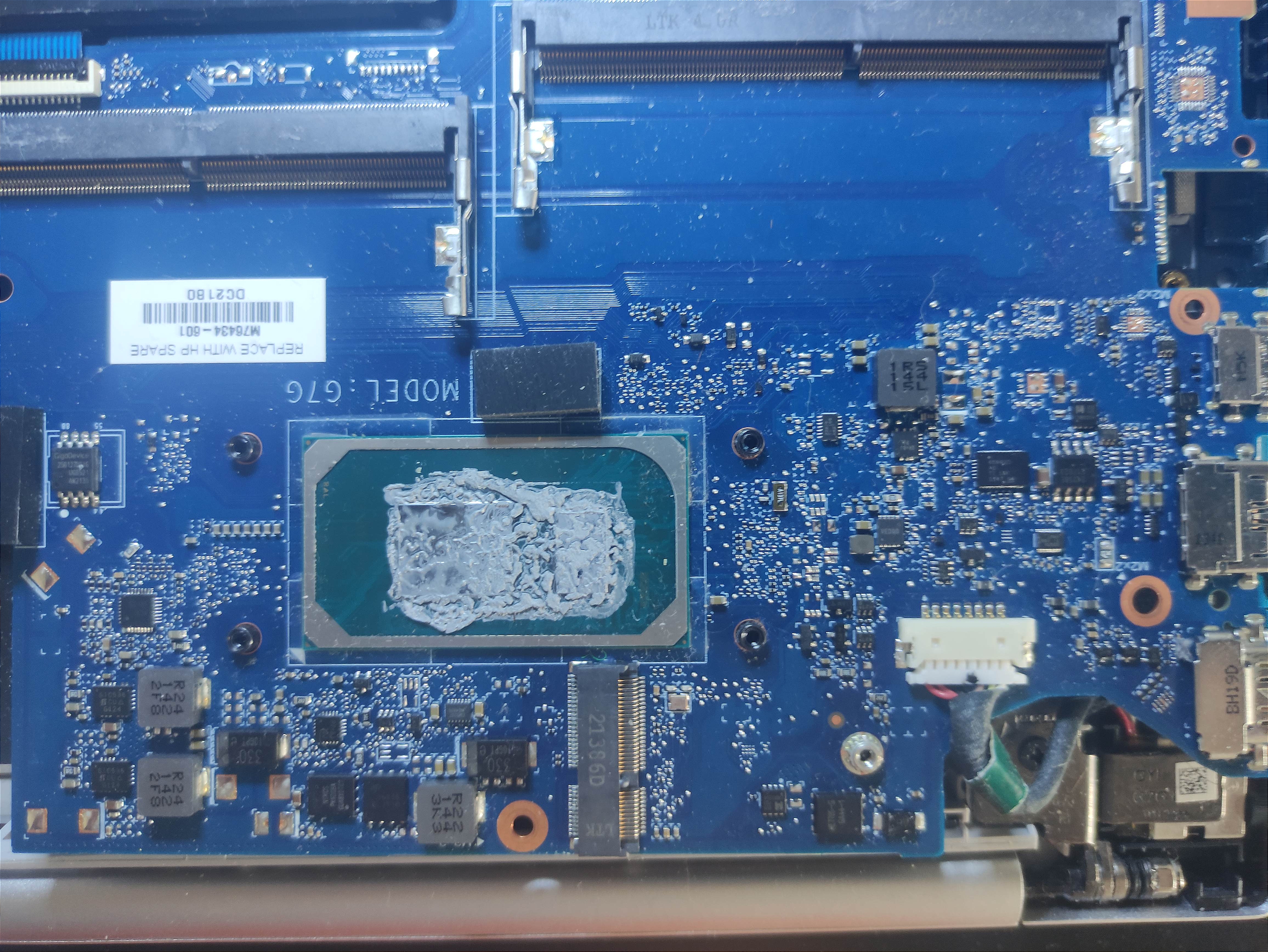

      Unable to locate a schematic for this unit so you will have to be our eyes. Locate the DC in power connector and share pics of the region. Nearby should be 2 x DCin mosfets + charger IC (perhaps the BQ series). Post the top side markings for the DCin mosfets and the battery charger IC.
      We need to review against public schematics the operation of the battery charger IC. Then, with no power to the board, measure the resistance to ground of the main power rail. Checking for a low resistance of the main power rail which indicates a shorted component causing an excessive current draw to power down the board.

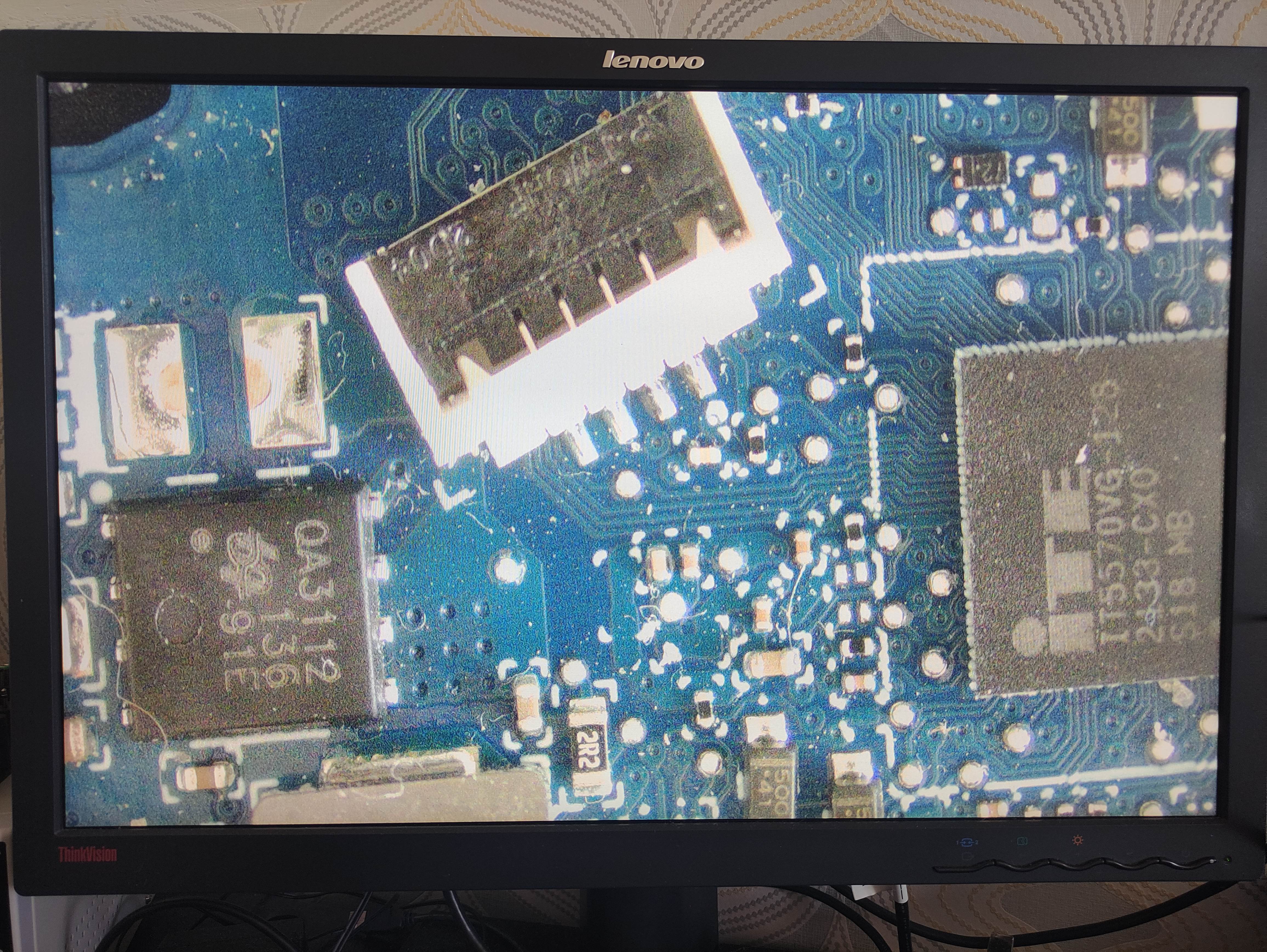

        Here is a picture.

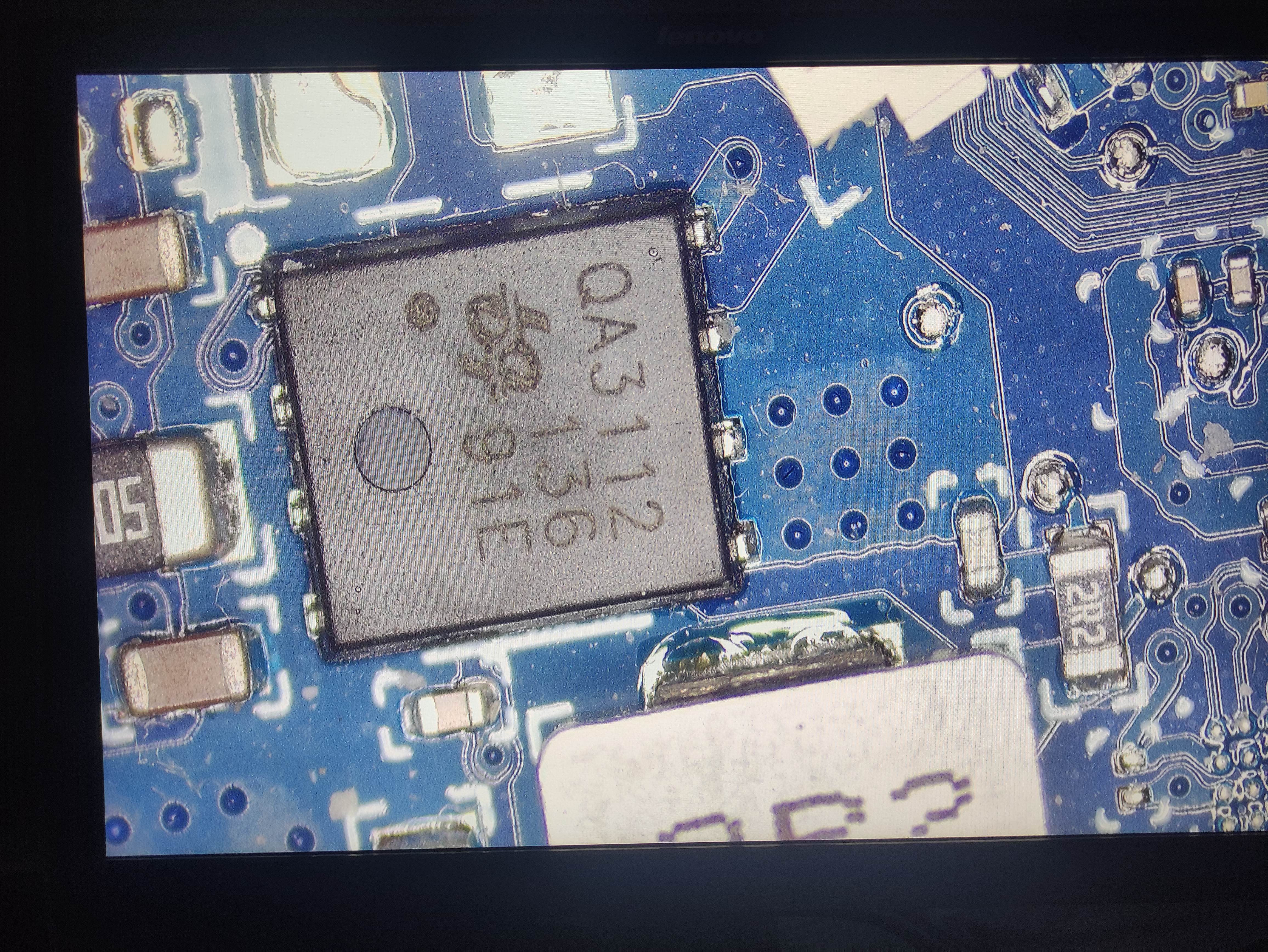

                No BQ chips found but found 2x QA3112 chips.
                Other side of board only has an ITE chip and a load of caps.

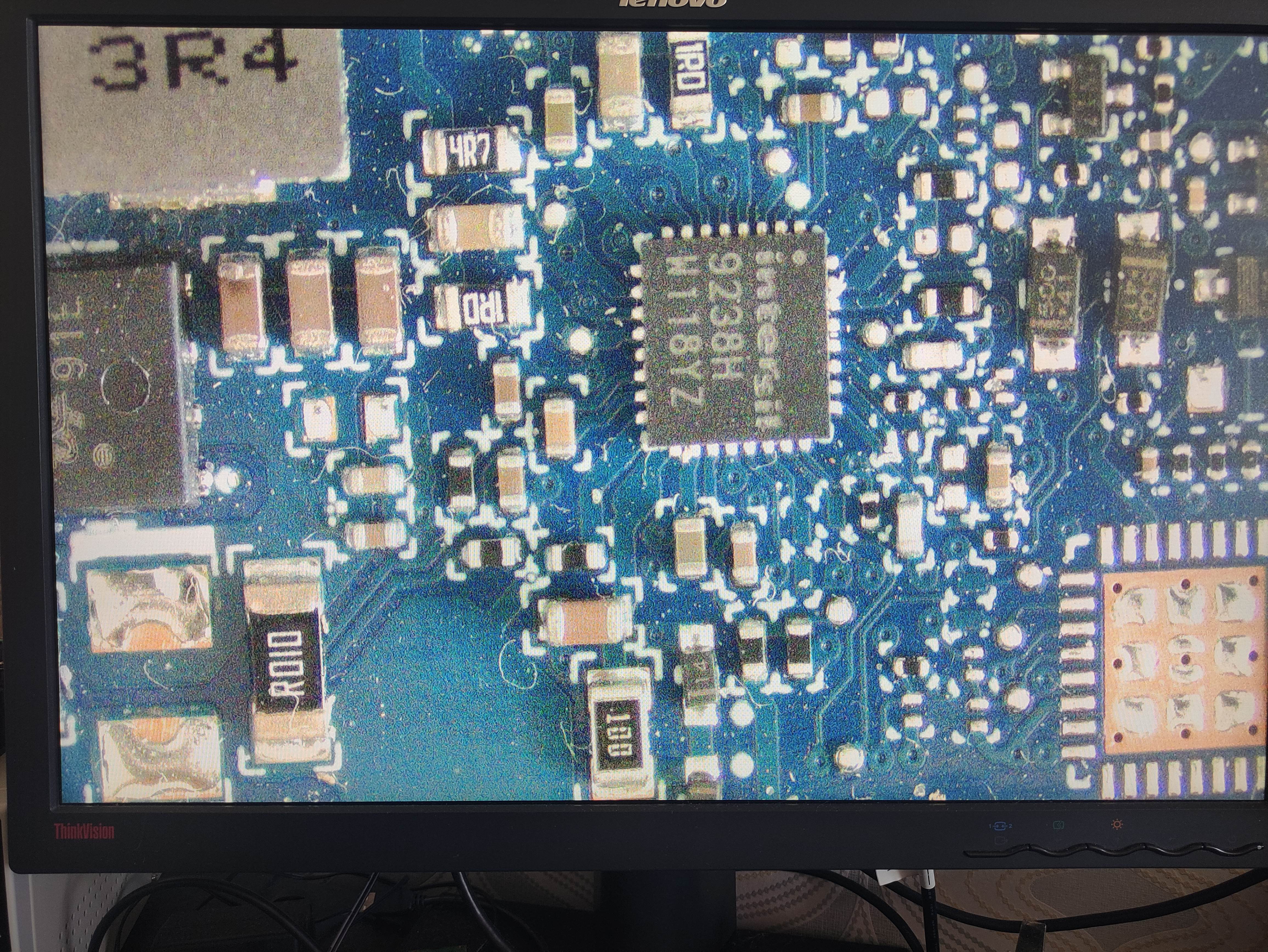

                      The shared pic is not very clear. Unable to read the topside markings of the semiconductors that may be the charger ic. Locate each square IC with pins on each of the sides. Post their topside markings. One of them must be the charger IC. Will be near the battery connector.
                      If you are missing the 3v3 rail, this may be another nearby ic and will be found by a local inductor with 2 leads. Each power supply is often fitted with an inductor if a switching power supply. Again, you are our eyes on the board. Could not find the schematics for this model.

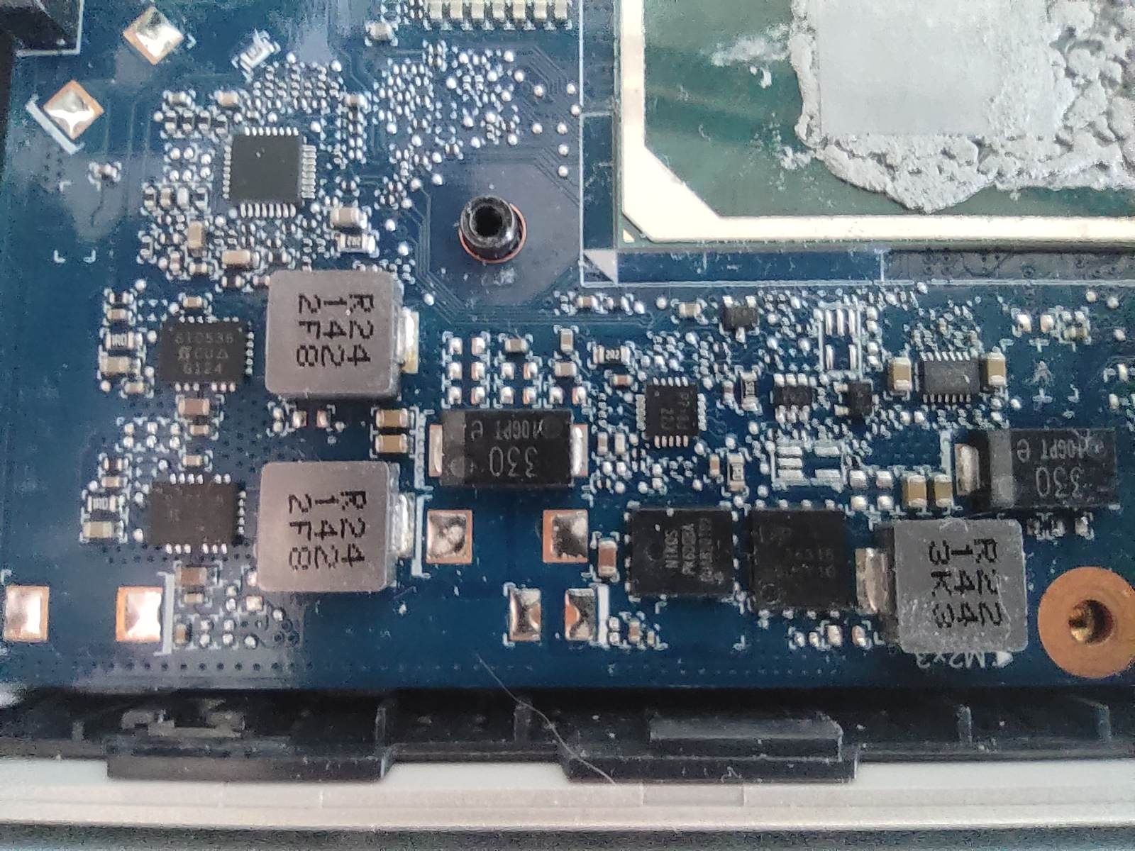

                        Most of the newer boards have +3V/5V rail as suspended.That means they will be available only after power on. Give a clear pic of +3V and +5V area.
                        Dont rush with voltage injection. Its not a kids play and often leads to damage if you dont understand the consequences very well.
                        Give a clear pic of the 3 inductors which are buzzing. I bet they must be related to CPU vcore and /or VCCGT. These coils are expected to show very low resistance to GND.
                        Measure the exact resistance to GND on those 3 coils. No power attached,meter set to 200 ohms(and not in diode mode).

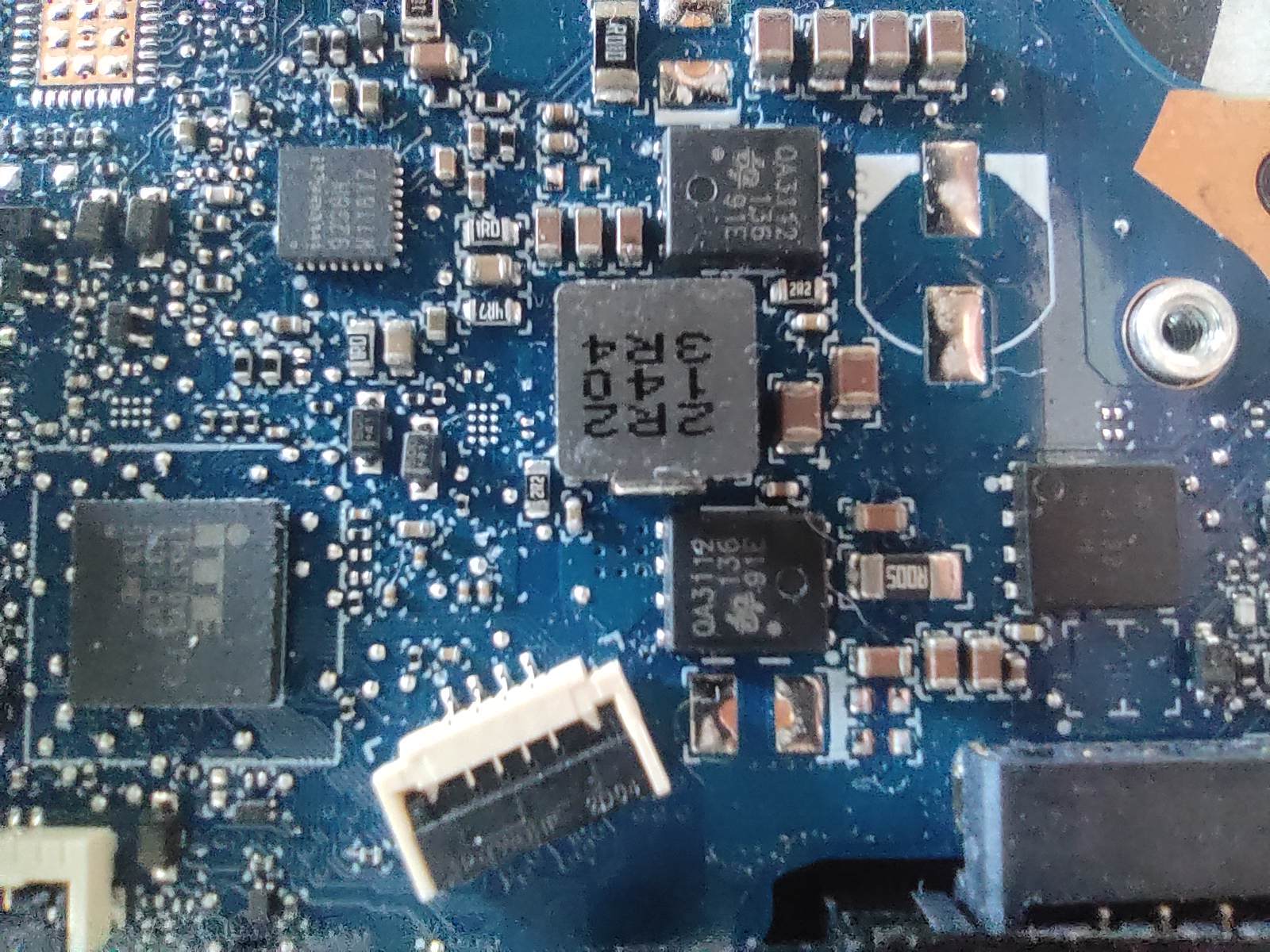

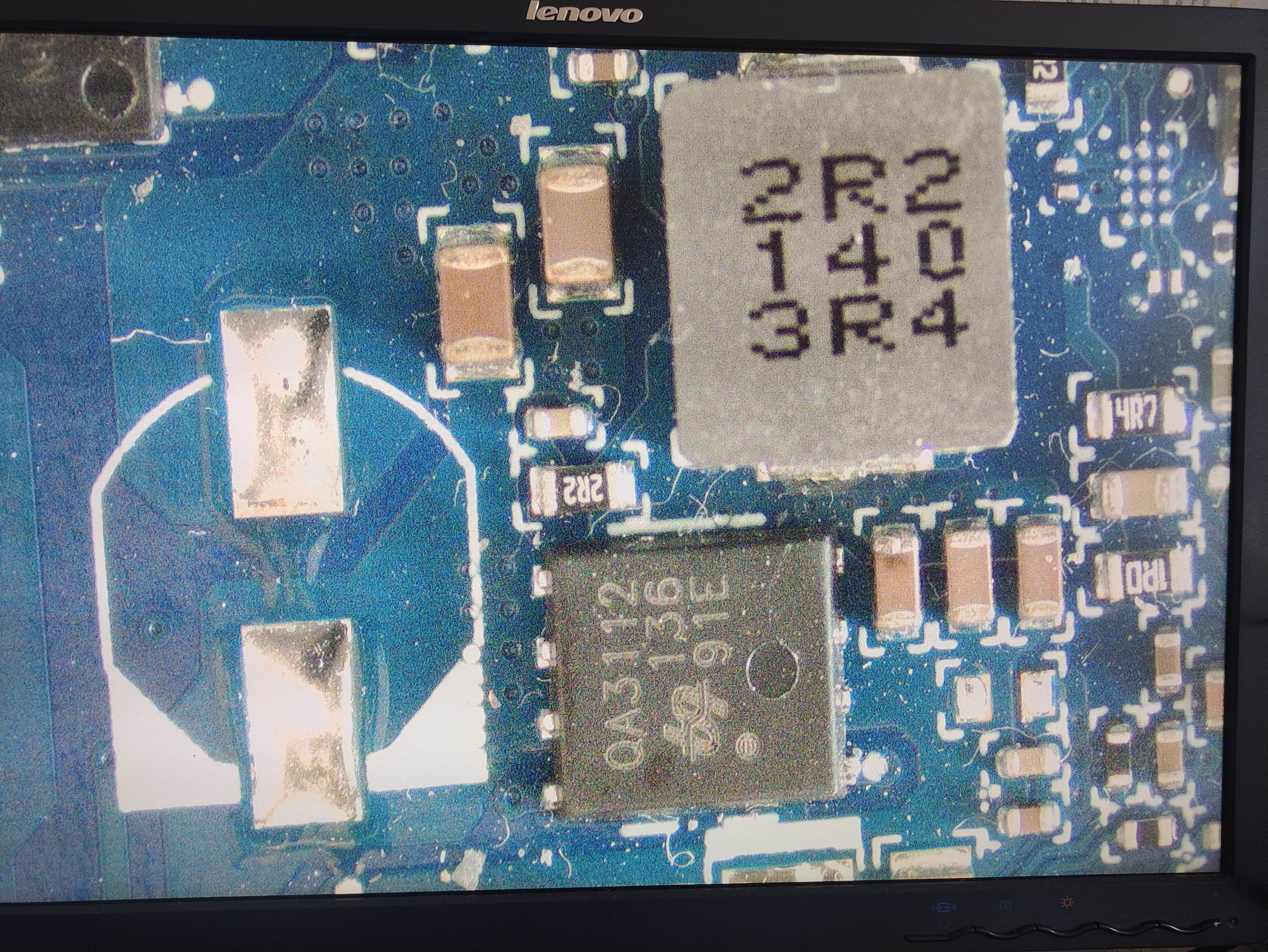

                          These are the chips near the battery.
                          • mon2
                            • Dec 2019
                            • 14512
                            ISL9238H is the battery charger.
                            Datasheet is attached. We can study this datasheet to learn more about how this logic board is working for the same function.

                              Yes they are close to the CPU.
                              1 Coil reads - 117 ohms
                              2nd coil reads - 35 ohms
                              3rd coil reads - 35 ohms

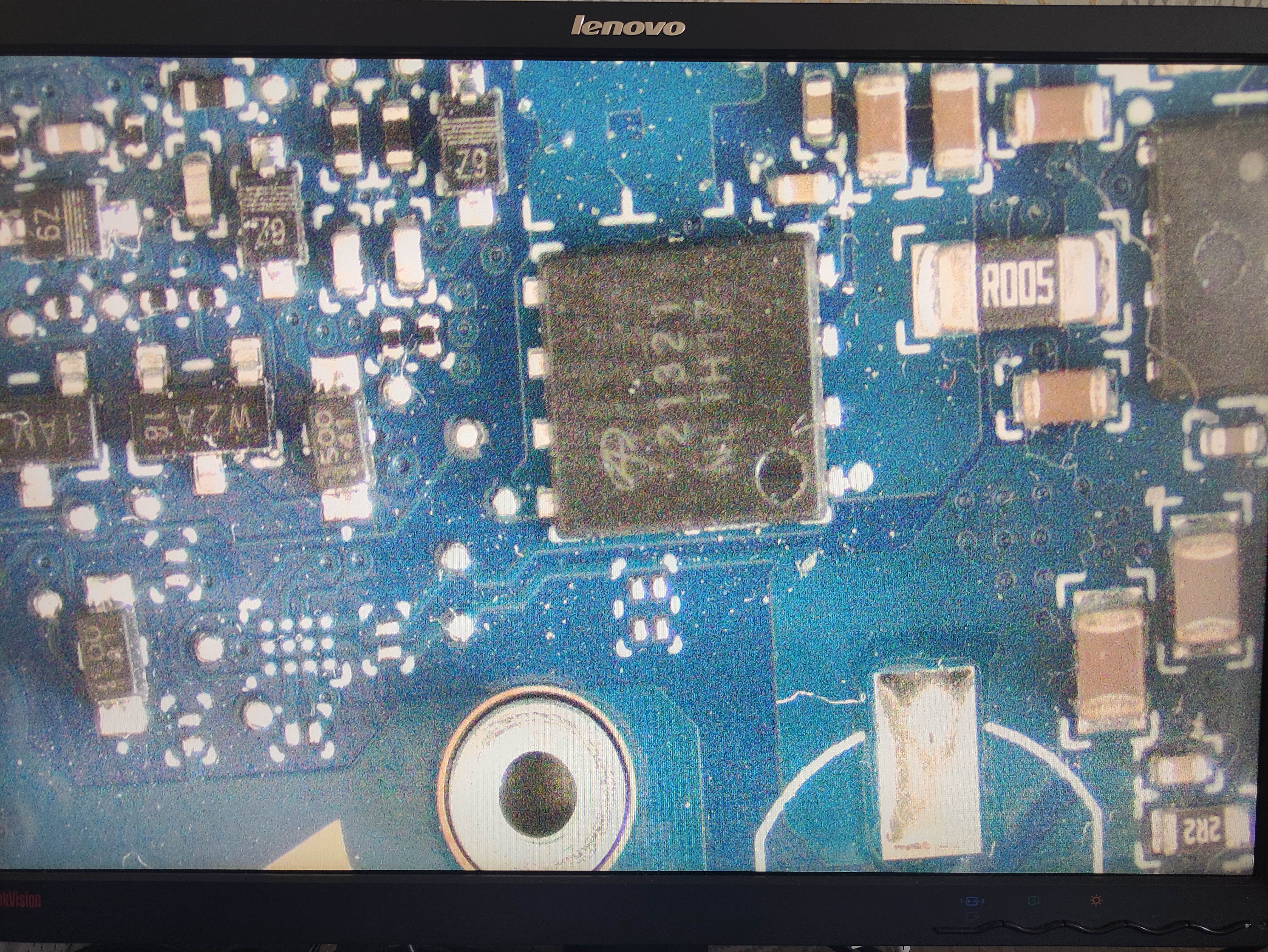

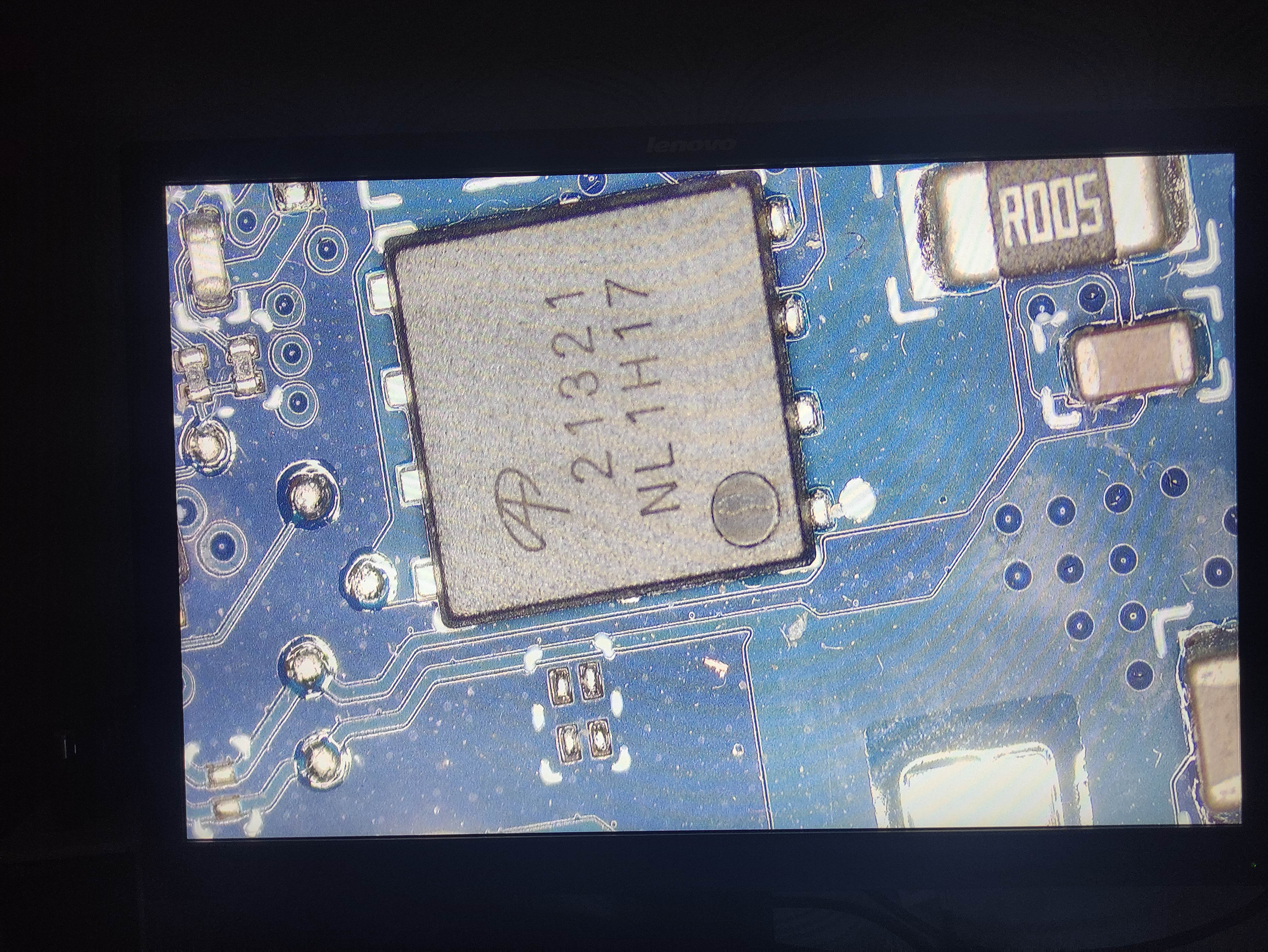

                                      Remove all power. Locate pin # 32 (BGATE) on the charger IC. Respectively, once you have the bearing of this pin, search for a nearby mosfet (most likely will be 8 pins with 4 on each side). We need to know the topside markings to find its datasheet. This will be the 'battery mosfet' that enables / disables when the battery is used.
                                      We wish to test if this mosfet is leaking or not by checking its resistance:
                                      source (1-2-3) & drain (5-6-7-8)
                                      source (1-2-3) & gate (4)
                                      gate (4) & drain (5-6-7-8)
                                      No power & no battery to the board during resistance checks. Post each measurement and also the units of resistance (ohms, kohms, etc.). A good working mosfet should be hundreds of kohms for each test.
                                      • Darren Hibbert
                                        • 116
                                        I located pin 32 but now what do I do with it?
                                        Ok so I found a MOSFET just under the battery connector (21321) as shown in picture.
                                        Resistance Source & Drain - 4.5 M ohms
                                        Source & Gate - 0.6 M ohms
                                        Gate & Drain - 11 M ohms.
                                        Second MOSFET nearby is QA3112
                                        Resistance Source & Drain - 41 K ohms
                                        Source & Gate - 2.3 M ohms
                                        Gate & Drain - O.L
