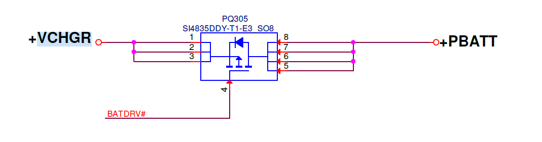

    XPS 9360 | LA-D841P not charging
    XPS 9360 | LA-D841P
    โ€‹not charging go up 0% 1 hour battery 100% work same othe laptop XPS 9360
    anyone have solution
  • mon2
    • Dec 2019
    • 14340
    1) Is the battery being detected by the operating system?
    2) Be sure the power adapter is the correct one for this laptop with enough power to support charging - confirm the BIOS is reporting the proper power of the power adapter. The details of the power adapter on a Dell box is through the 1-wire communication (PS_ID).
    3) Attach the power adapter and battery -> meter in DC volts mode (20v or high scale is ok) -> measure the voltage to ground of each pin on the battery mosfet @ PQ305.
    Check:
    source (1-2-3) ; any of these pins is ok
    gate (4)
    drain (5-6-7-8) ; should be the same voltage as source voltage
    Post each measurement.
