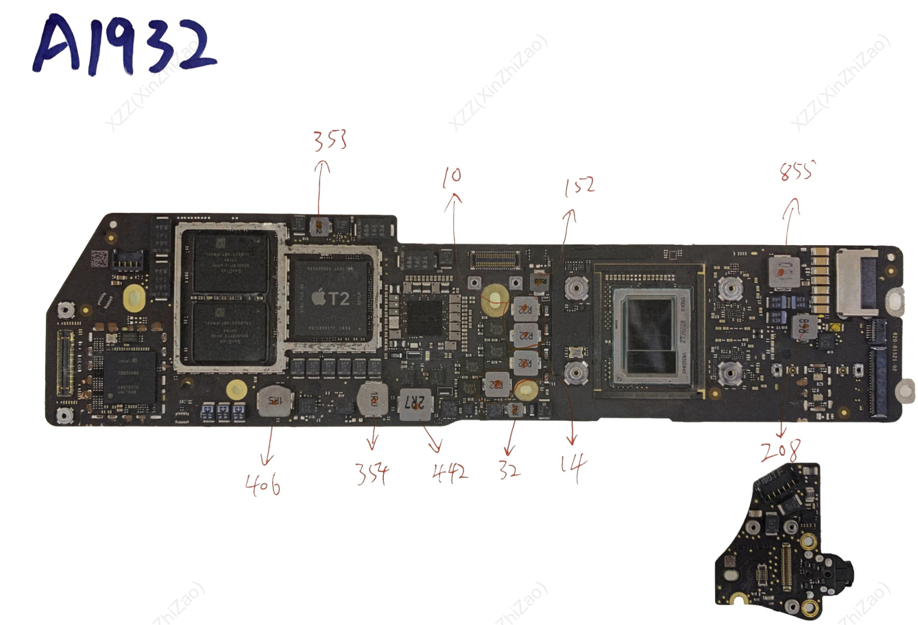

    Hello. I need your help . board outside the body. From the owner's story, he tried to replace the battery himself, after which it stopped working with both the old and new batteries. consumption 5v / 0.000a (not stable. sometimes jumps to 0.044 and again 0.000a).
    PPBUS_G3H=12.29v
    PPBUS_HS_CPU=12.28v
    PPDCIN_G3H=5v
    PP5V_G3S=0v
  • mon2
    • Dec 2019
    • 14657
    Check the resistance to ground of PP5V_G3S (with no power to the board).
    • PITERPENY
      • Jul 2023
      • 461
      • Ukraine
      PP5V_G3S=diod mode 0.392
      PP5V_G3S=8 kohm
      PP5V_G3S=0v
      ​PPVBAT_G3H_FUSE=0.156v

        See attached for DIODE values for this logic board.
        • PITERPENY
          • Jul 2023
          • 461
          • Ukraine
          I took the board from a work laptop and it does not match these parameters as in the picture! Here is a picture with real indicators of the working board!
          • PITERPENY
            • Jul 2023
            • 461
            • Ukraine
            and here are the indicators of the board that are under repair
