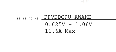

                    For now the only suspect thing is the quite low voltage of PPVDDCPU_AWAKE 0.54V.
                    Is it normal ?
                      Yes, appears to be lower than normal range. What is the resistance to ground for this rail ?
                      • mon2
                        • Dec 2019
                        • 13994
                        Also, from logiwiki :
                        PPVDDCPU_AWAKE 10-15 Ohm ; resistance to ground on a good device
                        reference:
                        CD3217 and T2 Power on Sequence - LogiWiki​
