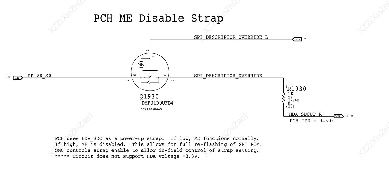

    macbook A1706 820-00239
    Hello ! The system installs but cannot boot and the screen of death appears.
    macbook works in safe mode
    after pressing the power button, the system starts to boot after 27 seconds, which is a very long time
  • mon2
    • Dec 2019
    • 14657
    Long time to boot is usually a bios fault. Reflash the board. Have some bios images here in my database if you need them.
    Or could be the attached - recall a thread on this forum discussing this issue - this will throttle the CPU speed.
    Update - found the thread - review the thread and Q1930 mosfet.

      I tried a couple of BIOS firmwares that I have and some load quickly or slowly or do not work at all, but there is an error during loading that does not allow it to turn on
      I would be glad to test a couple of your firmwares if possible)
      ​​​​​​since the failure occurs when I try to load the image of the first download, I think that the problem is somewhere in the region with the graphics

        Here you go:
        https://we.tl/t-l7pQZcWD5h
        Will post them in the BIOS forum as well later today.
        Also, have you investigated the above MOSFET issue?
