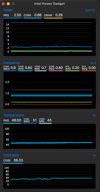

            Fans run at the normal speed. No high speed happening here. I've attached a screen grab of the CPU utilization in Intel Power Gadget.
            The CPU appears to be running at near 100% utilization for about 5 minutes at startup. The CPU temperature never goes above 50 degrees, which I find rather strange. The CPU should get quite warm and the fans should ramp up to cool it down.
            The previous owner noted that the board ran slow but I was sure it would simply be a bad sensor. not so lucky this time.

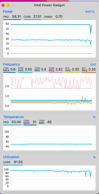

                    60 W for an MBA CPU running at 600 MHz does not sound reasonable.
                    • ACS-Repair
                      • Feb 2021
                      • 204
                      Re: MacBook Air A1466 2017 Operating Very Slow

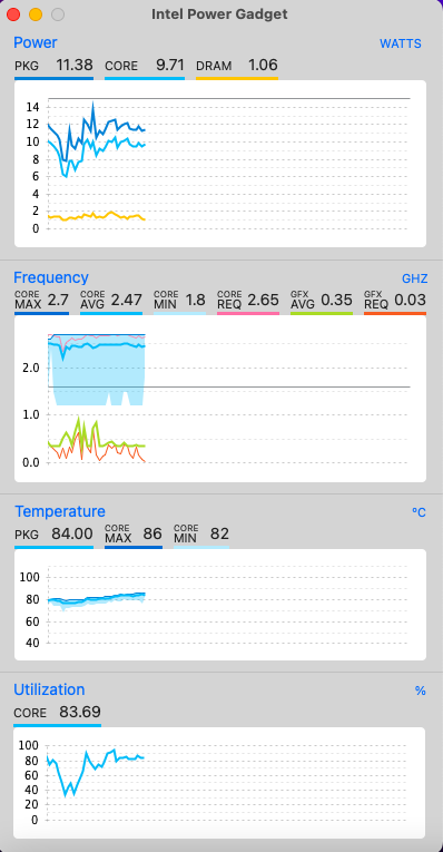

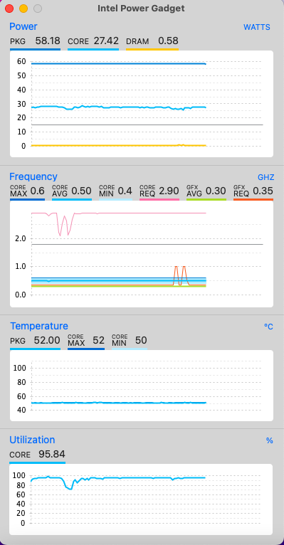

                      No, you're right, that doesn't make sense when it's using a 45w genuine adapter. It may be an incorrect reading based on the fault. The 2015 MBA draws far less power by comparison.
                      You can see from the attached screen captures that the 2017 processor is running at only 0.5 - 0.6GHz. A comparison of a 2015 MBA shows it running at 2.47GHz average. This is the reason for it being slow but I have no idea why this would be the case. What can slow down the processor speed?

                        If the system thinks it's drawing too much power it's gonna throttle down.
                          Good thought. I'll take a look at the area around the ISL to see if there are any anomalies.
                          When the computer settles down after 10-12 minutes, the power draw usually comes down to 7-10 watts. I don't know how I get these strange ones...

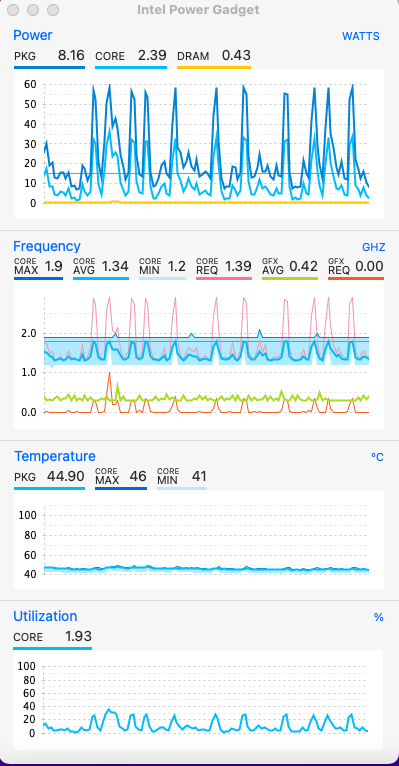

                                After I let the computer settle for 10-12 minutes, the power draw settles down to more normal levels.
                                The power spikes to high levels on a regular pattern even though utilization is at a relatively low level. CPU temperature is dead steady in a fairly narrow range. That also is not normal.
