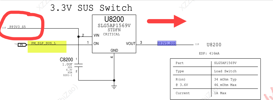

                                    where is PP3V3_SUS formed?
                                    • mon2
                                      • Dec 2019
                                      • 14602
                                      See attached (U8200). Carefully review the voltage to ground of this critical load switch.
                                      PP3V3_S5 must enter this load switch
                                      EN signal of PM_SLP_SUS_L = '1' = ~3v3 then output will be the PP3V3_SUS to further power other devices.
