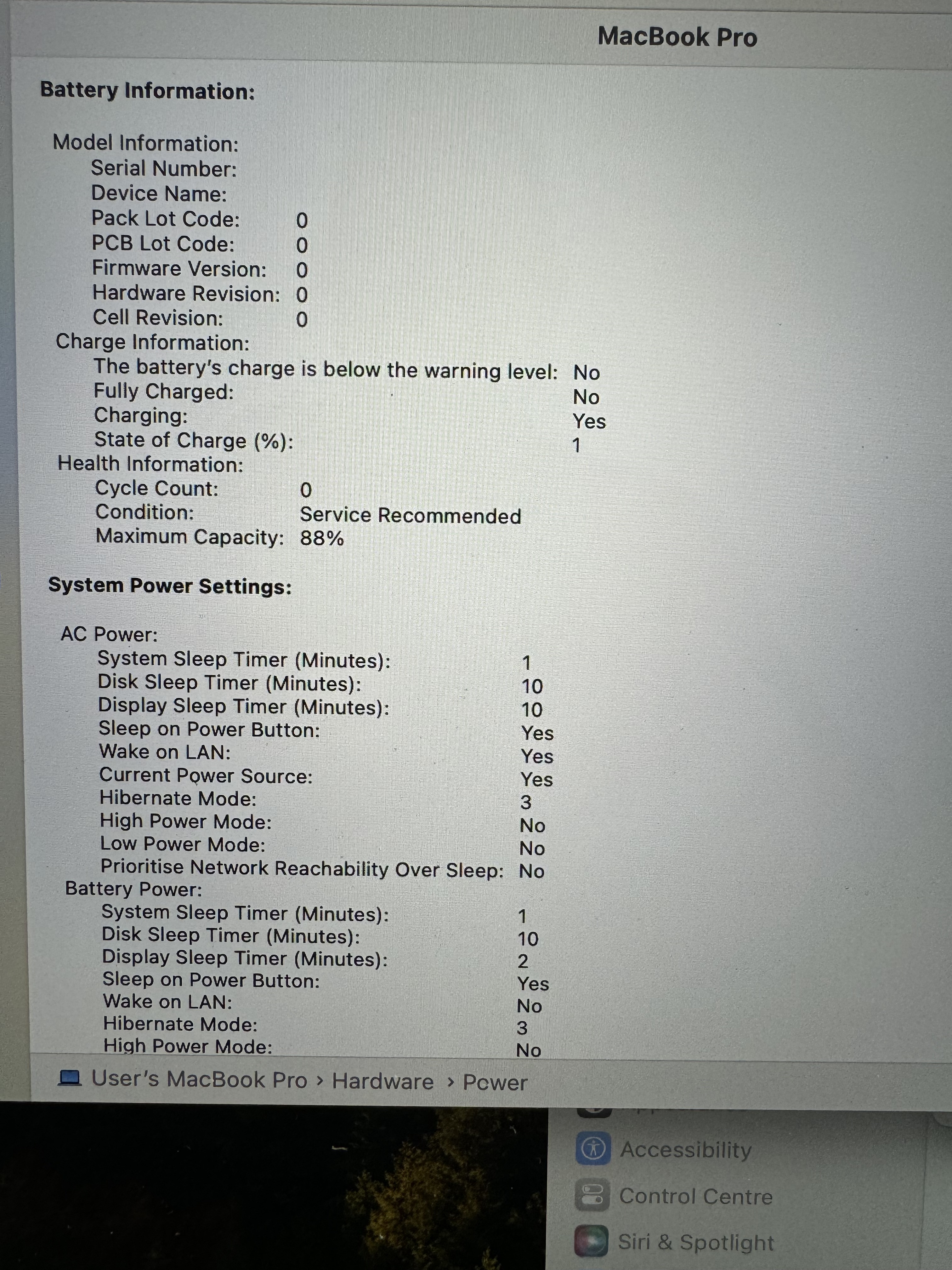

    820-02382 (MacBook A2485 16" M1) not detecting battery. Battery sign has cross. However it works from battery but not charging and reporting incorrect data like charge remaining.
    Any one any ideas please? Also fans are high/full speed

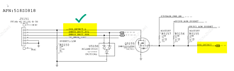

    Measure with care the voltage to ground on each pin on the battery connector. Post each measurement.

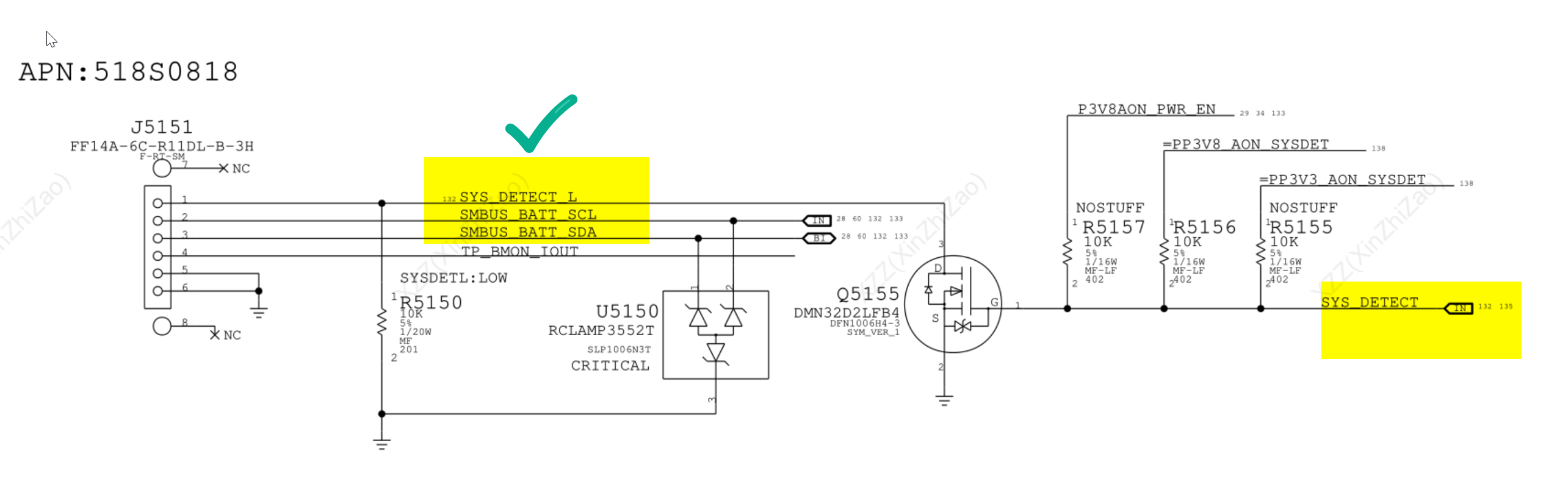

      J5151:
      pin 4 (SMBUS_BATT_SDA) - 1.79V
      pin 3 (SMBUS_BATT_SCL) - 1.69V
      pin 1 (SYS_DETECT_L) - 0V
      Battery gets 12V on + -

        The SMBUS interface on the battery connector do operate @ 1v8 swing so the measured voltages are correct.
        Can you share a screen pic of the battery details for your unit? Do you see the serial #, # of charge cycles, etc. correctly? If not, there is some fault here.
        The communication is from a low voltage SMBUS that travels through a voltage level shifter to be compatible with the 1v8 SMBUS swing that is onboard the BMS board that is implanted inside of every battery pack. Perhaps the 1v2 side of the level shifter is not working but confirm your battery screen details.
        Have you tested with another known good battery? Perhaps consider to source from Amazon and return it if it is not required.
        Confirm the voltage to ground of the SYS_DETECT signal as per attached.

          SYS_DETECT 3.8V
          Will try to get another battery to test

            Also run a diag on the board to understand the reason for the high fan spin which should a failure status of a sensor or the lack of that sensor’s ability to report back. If the sensor access times out then the fan will also enter turbo mode.
              Tried 3 batteries, one of them new, all shows that. They work on other Macs and display all info correctly. So Mac fails to read.
              Is U5200 faulty?
