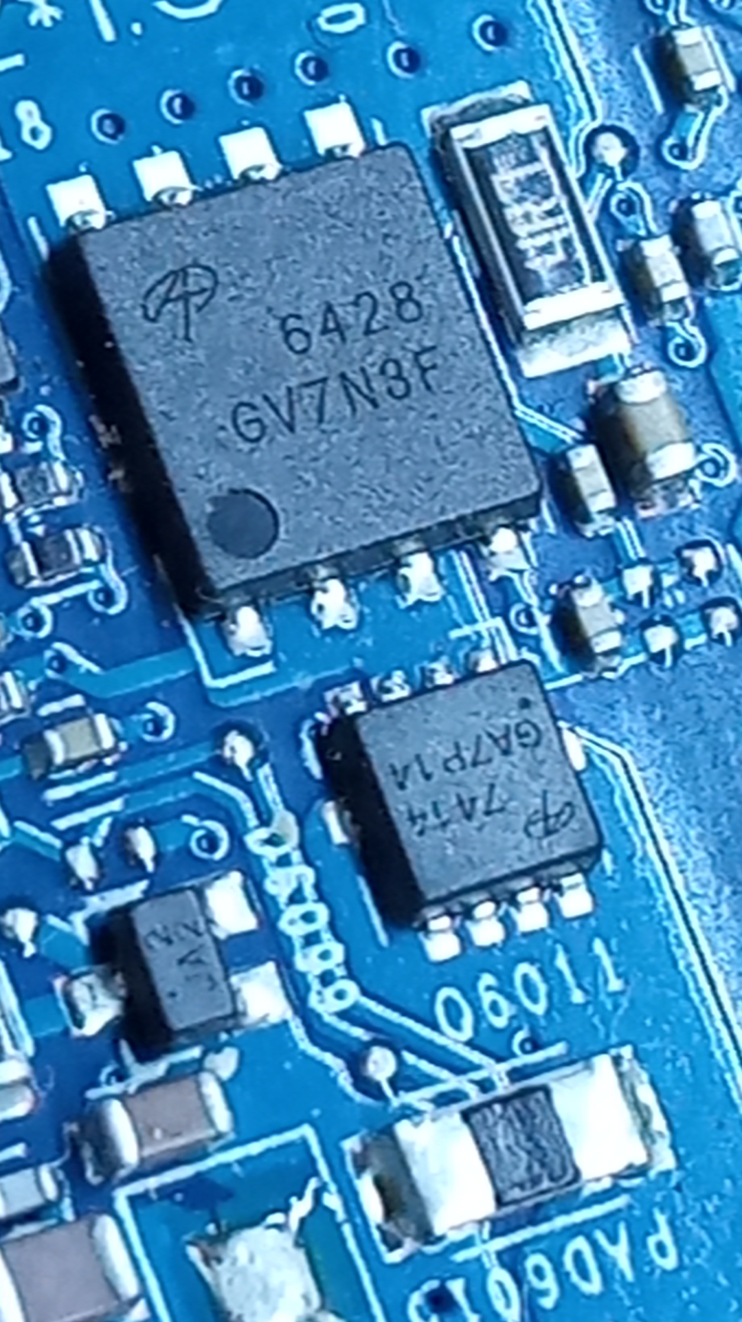

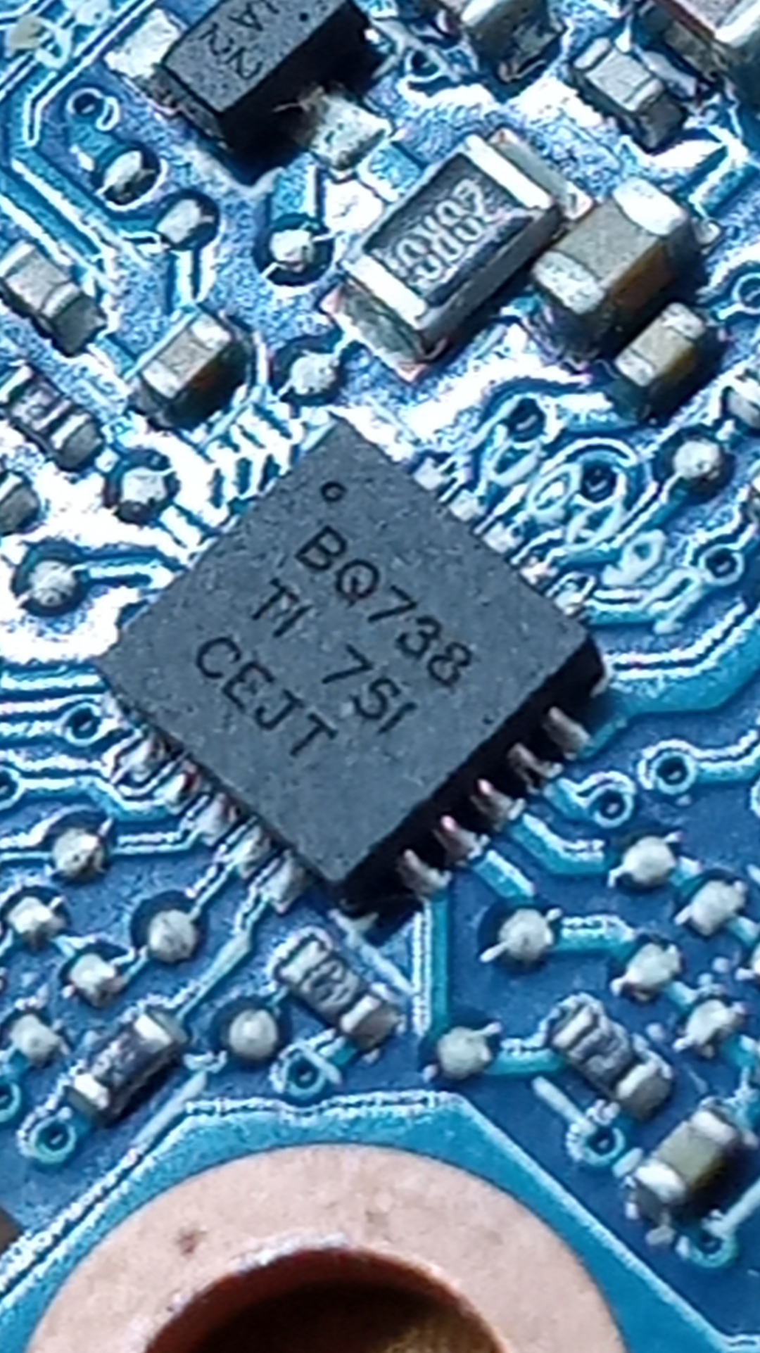

        2.) First DCIN mosfet is AON6428, second mosfet is AON7414. Charger IC is BQ738
        - about LEDs : the one on the charging port, it is all time turned off. Then, there are three LEDs under power button. These LEDs are meant to shine together I believe, and this power button lights all the time, from the moment I connect the charger. No other LEDs on the board
        - there is 19.9V on drain of both mosfets, same voltage for source of both mosfets. 25.66V on gate of both mosfets

          Dc-in fet biasing is correct. Absence of light on dc jack is almost a sure indication of missing 3V LDO rail. Locate your 3V regulator,check datasheet if available and check 3V LDO is present or not. If not present,check resistance to GND on 3V LDO.

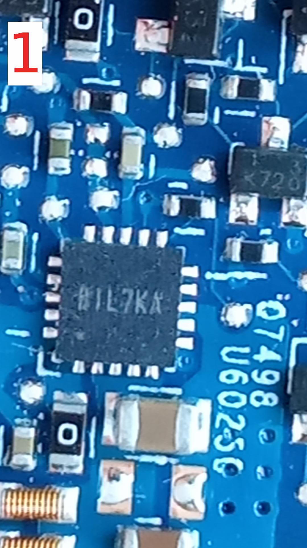

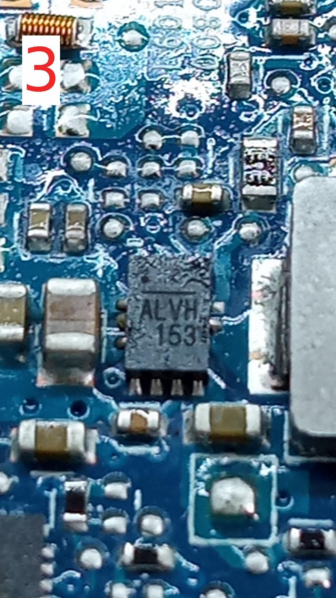

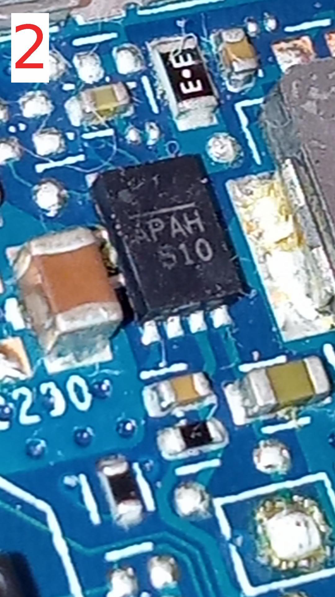

                SMDFlea thank you so much, that information was very important to me! I am sorry, that I didn't check that topic before, I somehow missed it.
                So update:
                - first picture is SY8284CRAC, but datasheet is probably still not available, there is only some schematic of its connection on google. Anyway, I was able to measure 5V at one of its pins ( capacitor directly connected on it ), which is not connected to 5V switching supply. So, considered it as working fine
                - second picture is NB679A, and it works correctly - both switching and LDO 5V voltage is up and running
                - third picture is NB680, and it works - switching voltage is 3.3V and LDO voltage is 3.0V. Moreover, output from LDO regulator 3.0V is directly connected to those two capacitors nearby EC, I mentioned before. So from this point, I suppose, LDO for 3.3V is up and running and EC has its power.

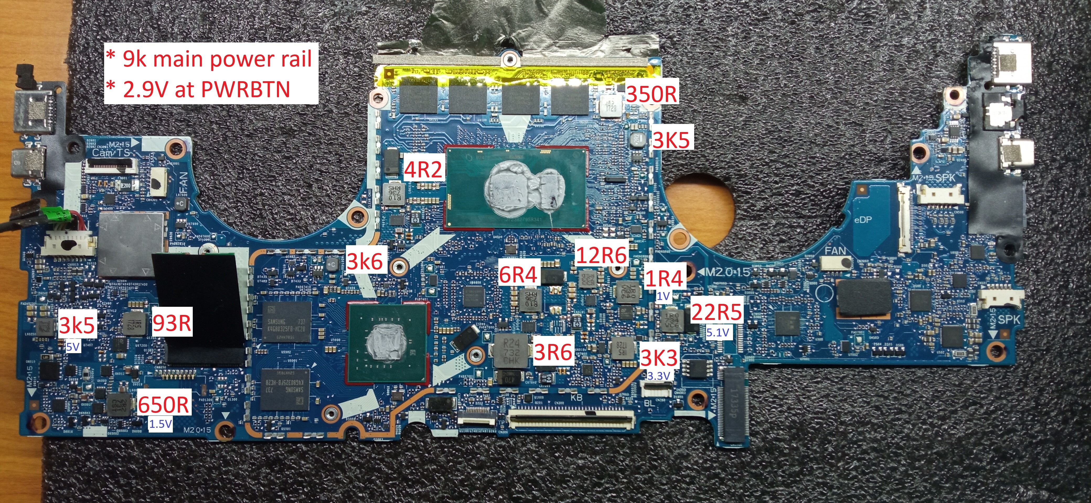

                  Looks like I am not alone, who is lost in this case without schematic. So to finish it somehow - do you guys at least have any idea, how to confirm dead EC ( corrupted EC firmware included ), eventually dead PCH, without schematic?
                  Also, is 1.4 ohm resistance to ground on that 1V power rail too low?

                    Resistance to GND on 1V rail at 1.4 Ohms is considered too low indicating perhaps towards a shorted PCH. Without schematic & boardview, its impossible to troubeshoot a BGA EC.
                    Since, 3V LDO is present and still dc jack light is not glowing, it could be either bad main bios or corrupt ec firmware. Try flashing them both first preferably from HP official biosupdate file .
