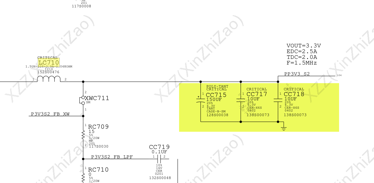

    Remove all power. Meter in resistance mode. Measure the resistance to ground of PP3v3_S2​.
    • phantomEVO
      • Mar 2013
      • 488
      i've removed lc710 (to isolate the line but removing it i've broken it...)
      47 ohm
      in diode mode 0,023

          Here is a replacement (1210 SMD size component) for LC710:
          https://www.digikey.com/en/products/...AProsHiygAsOoA
          To me, 47 ohms to ground and the diode mode readings are too low. Also wish to confirm that this measured low resistance to ground is on the consumer side of this power rail? This is from PCB pad #2 of the removed LC710 ferrite bead inductor?
          Suggest to flux well and carefully remove the 3 caps on this power rail as per attached. Take your time to allow for the solder to melt. Then check the resistance to ground again for this isolated rail. Being caps with a polarity for CC715 and CC717 - be sure to note the position of the + side of each. CC718 is a not a polarized cap and is a ceramic device.
          If not done already, disconnect the trackpad / camera / lcd assemblies and confirm this resistance to ground again. This power rail is used to power numerous current sense amplifiers.

            I'VE DONE ALL MEASUREMENTS WITHOUT LC710
            i've done the meaurements on pad 2...
            i’ve removed All 3 caps without luck

              Be sure to check for thermals on both sides of the board. I think it will be safe to consider to increase the injection voltage (from 1v0) but keep under the 3v3 max. Increase the voltage slightly and monitor for heat. Repeat the process if necessary. This rail is not linked to the cpu. To confirm, nothing is attached to the logic board?
              • phantomEVO
                • Mar 2013
                • 488
                it's strange, at 3,3v i can clearly see the upper layer of wifi chip become hot
                removing rd810, short is gone

                  Aha!! Remove it and test again. Did see a current sense amplifier for the wifi linked to this power rail. Not at my desk but the wifi device could be also powered by this rail.
