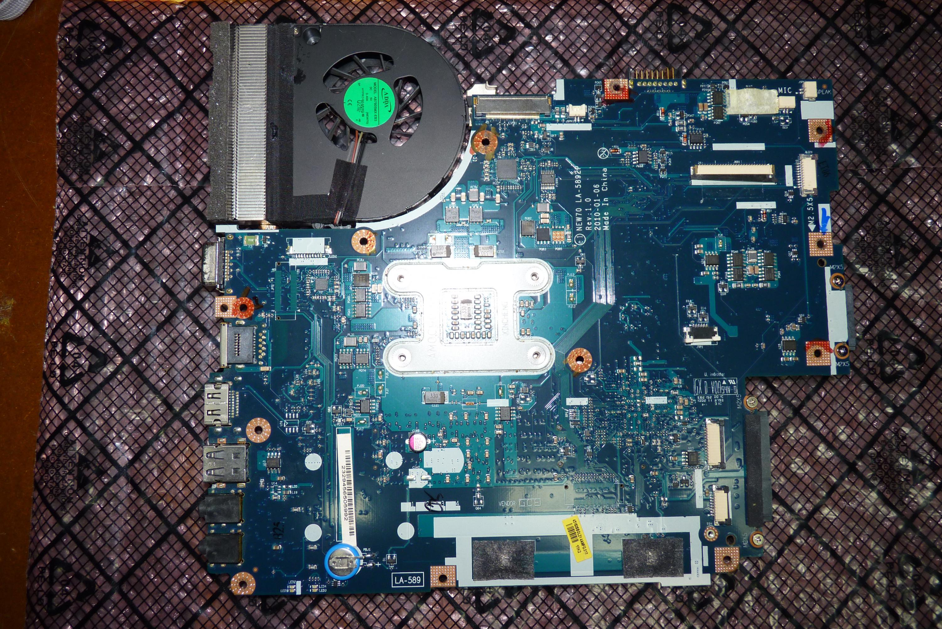

    Motherboard: NEW90 L21 No LED Backlight on Display
    I can faintly see image on the display with flashlight but screen has no brightness at all. Laptop was dropped; replaced the power jack and LED display cable. Both were damaged and the left hinge was snapped off and flopping around. The LED cable must have shorted something since the display was working prior to the repairs.
    The 2 fuses on back of the LED display check good.
    I could not locate any other fuses on the motherboard.

        Can't find a schematic. I'll take some pics of the mobo, top and bottom.

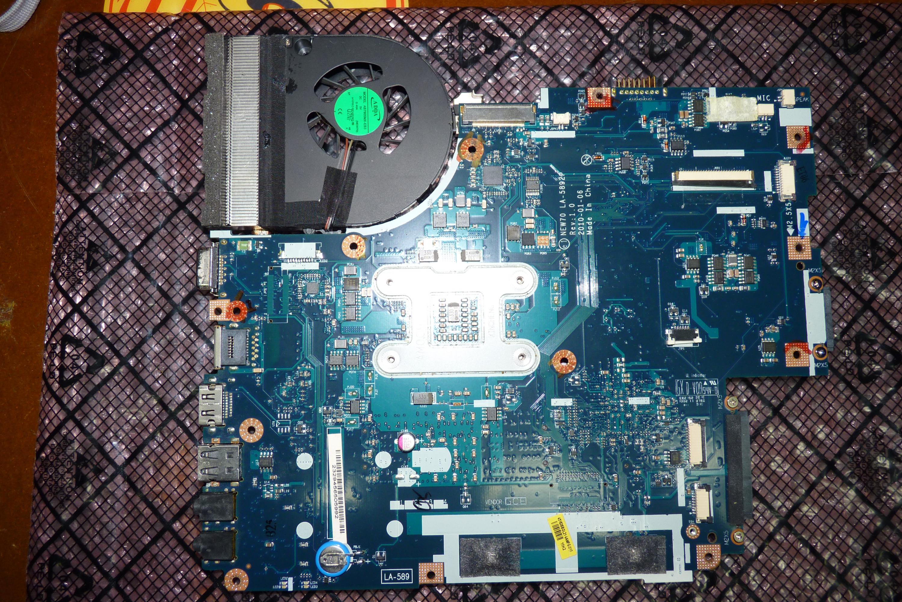

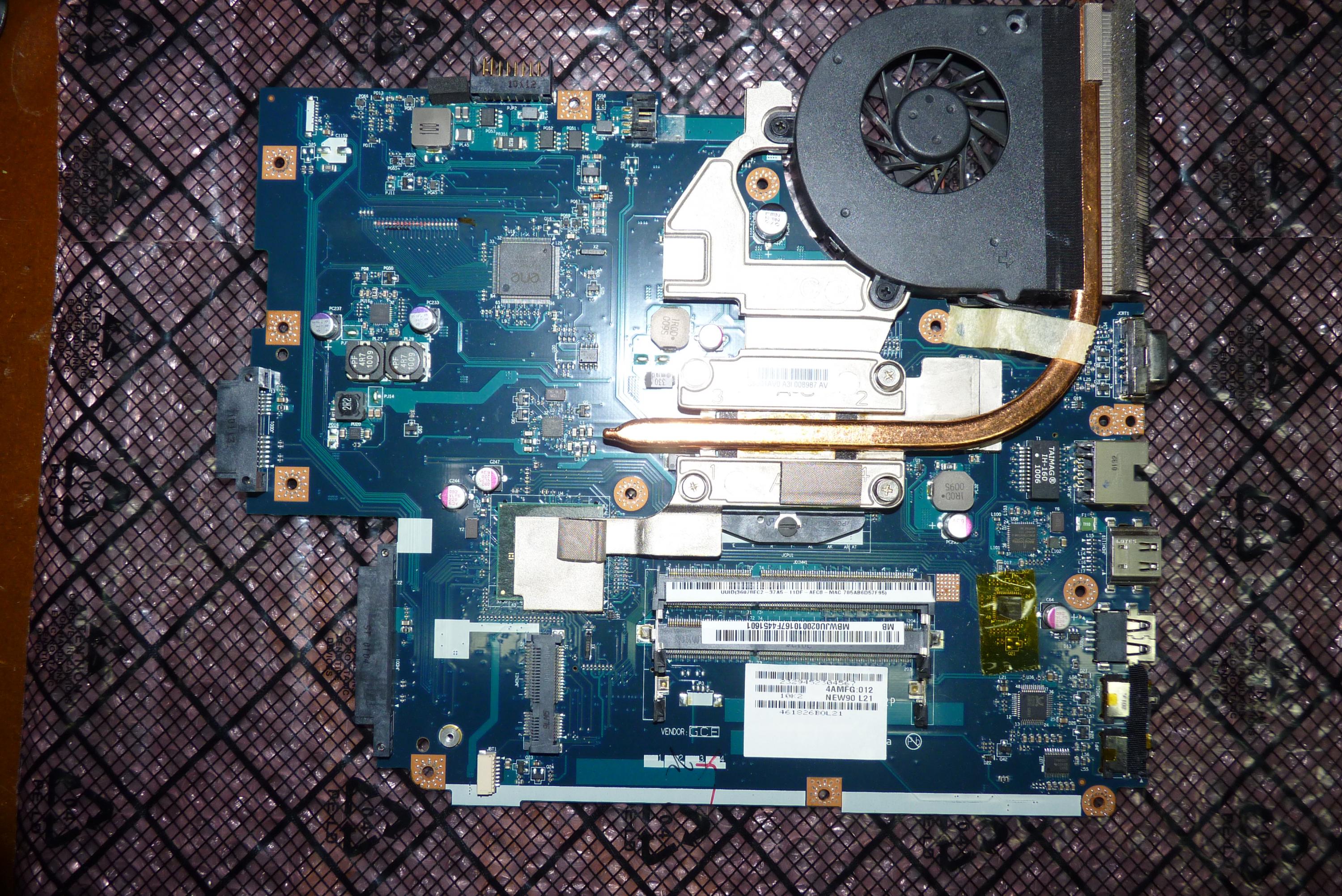

            Re: Motherboard: NEW90 L21 No LED Backlight on Display
            Wow the schematic is great! Wish I could decipher where the fuses would be.
            I am attaching to pics of the mobo hopefully someone could lead me to the fuses. Thanks
              Sorry, here's other side
                first ones to check - L12, L13
                  that is a normal led screen.
                  the only difference in this led screen and a ccfl its the tube.
                  yours got a led stripe.
                  find a smash and test like that.
                  don`t open the mobo and start poking around
                            Khaahk, I checked - L12, L13 and they check for continuity.
                            Are the L s the fuses?
                                The L-s should be also working as fuses, they are ok. Power on the mainboard and do some careful voltage measurements (not to touch other pins while measuring or you might end up with dead mainboard) with the panel attached and power turned on.
                                Start counting the pins from the white triangle (right to left).
                                1-3 - should be adapter voltage
                                4-6 - should be 3.3V (which you have or else you would not see any picture on panel)
                                7 - should be also 3.3V (on stby also)
                                8 - maybe 1.5-3V (depending on screen brightness setting)
                                9 - should be above 2V
                                12 - not sure above 2V maybe digital signal, here should some info about brightness also
                                Write back the results, lets see then.
                                You also might have broken backlight on panel...
