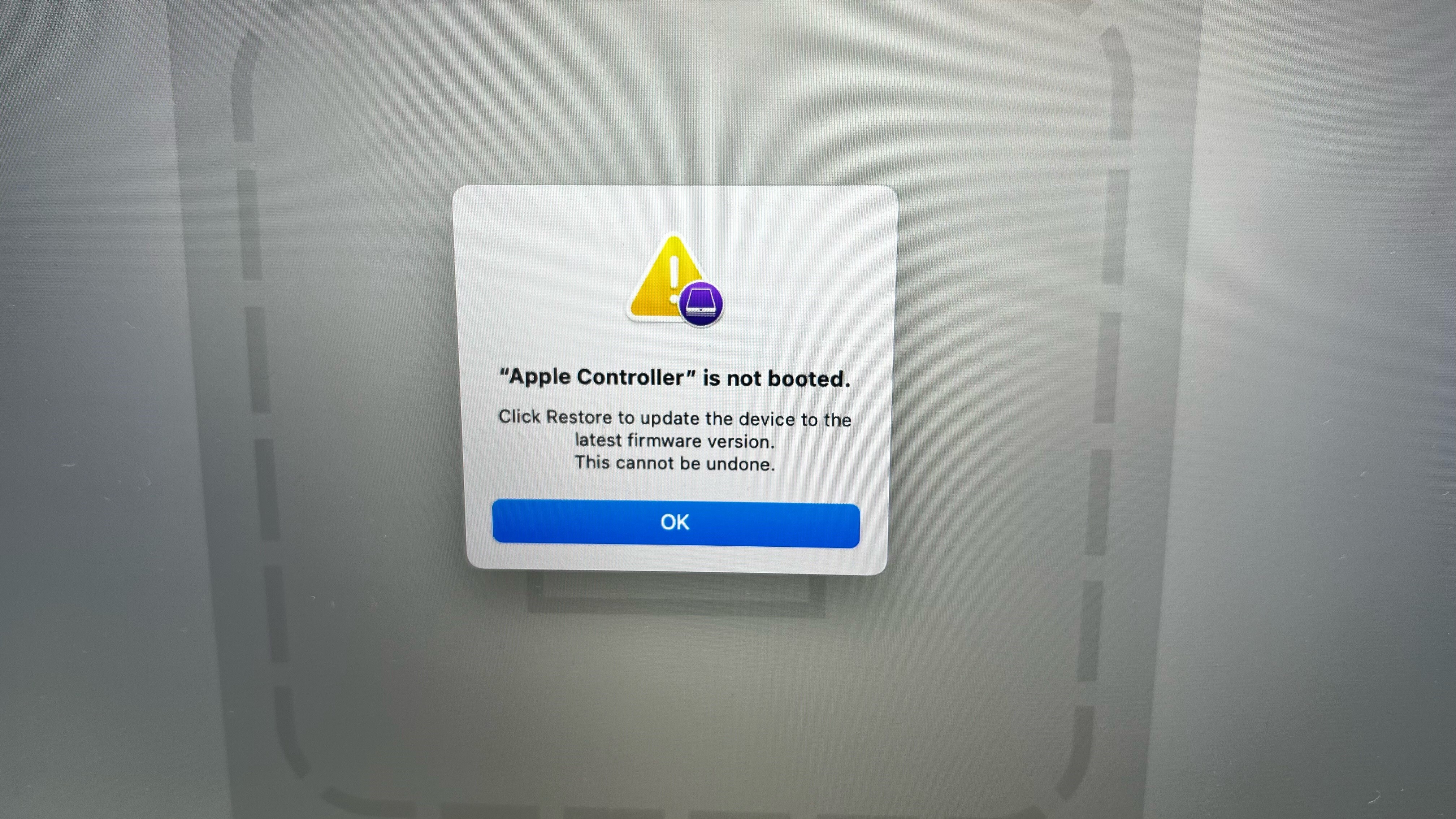

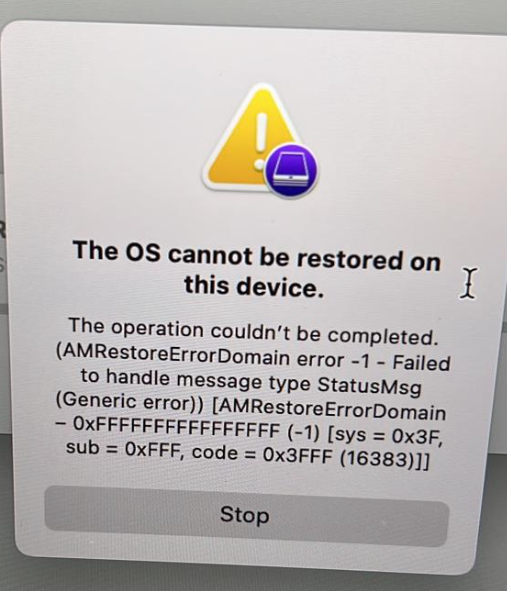

    i'm having a problem with A2251 after the liquid damage, before it got to us, customer went to other repair store, and we don't know what was done. Laptop stucked on 20V 0amp, i tried to revive bridgeOS no luck, error -1.
    PP3v3_S5 - Normal
    PPBus - Normal for DFU
    PP2v5_NAND_SSD_0 - normal (and resistance about 45Ohm)
    Liquid damage was mainly next to ISL from that what i've noticed.

    What is the exact voltage to ground of PPBUS_G3H​? PP2v5_NAND_SSD_0 ?

      The error code -1 indicates that the device is unable to communicate with the Apple server.
      Check your internet connection - use a reliable USB to Ethernet port adapter (with Asix controller is recommended).

        PP2v5_NAND_SSD_0 2.5V
        PPBUS_G3H 12.59V

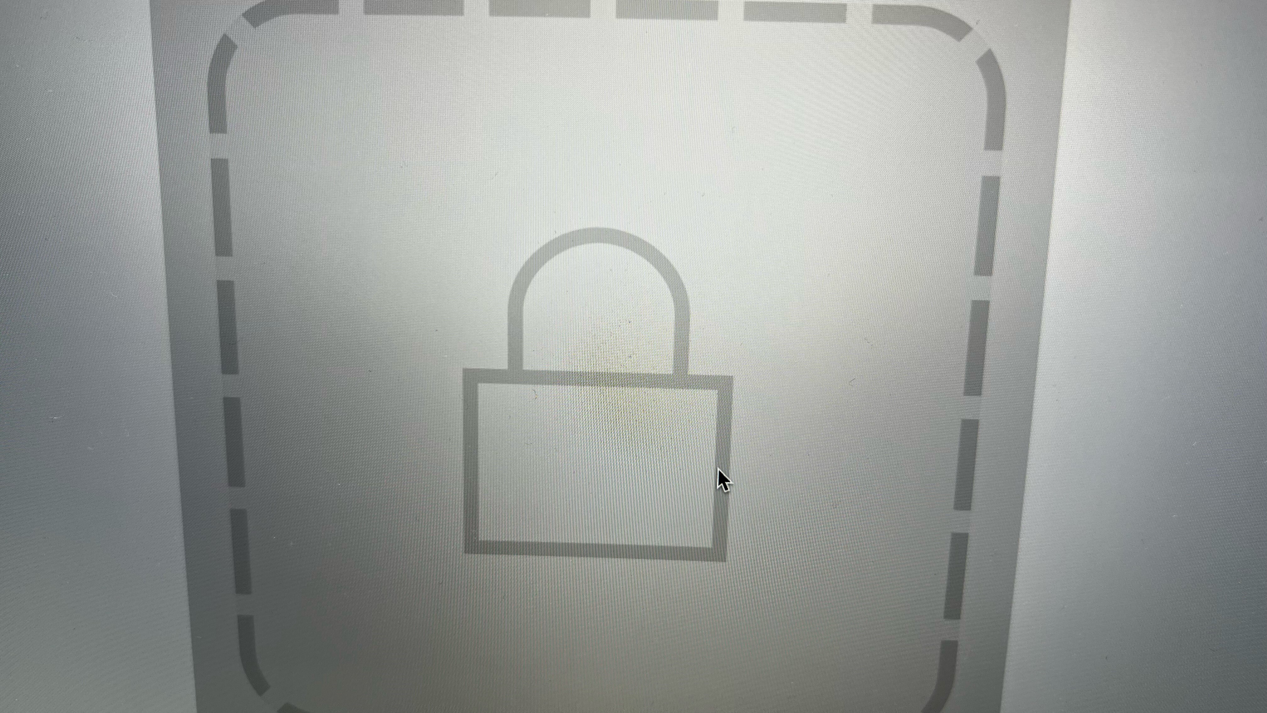

        "The error code -1 indicates that the device is unable to communicate with the Apple server." - got an Ethernet adapter, DFU seems to go through, now it shows me that screen, no changes, tried update through DFU and it says that action cannot be done.

          Any idea what to check further? mon2

            Review the last 2 posts here and keep updating this thread:
            https://forums.macrumors.com/threads...dlock.2293187/
