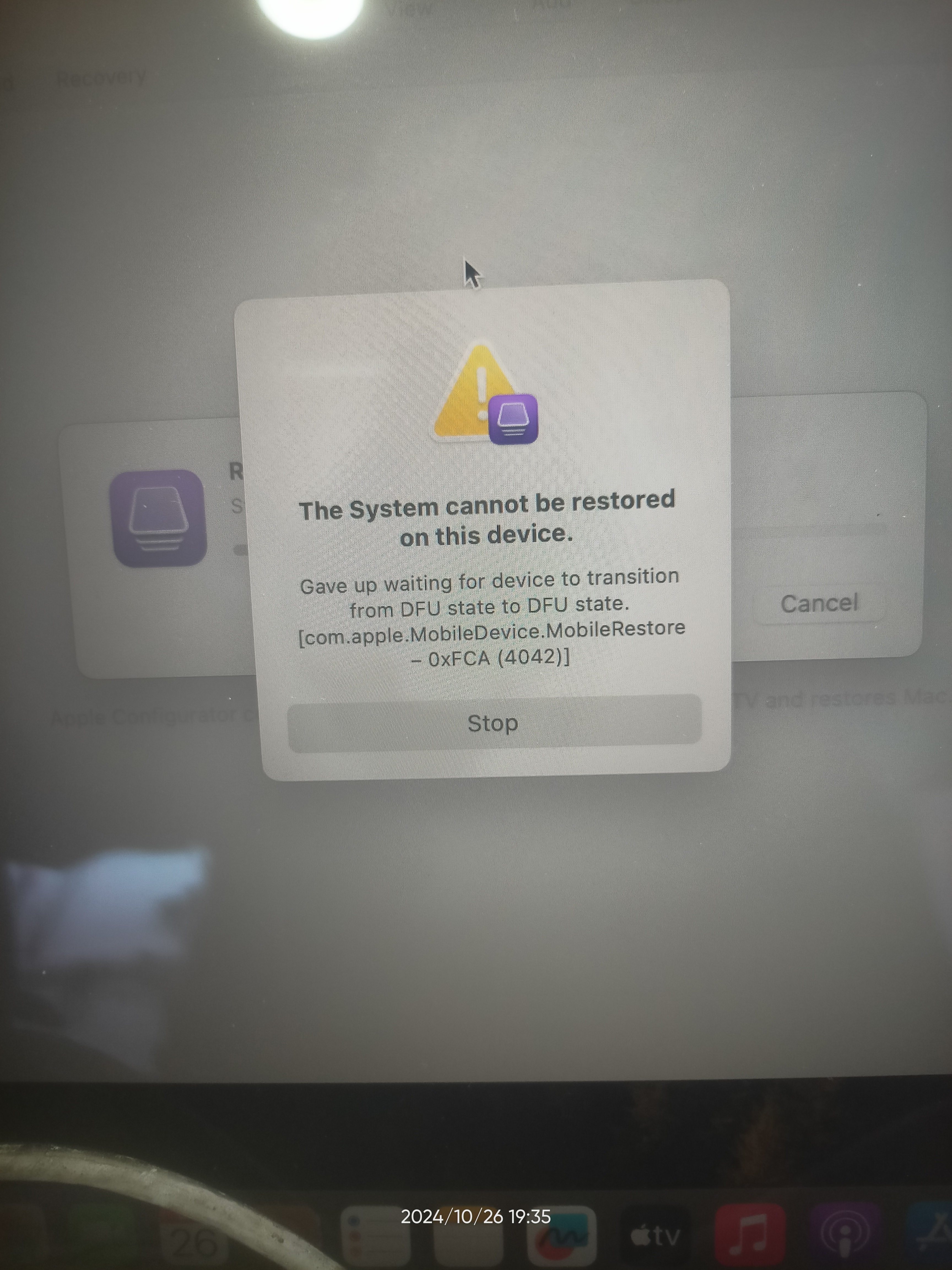

    macbook pro a2251 820-01949-a 5v stuck i checked all ldo ok ppbus_g3h is 12v pp3v3_g3h 3.3v all SLPS2R volt ok i try in dfu but gave me this error 4042

    Originally posted by Arshad alam4659
    macbook pro a1707 820-01949-a 5v stuck i checked all ldo ok ppbus_g3h is 12v pp3v3_g3h 3.3v all SLPS2R volt ok i try in dfu but gave me this error 4042
    sorry
    model a2251 820-01949-a
      sorry
      post the original content of the bios chip, even if it is corrupted..

        which ic
        u means u3750 ic
