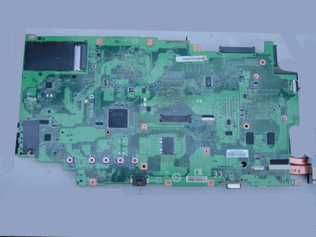

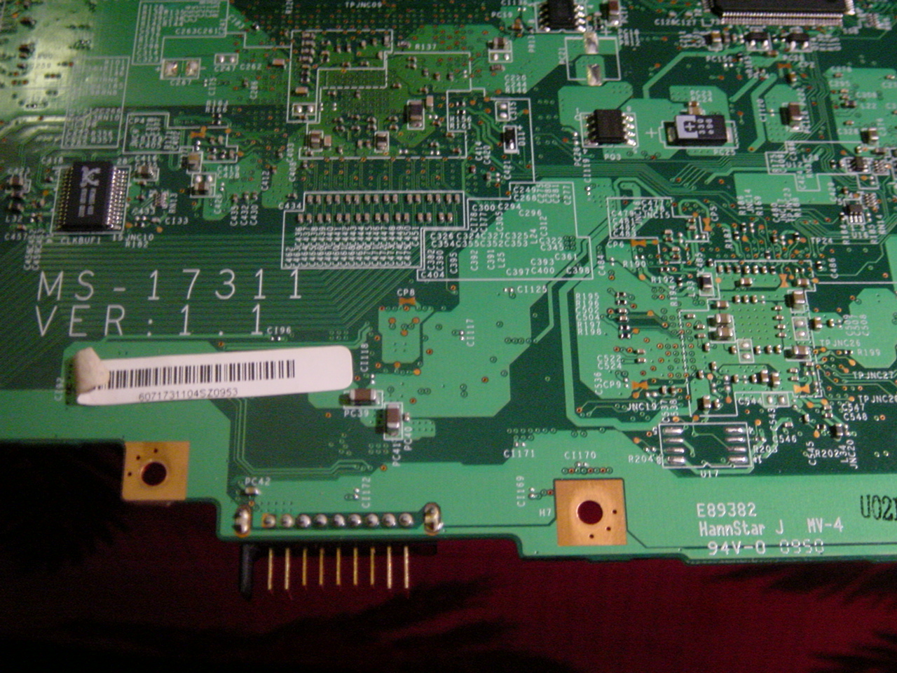

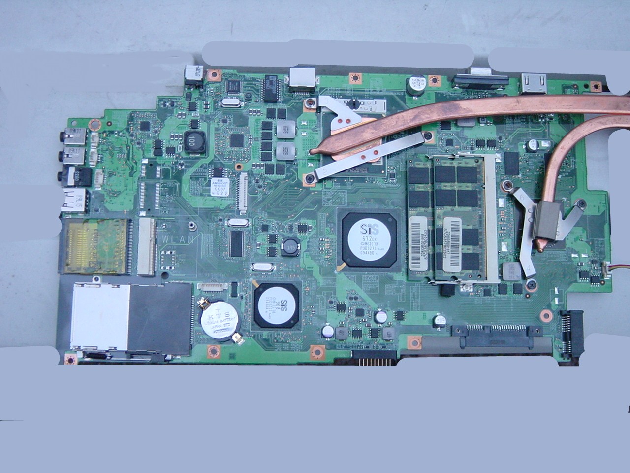

                      forgot post some pics of the board!
                      High res with macro plzz
                      • hansie55
                        • Dec 2013
                        • 254
                        • Netherlands
                        Re: MSI CX700 MS-17311, hannstar E89382
                        Herewith the pictures.
                          do you know the term cook the board?
                          try
                          • hansie55
                            • Dec 2013
                            • 254
                            • Netherlands
                            I know. Did it before with Dell xps m1330 and m1530 with the bad Nvidia 8400.
                            Nice word for it is "reflow"
