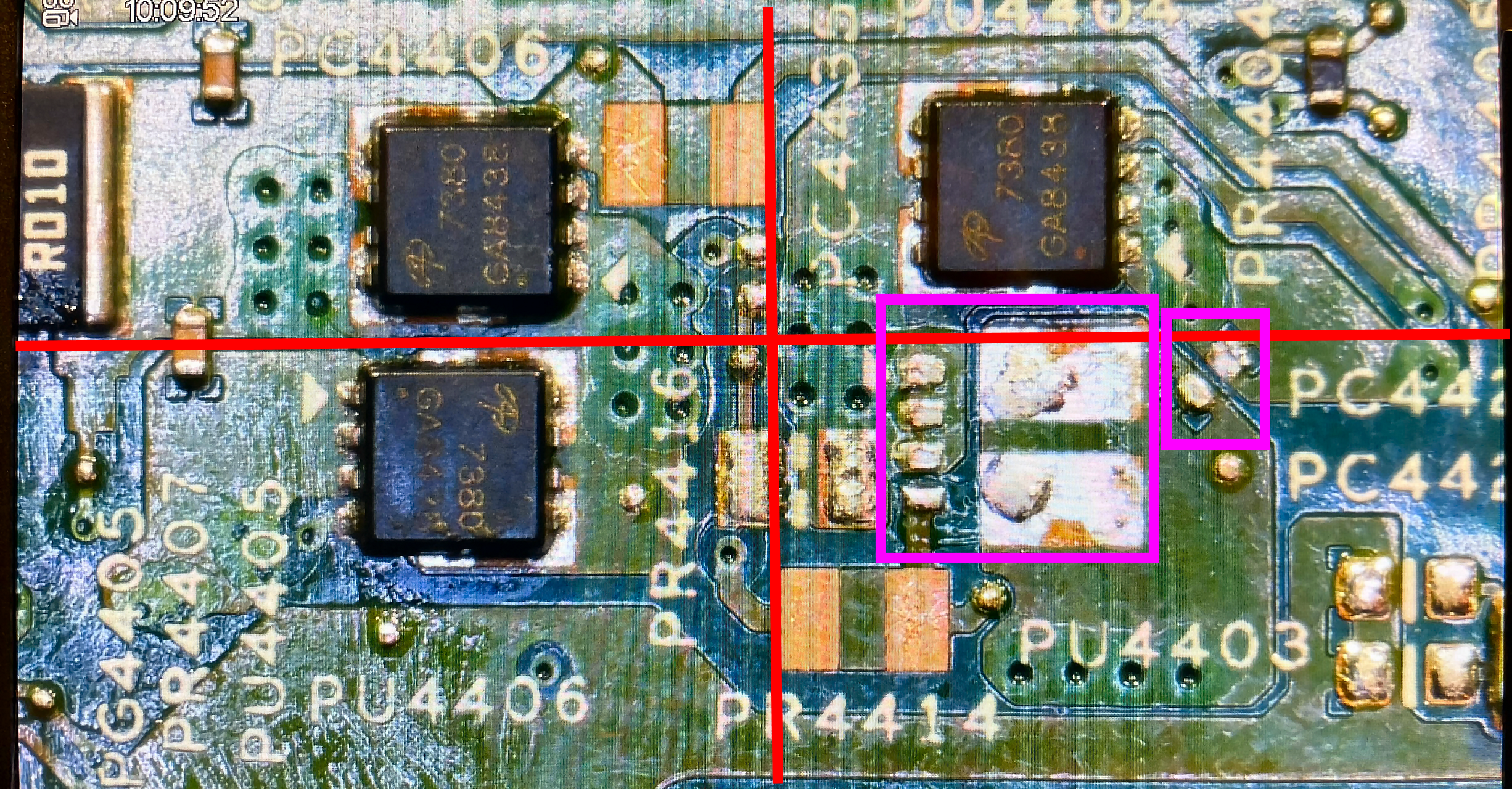

        Start with fluxing and carefully removing PU4403 (lower right mosfet). Allow it to cool and measure the pins on the removed mosfet while it is on your work bench. Do not power up this logic board without the mosfets.
        Trying to locate the reason for the short. Be patient and allow for the solder to melt.
        • zlr8r
          • Feb 2023
          • 102
          PPU403 mosfet removed , and getting a direct short on it between Source and Drain.

                  Click image for larger version  Name:	mosfet+cap_removed-edit.png Views:	0 Size:	6.18 MB ID:	3165735Click image for larger version  Name:	mosfet+cap_removed-values.jpg Views:	0 Size:	51.1 KB ID:	3165737
                  Purple squares illustrate removed Cap + Mosfet.
                  (Lower-right red+white values box reflects measurements with both Cap+mosfet removed)
                  many thanks

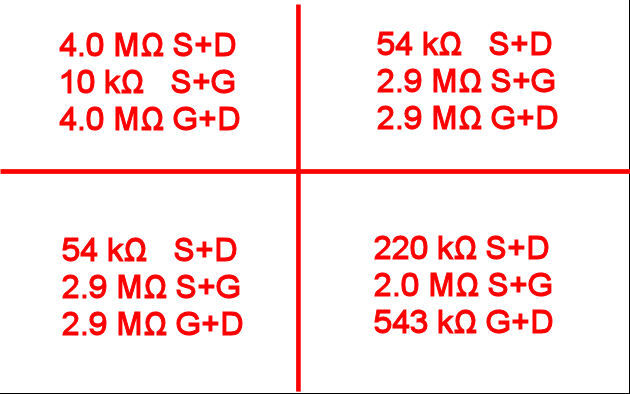

                  • mon2
                    • Dec 2019
                    • 14677
                    #29

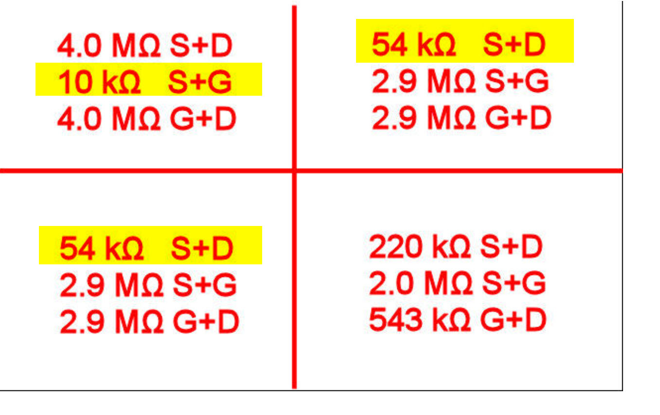

                    The attached in highlight, to me are perhaps also defective mosfets. Best to flux and remove and measure each while they are out of circuit. If the readings remain low then they are also leaky and considered to be defective.
                    Measure the mosfet pads as well after the parts are removed. Click image for larger version  Name:	low_mosfet_readings.jpg Views:	0 Size:	184.5 KB ID:	3165746
                    Check each mosfet while it is off the logic board.

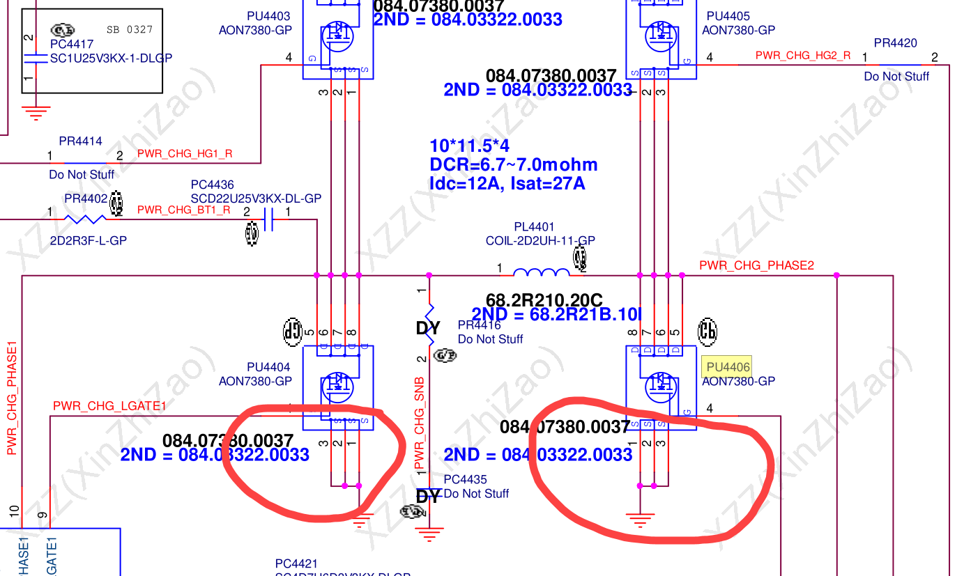

                        #31
                        PU4404/4406 pin 1-2-3 is GND and clearly mentioned in the schematic. Remove PU4403 from board and check resistance readings on the mb PCB pads/pins of that mosfet.Is the reading same or it has climbed much higher?
                        Sorry,didnt read that you have already removed it.

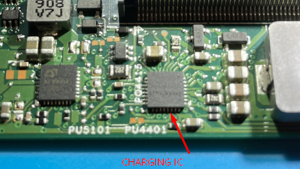

                                            looking for fully extracted by programmer Bios for a Dell Inspiron 17 (7786)
                                            by zlr8r
                                            looking for a fully extracted (by programmer) Bios for a Dell Inspiron 17 (7786) v.1.09 or newer, so I can compare it with my own bios to check for corruption.
                                            cheers
                                            Dell Inspiron 17 (7786) Laptop
                                            Service Tag: 5J0NHT2
