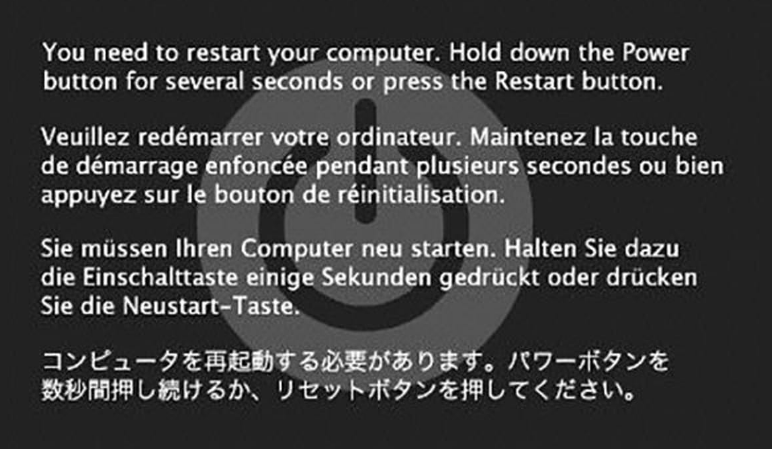

    Mac crashes and restarts with kernel panic. No water damage on board. Board is clean. Memtest86 showing no errors. The installation Ventura or Sonoma is successful, but after 5-10 minutes of operation, the accident occurs again. Did a DFU restore and revive, twice with success and successfully reinstalled Sonoma. After 5 minutes of work Mac crashes with Kernel Panic. Apple Diagnostic (AHT) does not find errors.
    How to localize the problem ?

    Details of the panic?

      only this

        Don't Panic! Troubleshooting Kernel Panics in macOS (macsales.com)

          I can't log in macOS. Every time I get a reboot message and the laptop reboots.

            Try booting into safe mode to confirm if the unit is stable.

              I have seen this issue before, known GPU failure, it will boot in safe mode, but won't boot in normal mode. Usually a cause of a faulty GPU.
