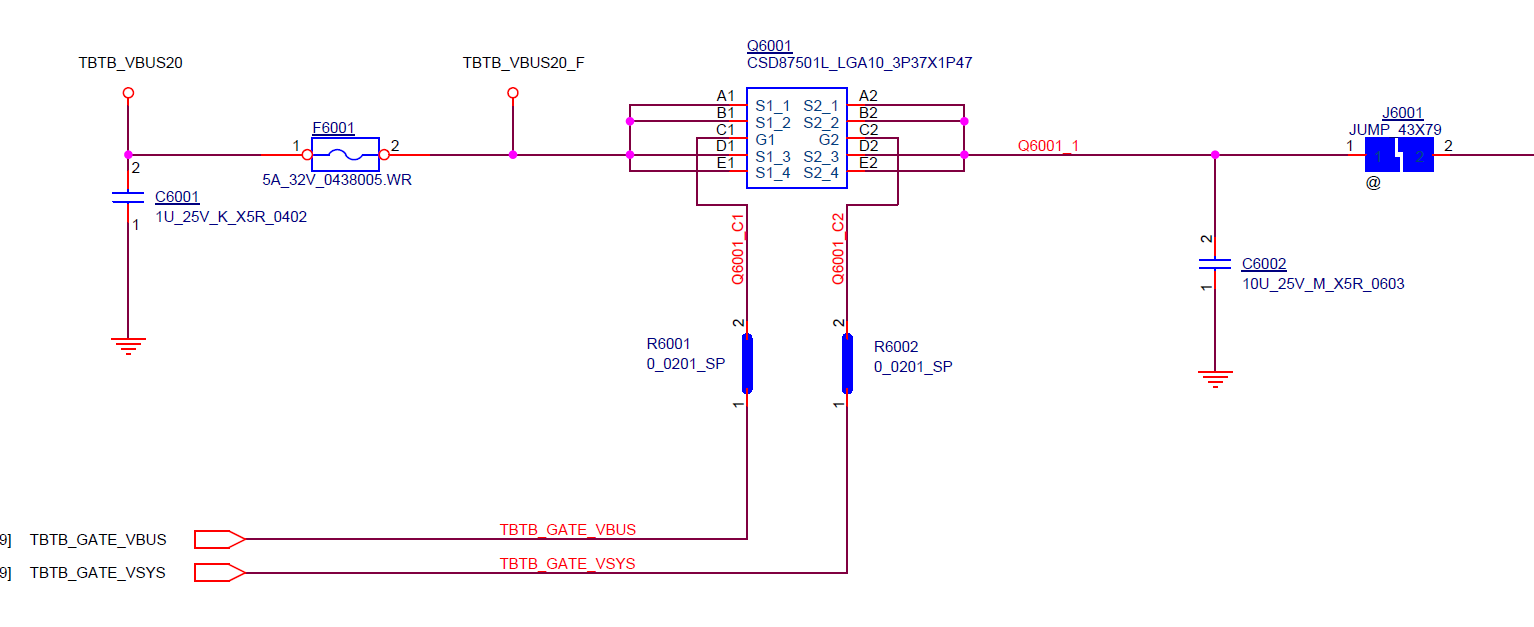

    My L15 doesnt power on. When I connect charger, charging light lights up, and Power LED blinks 3 times, then nothing... When I press power button nothing... I tried everything, remove batteries, checking fuses...
    Maybe BIOS is corrupt?
    Mainboard is: NM-D271 HL4A0 / HL5A0 REV2.0

          Carefully measure the voltage to ground of each pin on dual dcin mosfet at PQ0204. Post each measurement. Schematics are available in the schematics forum.

            Pin1 0V
            Pin2 0.443V
            Pin3 0V
            Pin4 0V

              You do not have the power coming from the external power adapter (based on the measurement on pin # 2 of this dual mosfet).
              Carefully measure the voltage to ground at both sides of the fuse @ F6001.

              • chick0n
                • Mar 2017
                • 22
                I testet without poweradapter, just with batterie. I will test again tomorrow, with adapter.
                • chick0n
                  • Mar 2017
                  • 22
                  Now measured with batterie and power adapter (batterie is charging)
                  Pin1 16.26V
                  Pin2 20V
                  Pin3 0V
                  Pin4 1.767V​
                  When I connect the power adapter, the power led blinks three times. When i press power button, nothing happens.
                  When I disconnect cmos batterie and connect power adapter the power led stays on, fan spins up, cpu gets warm, but no picture. sometimes I even get a error code over speakers.
                  • mon2
                    • Dec 2019
                    • 14713
                    Connect the power adapter. What is the voltage to ground at capacitor c6002?
                    what is the voltage at the fuse f6001?
                    • chick0n
                      • Mar 2017
                      • 22
                      c6002 20V
                      f6001 0V (Fuse is good)
                      • chick0n
                        • Mar 2017
                        • 22
                        It works:
                        https://www.badcaps.net/forum/troubl...n2-not-booting
                        SD-Card Controller was burned, and BIOS was Corrupt.
