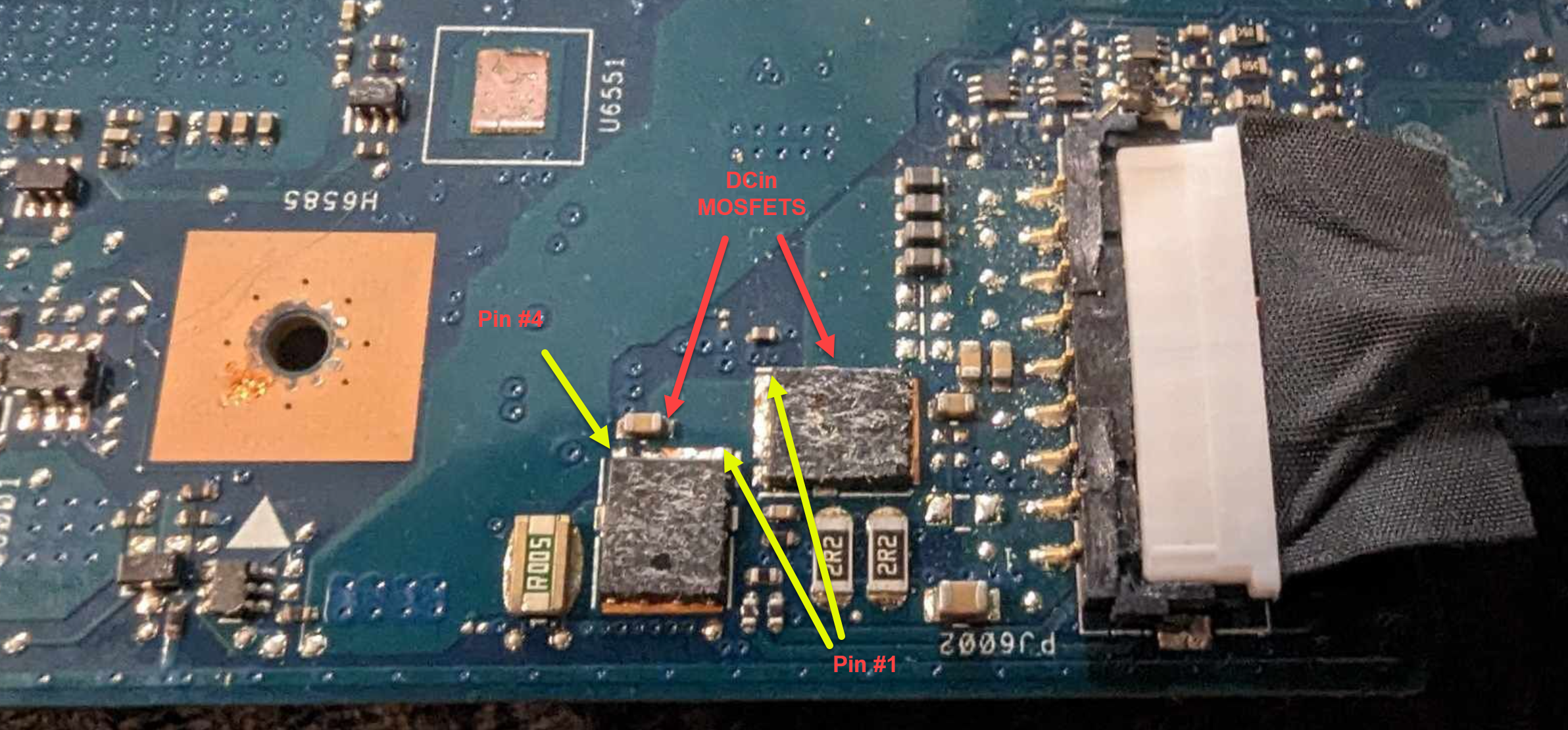

            Yes. Post clear pics of the top and bottom side of the logic board where the power enters the board. You should see (usually) 2 x mosfets. These are the tiny 8 pin devices with 4 pins on each side. They act like solid state relays. On 8 pin packaged devices, pins 1-2-3 are the source pins. Pin #4 is the gate. Pins 5-6-7-8 are the drain pins.
            The part has a polarity so search for pin #1 which will often be identified with a dimple (dot) on the top side.
            search for a datasheet to understand the pin out of the device.
            we are after the voltage to ground on the source pin; gate pin; drain pins. Repeat for the 2nd mosfet. Measure carefully.
            post all measurements.
            these mosfets will be driven by a charger ic. We want a clear picture of the charger ic.
            how this all works is very well documented by piernov in the above sticky. It is a must read.

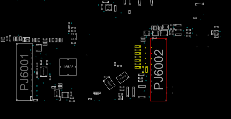

              So I found a similar thread for the board I have. They included a boardview of the 2.0 board, whereas I have the 2.1 This is where things get a bit complicated. The layout is a bit different than mine. In the boardview picture I verified voltage / ground and the A/D_DOCK_IN voltage on the PL600x chips . The A/D_DOCK_IN leads to other chips that don't match my board. I included a picture of my charging area the best I could. There's a lot of residue from the adhesive. If I had to assume, the 2 black chips near the 2R2s are the MOSFETS.
              I wasn't sure what I was looking for on the profile. Click image for larger version
              Thread - https://www.badcaps.net/forum/troubl...-boardview-plz

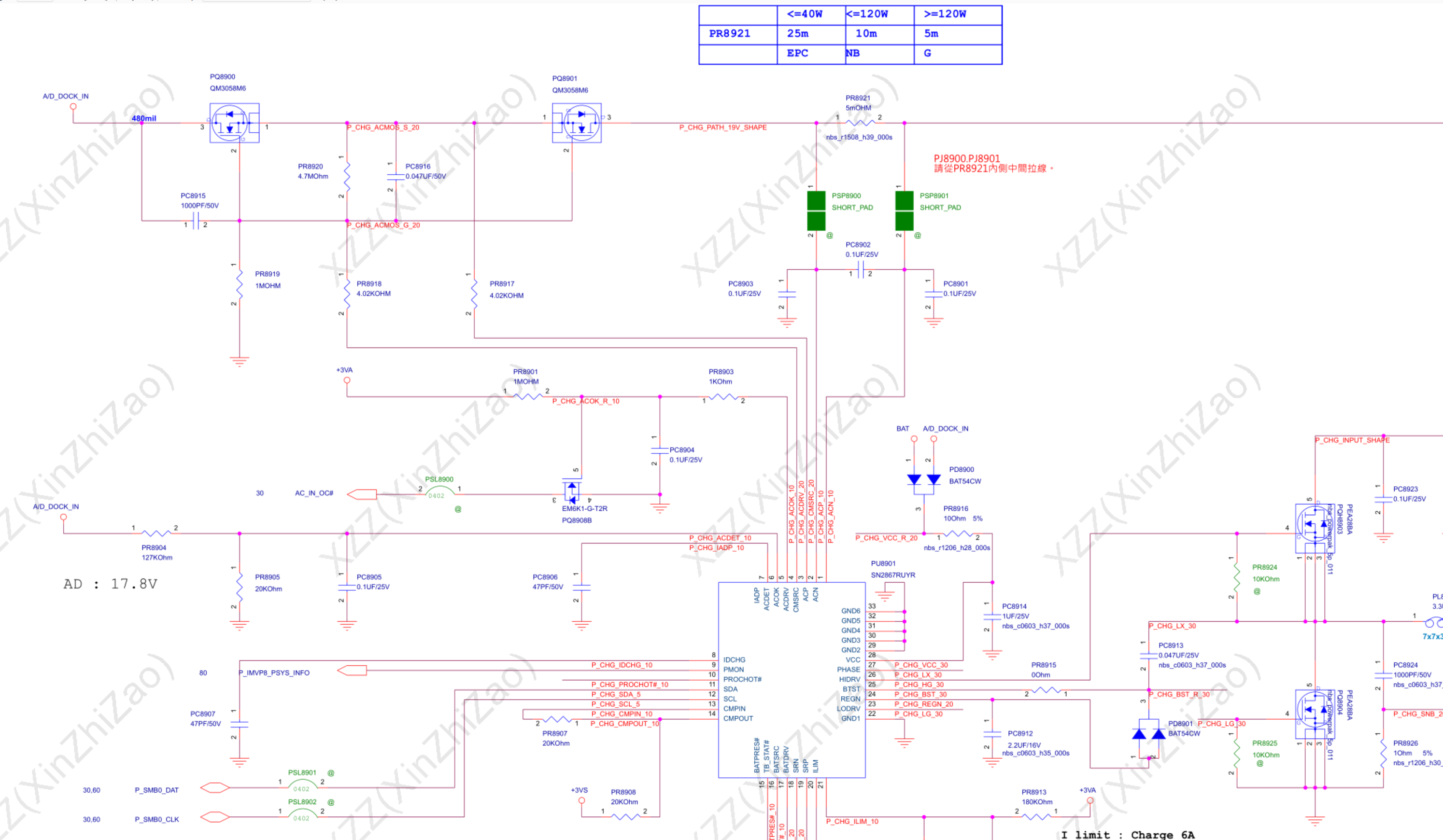

                See attached.
                Click image for larger version  Name:	dcin_mosfets.png Views:	0 Size:	671.3 KB ID:	3169547
                Click image for larger version  Name:	DCin_mosfets_bv.png Views:	0 Size:	3.04 MB ID:	3169548
                Remove all power. Meter in resistance mode.
                Measure the resistance across each of these mosfets as follows:
                source (1-2-3) & drain (5-6-7-8) ; these pins will be shorted on the board so pick anyone
                source (1-2-3) & gate (4)
                gate (4) & drain (5-6-7-8)
                Post each measurement for each mosfet. Likely one of the mosfets is defective / leaking. You are testing the mosfets PQ8900 and PQ8901 from the schematic.
