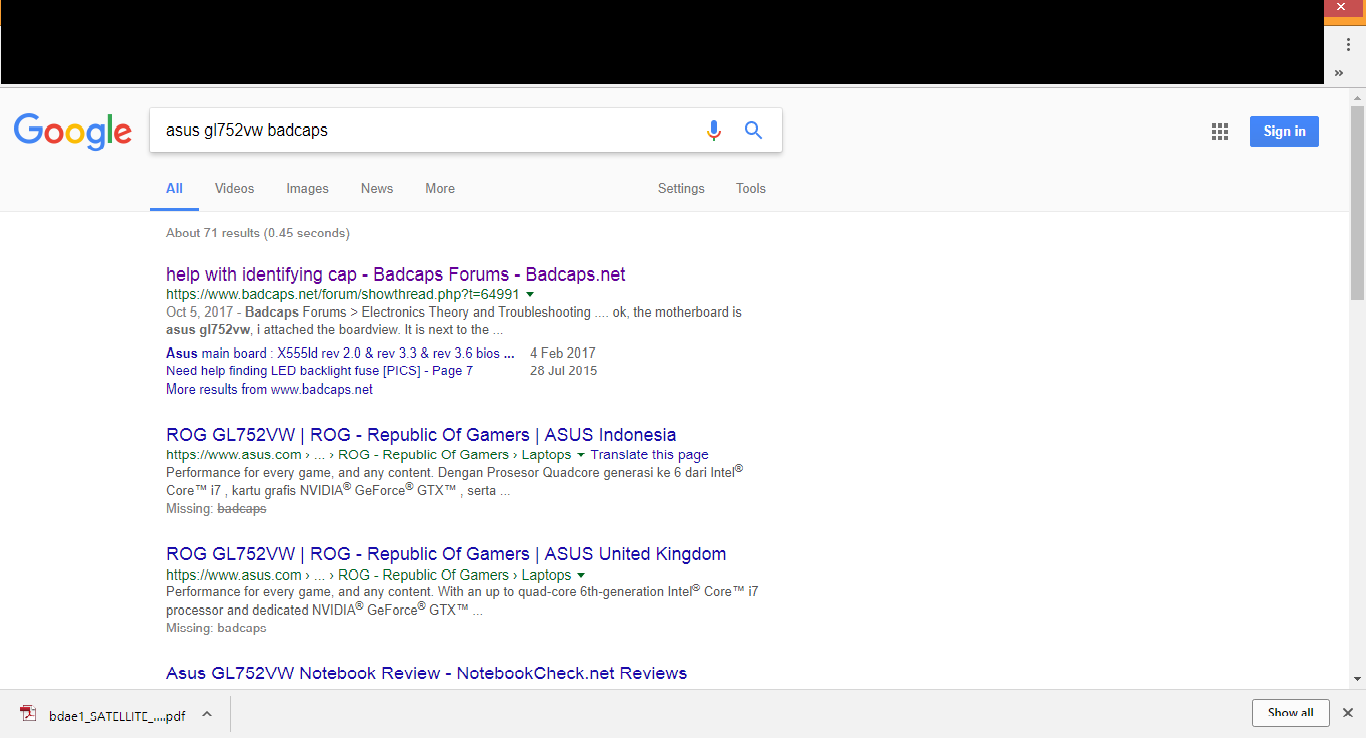

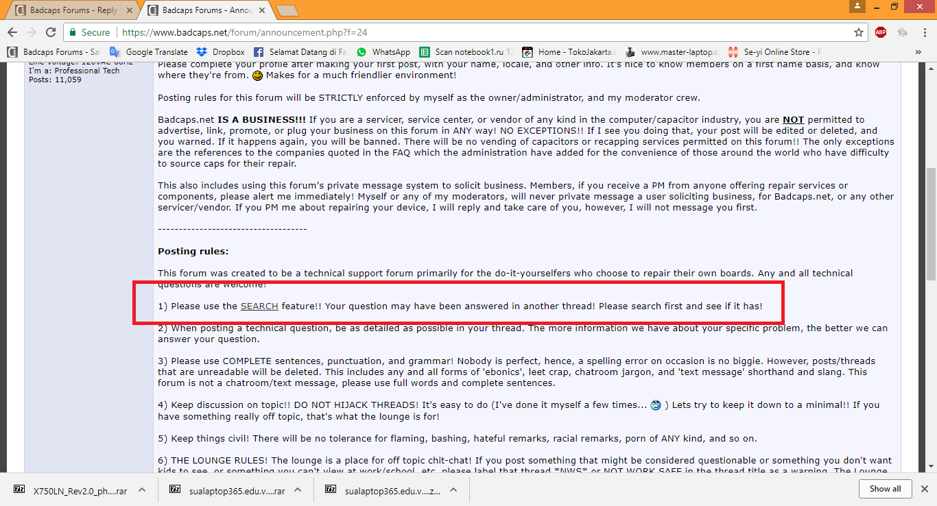

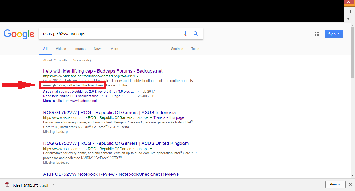

            Re: ASUS GL752VW REV 2.1 Schematic or BoardView plz
            Originally posted by jasko_jacker
            What is the problem ?
            - With Big respect to All people here, what I mean is show "how to search".
            Sometime I see someone with LOW effort.
            - With Big Thanks to owner BADCAPS.NET, to do little job save Storage of Server. In spirit to avoid double post.
            https://www.badcaps.net/forum/announcement.php?f=24
            https://www.badcaps.net/forum/showthread.php?p=777058
            https://www.badcaps.net/forum/showpo...1&postcount=10
            PS: Sorry, My English very bad to send message correctly and with very nice language.

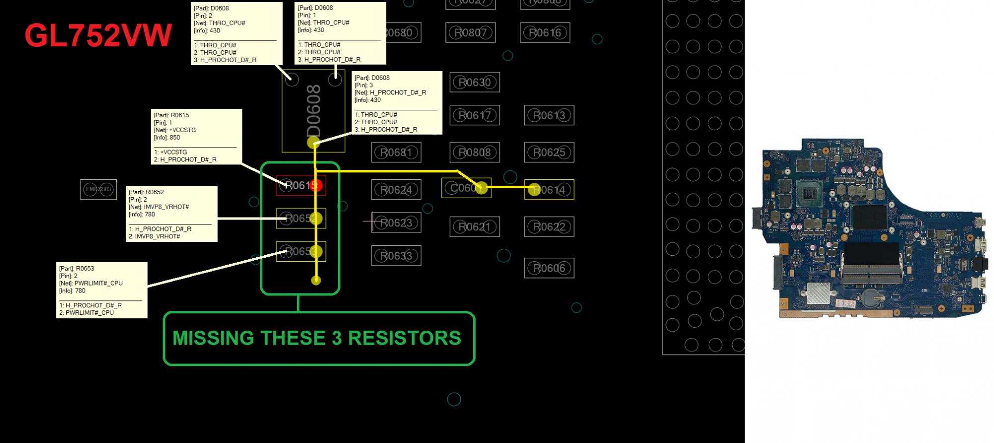

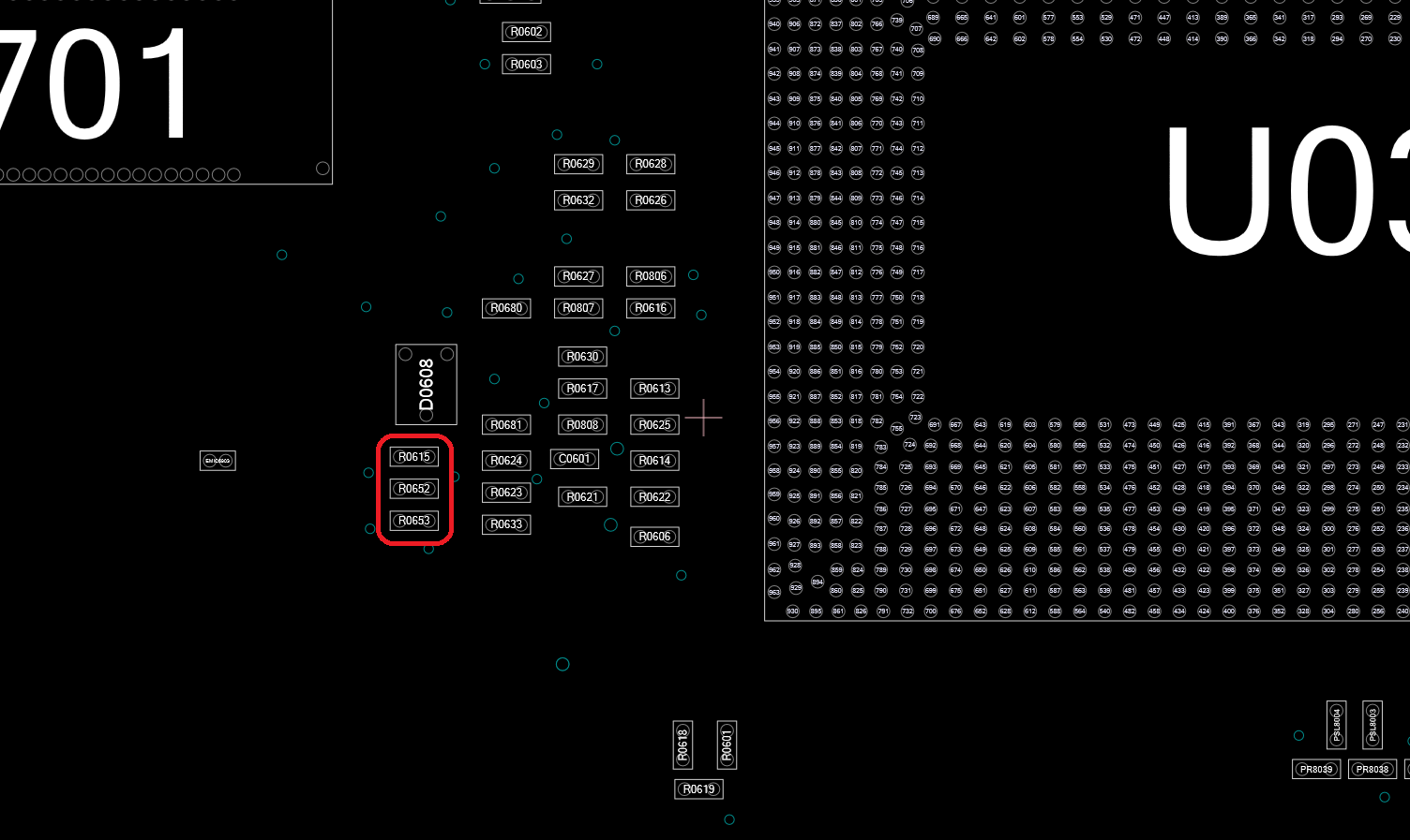

                          Hey guys,
                          i came across with this motherboard with 3x missing resistors,
                          can anyone help me identify R615, R652, R653,
                          i cannot find part list for this model
                          many thanks
                          • piernov
                            • Jan 2016
                            • 4439
                            • France

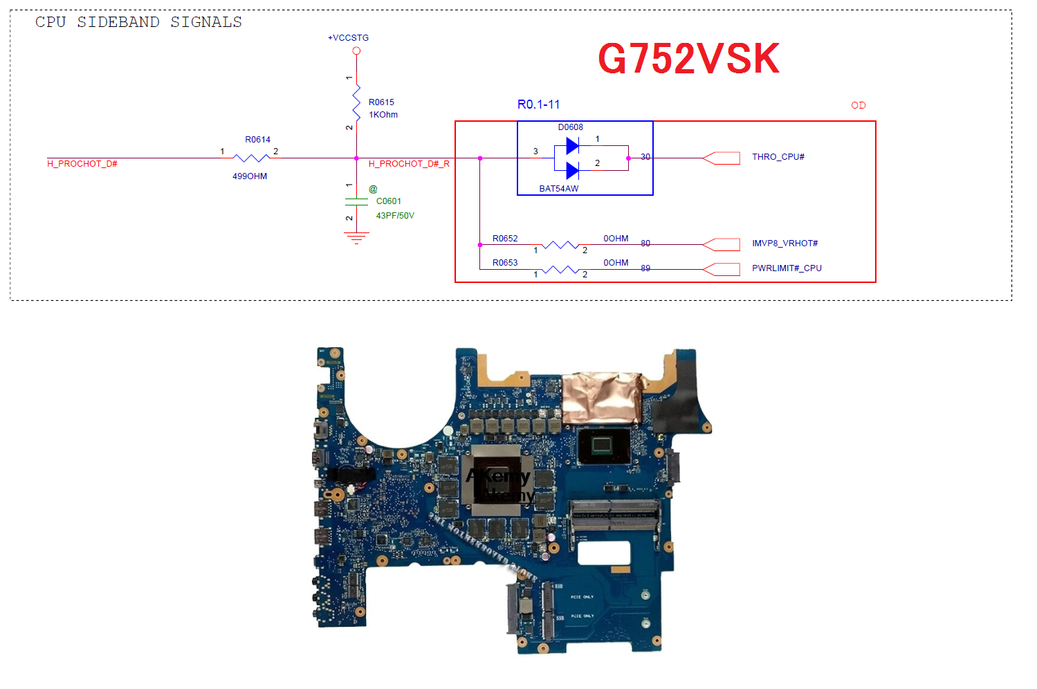

                            From https://www.badcaps.net/forum/showthread.php?t=83147
                            R0615 = 1k
                            R0652 = 0
                            R0653 = 0
                            • blue7512
                              • Apr 2013
                              • 6
                              • Portugal
                              R0615 = 1k
                              R0652 = 0
                              R0653 = 0
                              many thanks mate for you help,
                              but i need for GL752VW,
                              the one you send me is G752VSK an d motherboard is very different layout,
                              possible those componentes parts are not the same, but i will try compare
                              any chance to find GL752VW shematics with component part list ?
                              • blue7512
                                • Apr 2013
                                • 6
                                • Portugal
                                R0615 = 1k
                                R0652 = 0
                                R0653 = 0
                                Fantastic mate, i have compared schematics and i think 99% components can be the same value, i will give a try now, will give feedback latter
